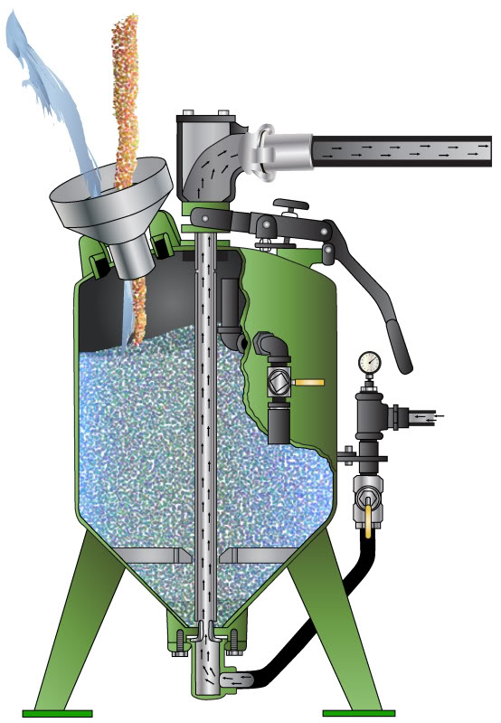

    I have just about everything I need to build one all I need to know is, If anyone out there has a DB150 can you measure the pipe coming out the top for me please, no need to take it apart just where it slides at the top. Thanks

    Mine is 100 miles away from me....can't measure anything.

    Ilooked up that diy couldn't bring it up why
  28. 2tommy
    Joined: Nov 6, 2013
    Posts: 3
    2tommy
    from ca
    I found that parts page of the db 150 I can't figure out how that pipe raises up and down without leaking air

    Hey TXTurbo...Is there any way you can look inside your Dustless Blaster and see how the plate is made in the bottom cone inside the machine.I'm pretty sure its a media catcher so all the sand doesn't pile up in the bottom of the machine.I guess the ******** helps shake it to the bottom.
    I posted a pic and circled the part i'm talking about.
