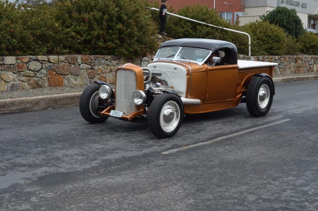

    Heres mine made it up using a 1950 chev pickup roof. Gutters remain and help keep the rain out.

    Great but how did you attach it to the screen please

    Mark mine doesent actually attach to the screen. I have a stainless turnbuckle that pulls it down onto the dash top rail in the middle of the screen. So it only puts a light pressure on the screen, no bracket of fiittings are attached to the screen. I will take another pic tomorrow.

    Here are some inside shots showing how i did the attachment. It just works
