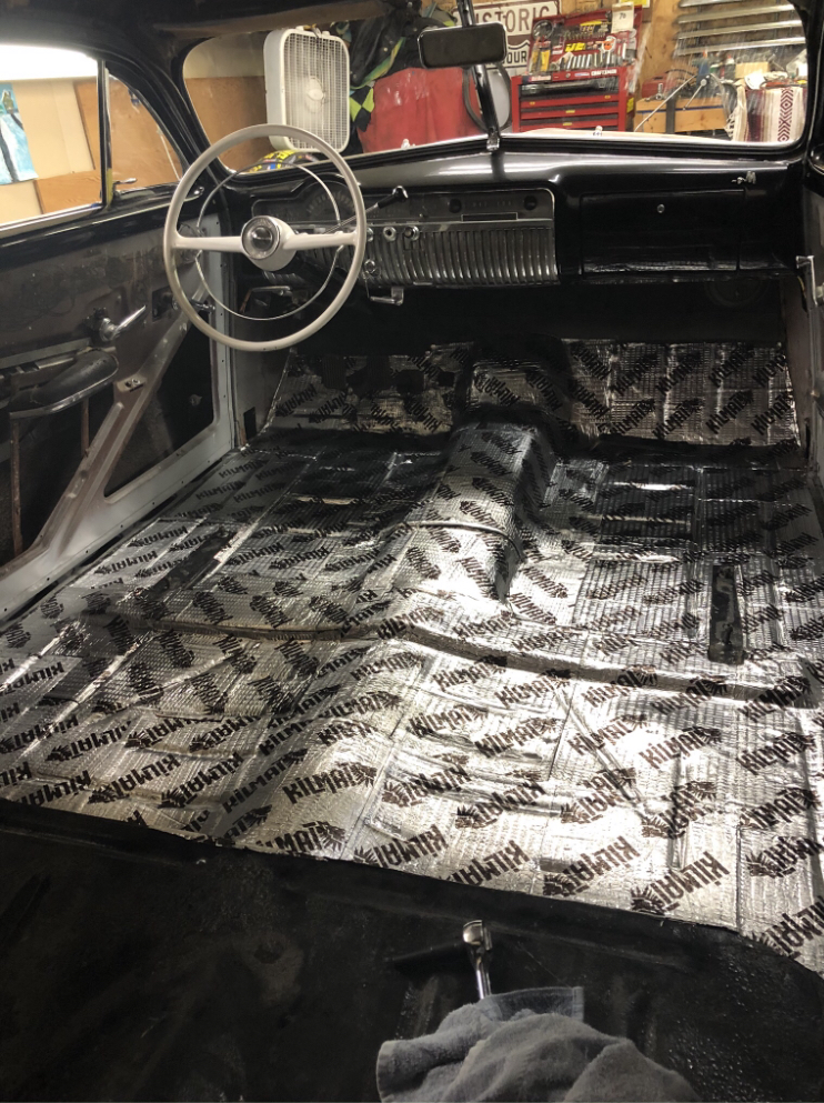

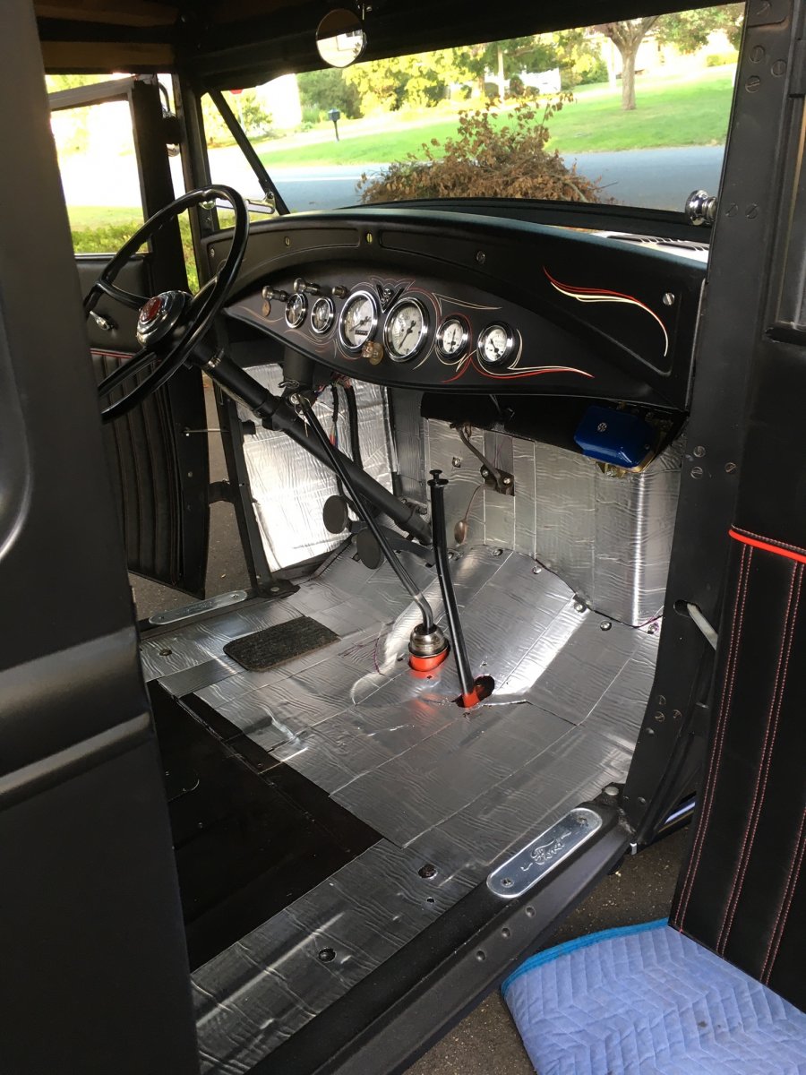

    8C7FD9C4-6C85-4A48-A07C-F11589D3C1E3.jpeg F4436FD2-144C-4E81-ABF1-16C6E7AC2928.jpeg I used the Kilmat in my 51 Merc. I would definitely recommend it.

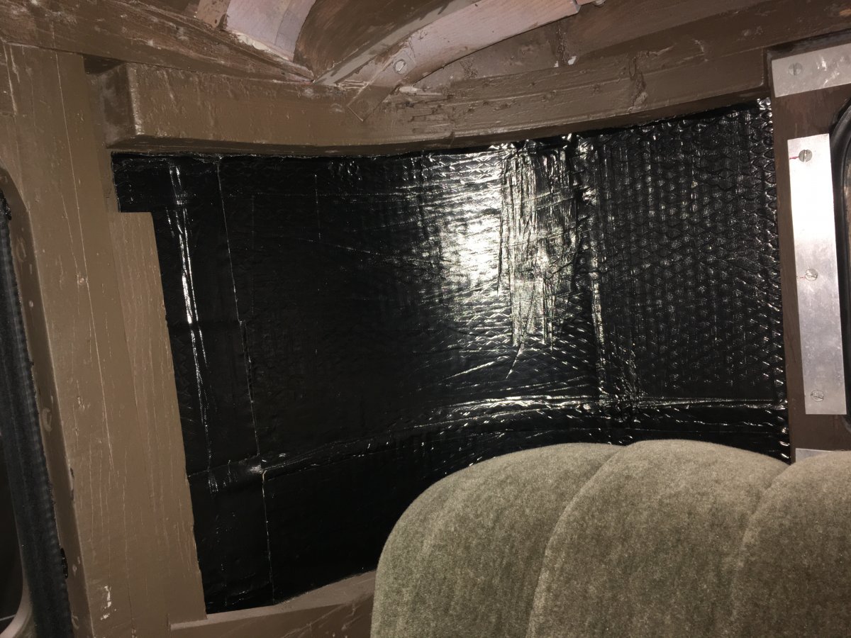

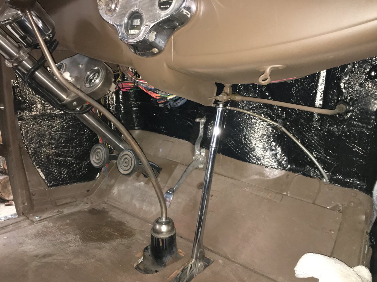

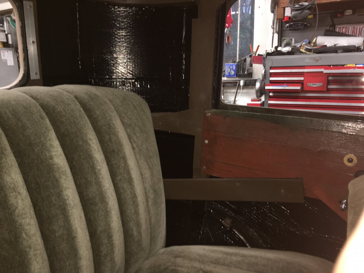

    I used Noico in my ‘30 Victoria. Did everything I could get to and as I remember it took less than 2boxes. Each box was 36 square feet and cost about $68 a box. I used the black color as I figured I wouldn’t complete the interior for a while and didn’t want to look at all that silver. Reasonably priced. REALLY deadened the sound. Very happy with it so far.
