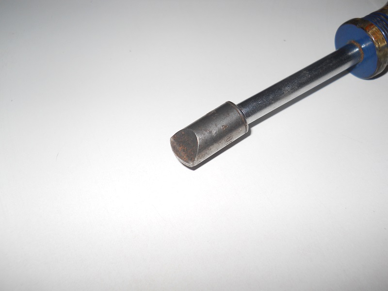

    I made this tool for the race car. We had many places that had mismatched panels and the springs for retaining the fasteners needed adjustment. You place the end of the tool through the hole and twist it to attach to the spring. Then you can pull out or push in to bend the spring for the right amount of tension on the fastener.

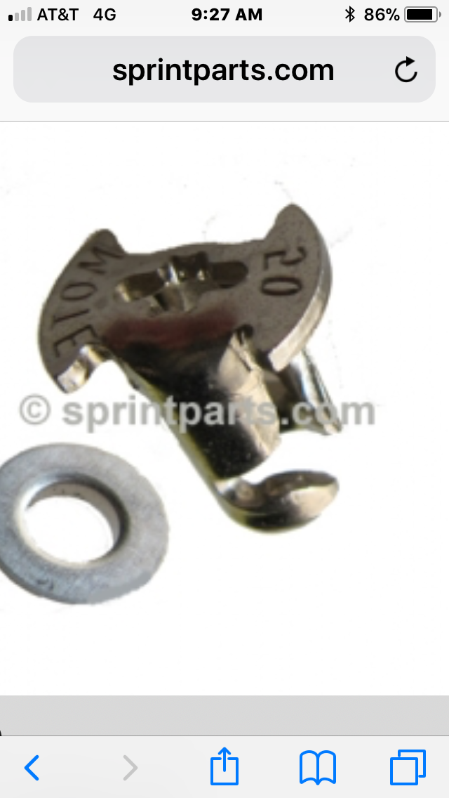

    We switched to a variation called Mote fasteners comparable in weight but made out of Chromoly and can use a flat screwdriver or torx and won’t slip or strip the heads.
