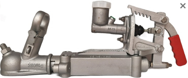

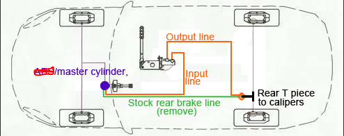

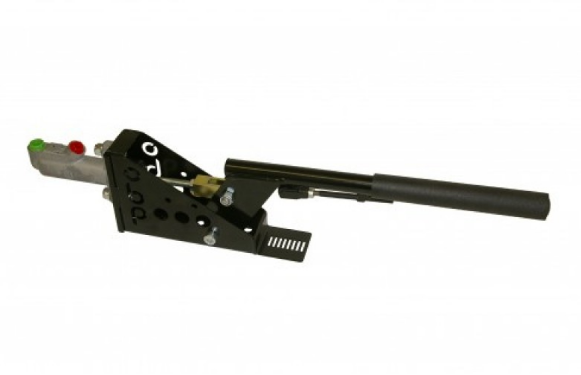

    Why don't you make a "Fly-off" style hydraulic handbrake like used in competition rally cars.
    All you need is a single m/c with remote reservoirs and you plumb it inline.
    In the relaxed position the hydraulic fluid flows through as if there was no m/c at all.
    When you pull the handbrake the M/C blocks off the lines upstream and it works like a normal handbrake.
    VANDENPLAS, mgtstumpy and Kiwi 4d like this.

    What a load of absolute bullshit!!
    If you risk gradual loss of hydraulic pressure when parked, then those components don't belong on the vehicle in the first place.
    We use hydraulic handbrakes on trailers [a mechanical ratchet overriding hydraulic surge brakes]
    On my last trailer I left it parked for over 12 months with the handbrake pulled up and there was no loss of fluid anywhere.
    One Caveat here...... I packed the M/C with rubber grease to protect the cylinder walls from the exposed atmosphere because I live near the ocean.
    @aircoup The term "fly-off" is actually misleading , that's why I said "Fly-off Style" [Fly-off refers to the removal of the ratchet mechanism for rally cars, but the hydraulic handbrakes still work the same]
    We [in NZ] don't use the term "ebrake" but use "handbrake or parking brake" instead.
    A true "emergency brake" is the actual dual brake system
    [either tandem or dual M/C's] for safety I always recommend using a dual system.
    The hydraulic handbrake does not affect the Fr/Rr brake bias in any way.
    If you want to go really simple [for temporary parking] you could simply add a switch activated "line-lock" solenoid into the brake circuits .[this would require initial pedal pressure, and could drain the battery]
    But the hydraulic handbrake can be used in a moving situation [stunt driving :D]
    You can mount the inline M/C anywhere , eg: on the frame underneath And use a lever with a conventional handbrake and cable.
    This would prevent having an ugly handbrake with a nice interior [depending on the theme of your car]

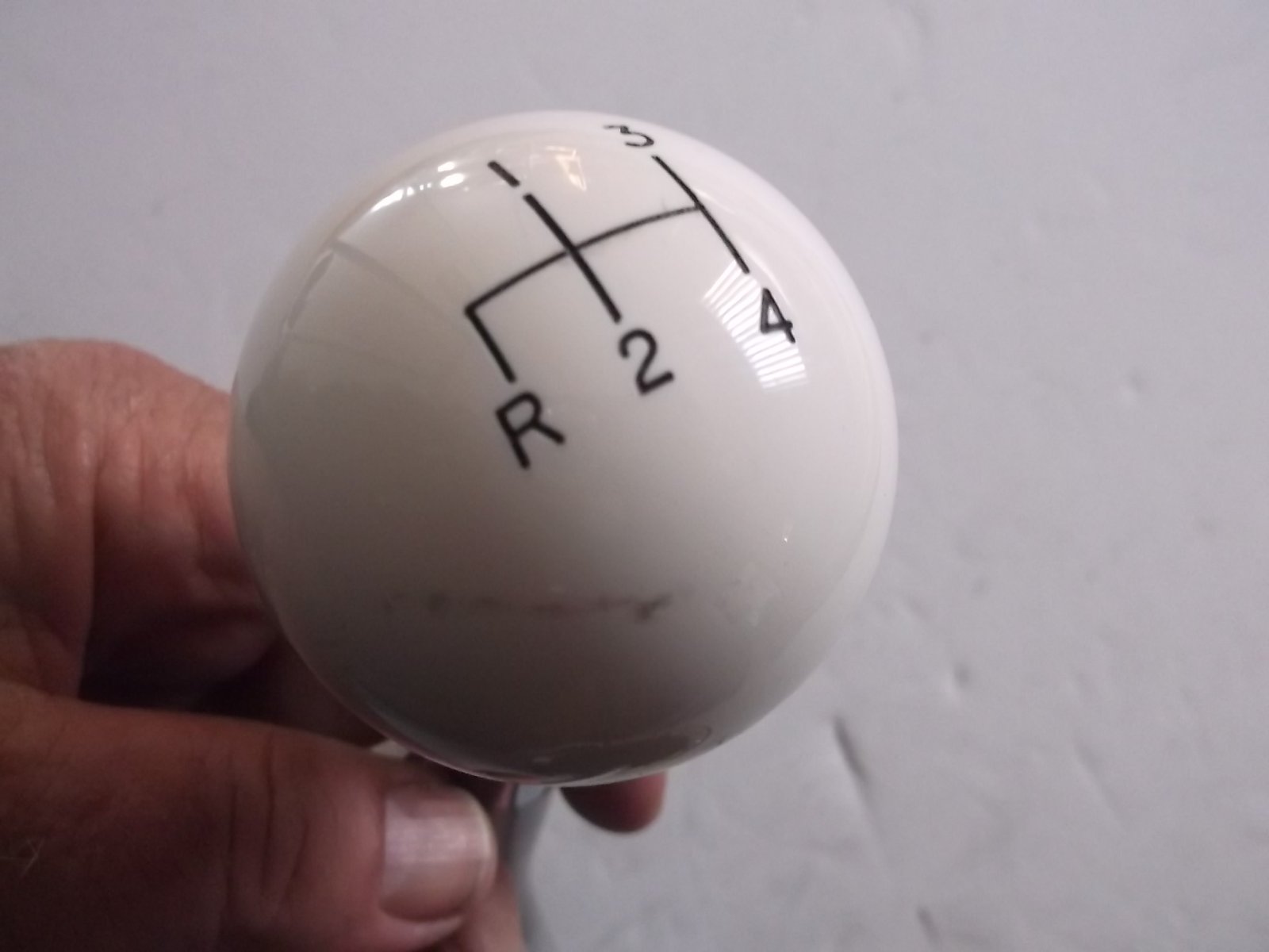

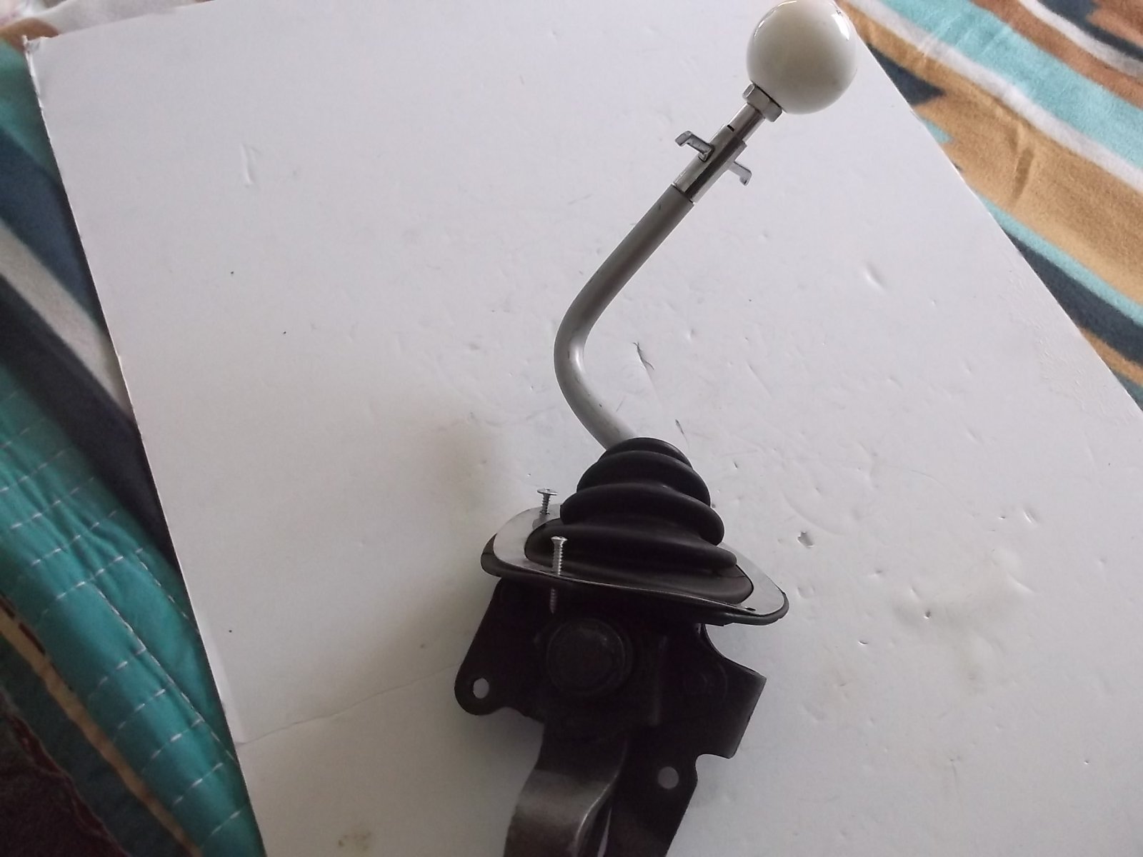

  20. Malcolm Elvy
    Joined: Apr 28, 2021
    Posts: 92
    Malcolm Elvy

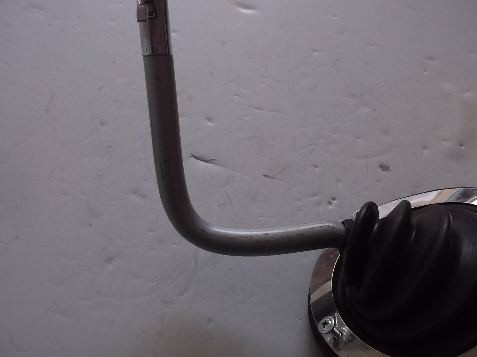

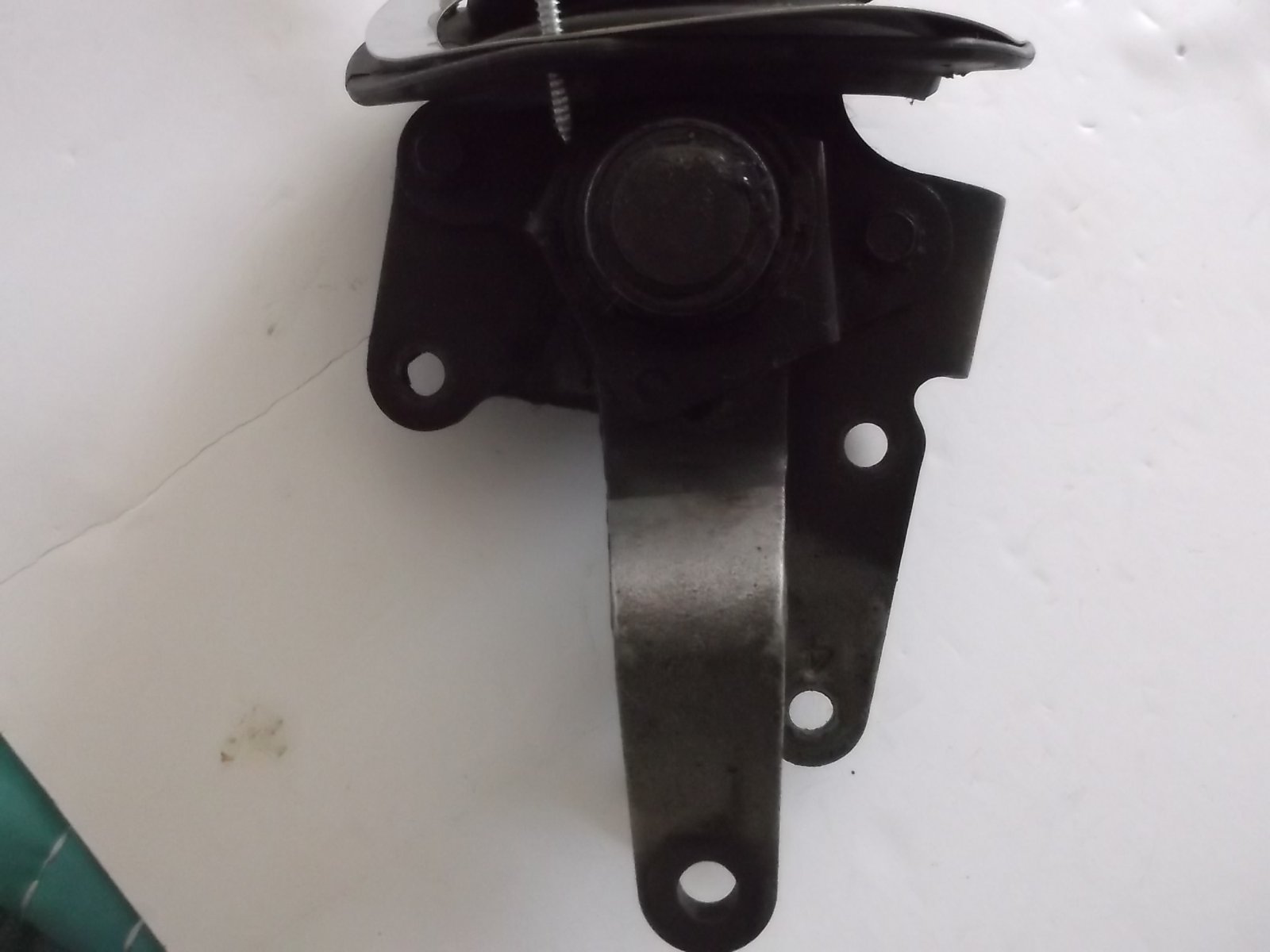

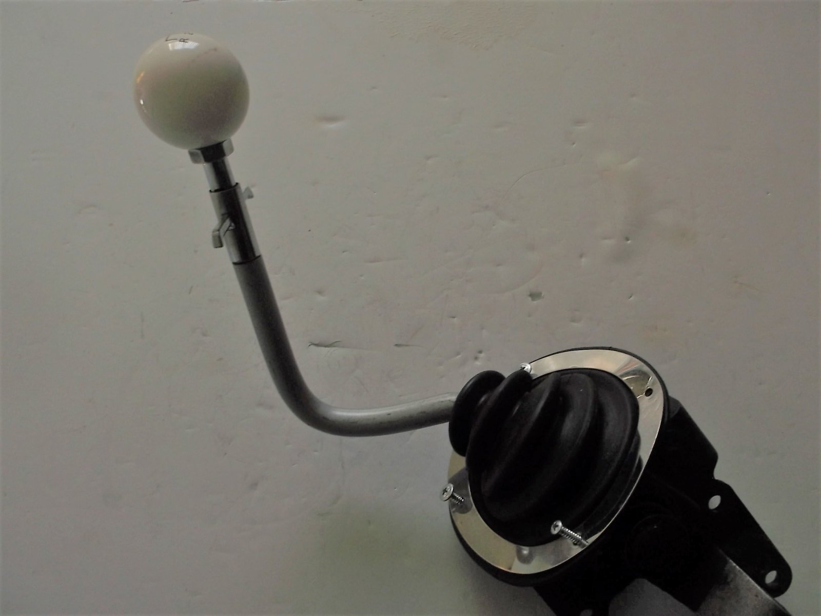

    Can anyone ID this shifter for me? It has the Ford reverse lockout.....for a car with no console? It seems to have too tight of a curve in it for a bench seat car? ....Thanks for any help....
