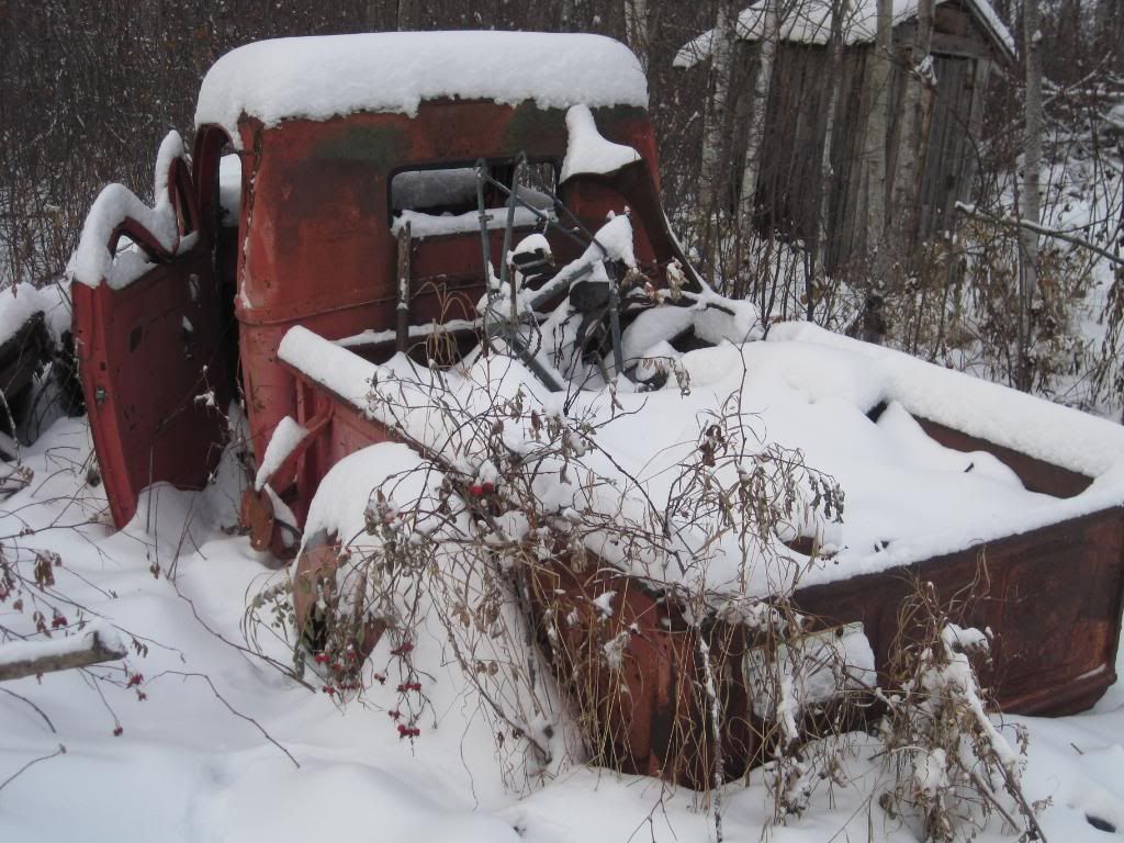

    Here's the truck I'll be pulling some parts from - been sitting in the in-laws farm field for 40-some years....
  3. thunderbirdesq
    Joined: Feb 15, 2006
    Posts: 7,091
    thunderbirdesq
    Looks like you've got yourself a 1932 heavy axle there!
  4. e-tek
    Joined: Dec 19, 2007
    Posts: 424
    e-tek
    from SK, Canada
    So I hear! Got lucky on that one.
