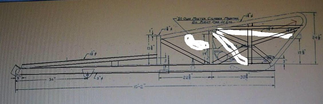

  8. From a old drawing from the 60s I re-did this. Kind of where I am thinking as I begin the new build.

    One thing I learned on our HA/GR is the cage design does not allow any portion of you helmet to get through and be able to make contact anything. Maybe a couple of bars over your head would help, contact your divional tech or at least the track your running I really do like that style of ch***is but I doubt NHRA/Famoso would allow it.:(

    A drawing with a little more thought involved.............
    Man I hate that big old cage but O well, maybe I can lay the driver down more or build another car I can't fit in :D, maybe a "dove tail" chute pack body...........na!

    are you going to do a detailed build up on the frame here?
  21. Toymaker
    Joined: Mar 26, 2006
    Posts: 3,924
    Toymaker
    from Fresno,CA
    Yes John, I going post it all and maybe someone will stop me from making a mistake:D
