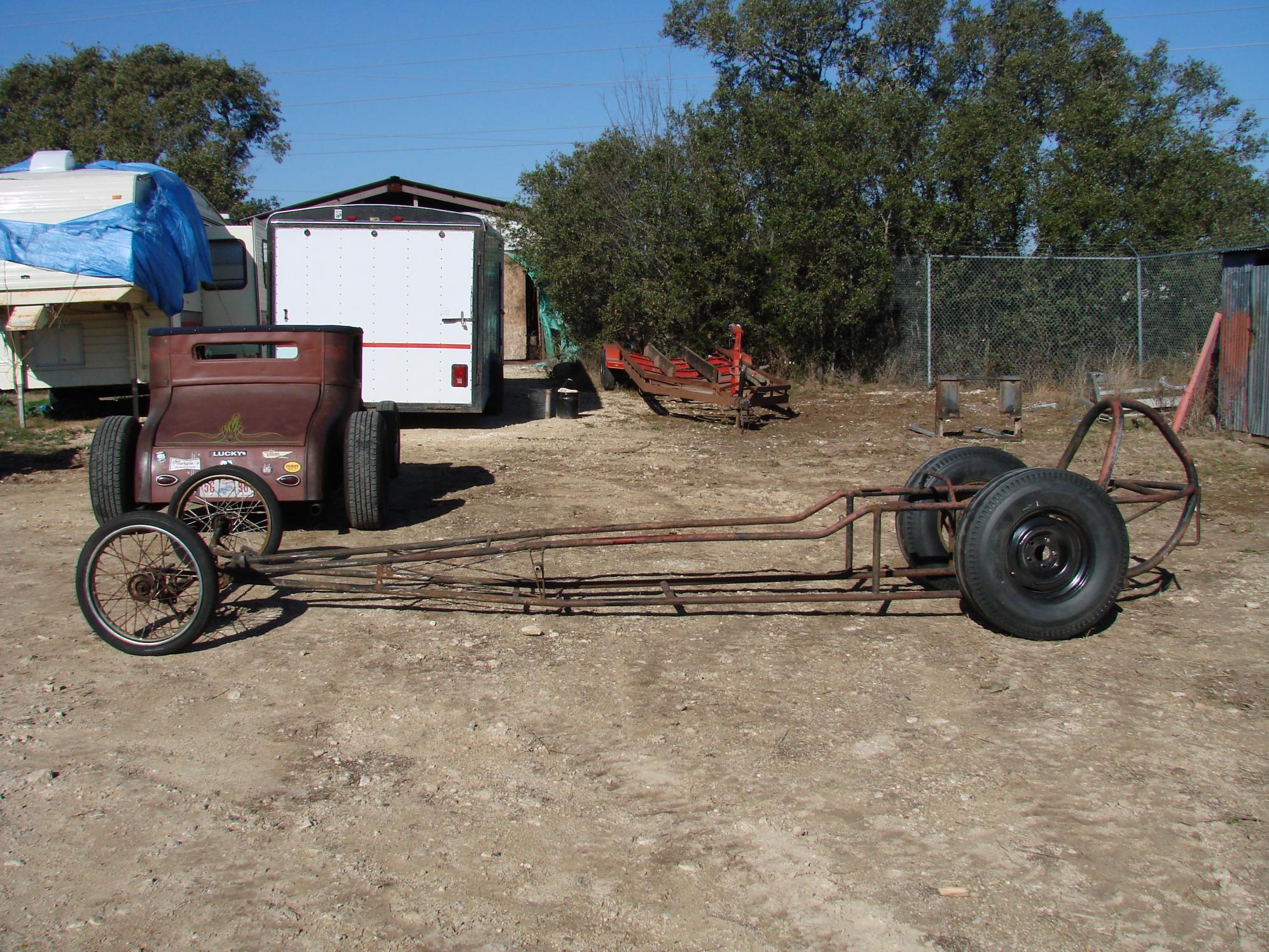

    This is great. Just got an old roller and I'm ready to build. Anyone know what ch***is this is?

    from Dallas TX.
    Bill:
    It dosn't matter much who built your ch***is. It's a poor design and it will KILL you. There is a reason why dragster ch***is' evolved into the bridge truss or airframe type design. The truss will handle a lot of abuse and live for a long time.
    A ch***is with a legal roll cage attached to 2x3 tube that is not trussed WILL bend at the conecting point. The said legal cage is not realy legal as the SFI requirments state that the top and bottom tubes must extend past the motor plate upright by 2 or 3 inches.(see attached shot)
    In the past these frames were made out of ever decreasing tube thickness, like .025" or .035", this was called O TO THIN. a lot of cars were .049, these cars would last about one or one and a half seasons. A good standard tube size is .058", with .058" a tube one smaller size will slip in side for a splice joint. So a car can have 1-1/2" sholder hoops and be spliced down to 1-3/8" then to 1-1/4" for the top rail to run all the way out to the torsion crossmember.
    It's my beleaf that it would be ok to go to .065" tube for the front rails. but any thicker would be to stiff. I say too stiff as in the old days of the Ch***is Resurch cars, in an accident the car would vaylt and flip all as unit. This would beat the driver up and Kill him some times with out much out side trauma. The Fuller - Stucky design will usualy seperate at the firewall and decrease the rotating m*** causing less damage to the driver.
    A case in point is the Jim Nicole crash at Indy in 1969. His clutch cut the car in half and he went over the guard rail in cage and with rear end and tires. all this did not go very far and Jim got up and walked away.
    Just my opinion, dwrfab Don Ross

    Just so happens I looked at your work online yesterday, very nice. It's great what your doing with these old racecars. My plan for this car ( before you told me I was going get killed ) was to add bars to complete triangle trusses as needed and to check and repair all welds etc. I blasted the frame today and it's in great shape and only needs small repairs. I've been wanting a car to run once a year at Little River with a 283 and just have something cool around the shop. I value your opinion on these cars, you know much more about them than I do. We all like the old stuff, do you think with some good supports and a 283 this could be a fun and safe car? Thanks for your advice, Bill

    Bill:
    Nobody knows what it is made of, mild steel or molly. The cars I have repaired were all rusting from the inside out. One of the major problems with what I saw as you posted it is the cage , It's just an unknown.
    dwrfab Don Ross

    It's mild steel, the cage also needs to be updated to 5 point and have some kidney bars installed. This frame doesn't appear to be rusted, I think it been in cen/tx mainly. How did you repair the rusted ones you worked on?

  20. dwrfab
    Joined: May 21, 2006
    Posts: 407
    dwrfab
    from Dallas TX.
    Bill:
    New tubing, thats all that will set your mind at ease.
    dwrfab Don Ross

    Don, I here ya. So do you think any of the old fed ch***is are safe? How do you tell if ones good? Should they all be replaced and parts moved to a new ch***is? Thanks for your input on this, Bill ( I'm not afraid to ask when I don't know )

    Bill:
    Thats a hard question to answer. safe is a relative term. If a car is to be used as a cackle car I still remove any damaged tubes. If the main rails are warped and ground on the bottom, the car should be front halved with new tubing. Usually when some tubes need replacing an inspection of the inside can be done. The ch***is on the Scorpion V is only 30% original tubing. I got some new sholder and **** tubes from Garlits. Only one main tube in the clutch bay is original. It also has kidney bars behind the wrap around body in case the push truck should get off to the side and hit the body. When I replaced the front tubes I saved the uprights and diagonals. These were hard to weld back to the new .058" rails as they had become thinner with rust.
    By rebuilding these old cars Im putting my head on the block. The owners tell me thay will not make runs with the cars. No amout of wavers will protect me. So yes my best advice is use new tubes and approved safty designs.
    Sorry for hijackig this thread,
    dwrfab Don Ross
