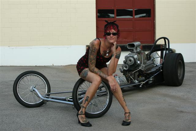

    Ok, we were at another thread and someone wanted pics of our ch***is. Rather than step on the other guys thread, we decided to step on yours Rocky.:D This shot shows the axle, and the boomerang steering. I'll look for a closer view too. [​IMG]

    Been there. Feel helpless when your strapped in and the wheels flop over. The steering isnt strong enuff and or is too springy to overcome this. That is why you will need a attentive crew member to help in a situation like this.

    Oh and lippy, your front axle is dreamy!

    I'm here to shout.LOL You damn sure don't want your hands "IN" the wheel when that wobble **** starts!:eek:
    My right elbow still pains me at times lo these 9ish years since I got caught with my hand in the wheel.:eek:

    Yeah it hurts big time.:( Another trick if no one shows up to grab a front wheel is to put it back in forward gear and let it roll forward, the wheels will straighten right up. Put her back in reverse and continue......:D Slowly.

    I've only got around 10 degrees in my HA/GR and you better not try and back it up real fast!!

    Our car was a 67 SPE car 165 in W.B. originally. Lippy
