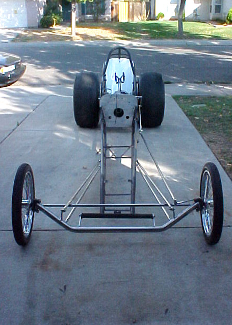

    Here is another steering arm picture
  2. Nice front end! Is it chrome or Jet Hot? I want to chrome mine but was told it wouldn't p*** tech although I see so many that are. :rolleyes:

    Instead of twisting the arm I've fitted it to be welded level. Thanks for the input your knowledge is always welcomed. Rocky

    Polished Raw 4130 Chrome Moly, the whole front end ***embly, tubes and arms. After all the welding was done, I wire wheeled all the welds. Using a medium and fine Scotch Brite wheel, I polished it all. The arms were grained on a belt sander with 220 grit belt and then polished on the Scotch Brite wheels. While watching Nascar races, I blended any spots with a grey Scotch Brite pad and then a white pad. Last but not least, Semi Chrome Polish.
  6. That sounds like a good idea! I can do it myself and not have anyone jump me about hydrogen embrittlement. :D Anything on it to maintain the shine? Or do you just keep up the work?

    Right now I just keep them clean and use the Grey Scotch Brite Fine Pad and Semi Chrome. I have considered on having them Clear Powder Coated.

    Well after a great event at Eagle Field and catching up at work and home I got after the Dragster build this weekend. Started out Sat. with a friend coming by and straighting out the shop then I started with remounting the steering column.
    A little hesitant to weld in the x-member for the anti-rotation bracket I did some practicing and went for it.
    I was about to start cutting on the cage when I decided to "Sleep on it". The car will not see a 1/4 mile track let alone an NHRA track as long as I own it, only racing it at Eagle Field and don't plan on doing any updates so I'm really considering going back to a 3 pt like similar to the one the car was built with.
    NOW
    PHOTO SHOP
    With this done I can put the original interior back in.
    I like the car but to make it NHRA Legal will require basically a new ch***is. Eagle Field is only 1/8 mile and the car might do 100 MPH so I'll run this car until I can build or buy a "Legal" ch***is and maybe use the parts off this car and hang the ch***is in the rafters until someone comes along looking for a Bergler Bodied Logghe ch***is. Rocky
