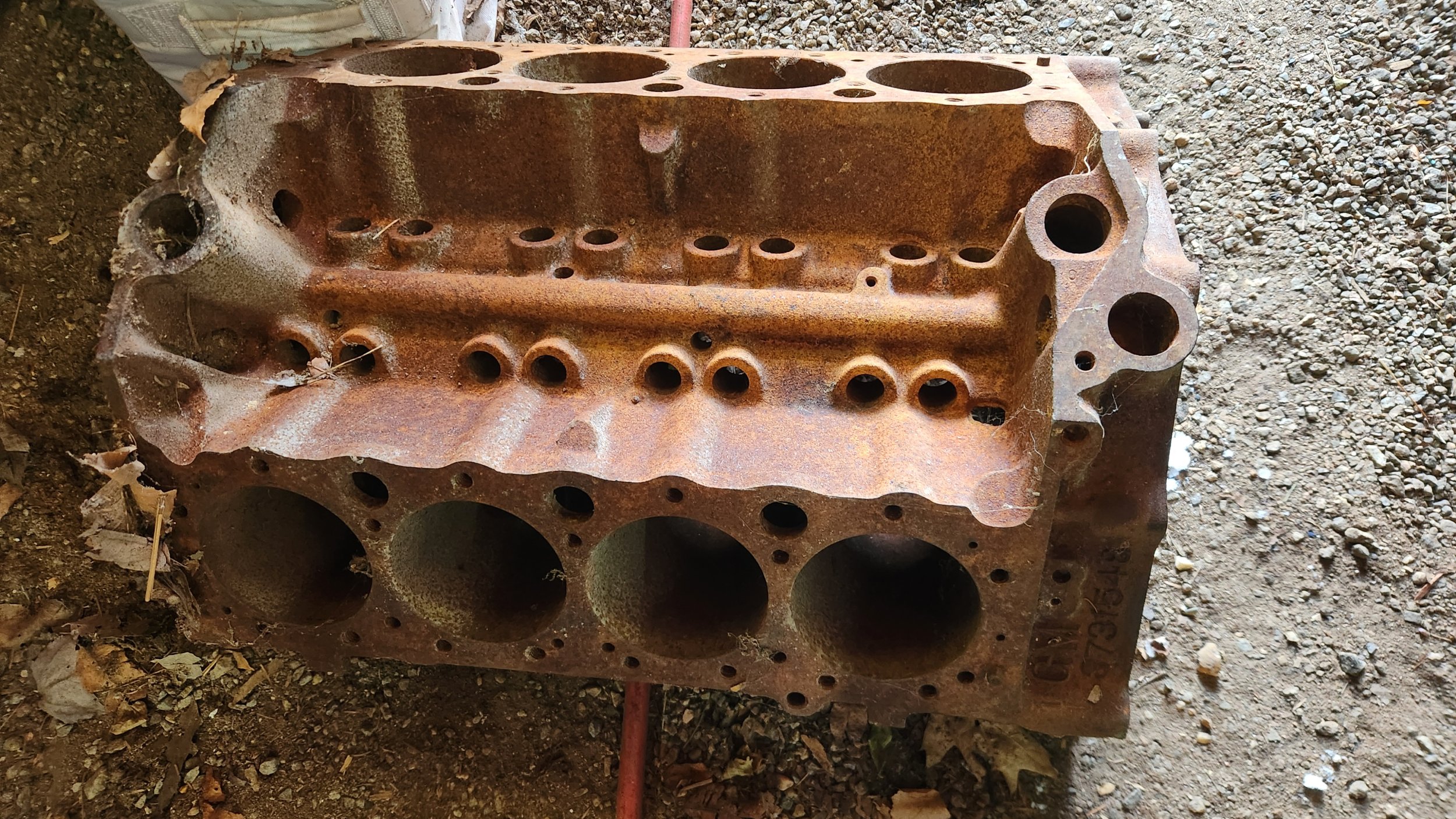

    I have a bare '57 block. Not sure if it's a 265 or 283.
    Sharpone likes this.

  19. NoSurf
    Joined: Jul 26, 2002
    Posts: 5,069
    NoSurf
    Terrible pic, but I'd say 3-7/8". My calipers are at work.
    I didn't burn an inch....

    when you need to determine the amount of over bore, you have to start measuring at an inch line, instead of at Zero on the tape measure...then you can measure to within .01" accuracy, if you take your time.
    Yup, looks like a 283, not a 265. Congrats.
