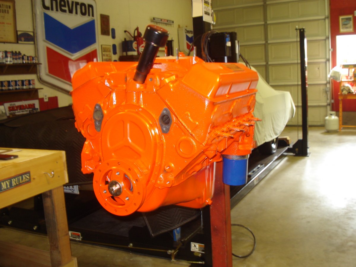

  15. Oilguy
    Joined: Jun 28, 2011
    Posts: 663
    Oilguy

    Looks like Chicago Corvette might be the way to go, and they are local for me, only an hour away and open on Sat.
    Thank You
