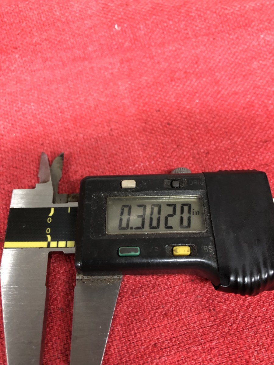

    I just checked two shafts that I have and both are recessed down in the gear about.300,,or so.
    That being said,,,the distributor shaft is supposed to sit in the cavity at the top of the gear.
    It helps to control it at RPM,,and keep it from wondering around.
    Now,,,I have been checking and a 318 distributor is about .400 shorter than a 331 Chrysler,,,at least from the info I have .
    I just measured a 5.2 distributor I have and it is about.300 shorter than my Desoto distributor,,,and a 331 is supposed to be .100 longer than the Desoto,,,,approximately.
    I took a few pics,,just for reference .

  4. If you look at the distributor pic where the tang is,,,look at the discolored part near the bottom.
    That was sitting inside the gear top opening,,,very close to .300 or thereabouts.

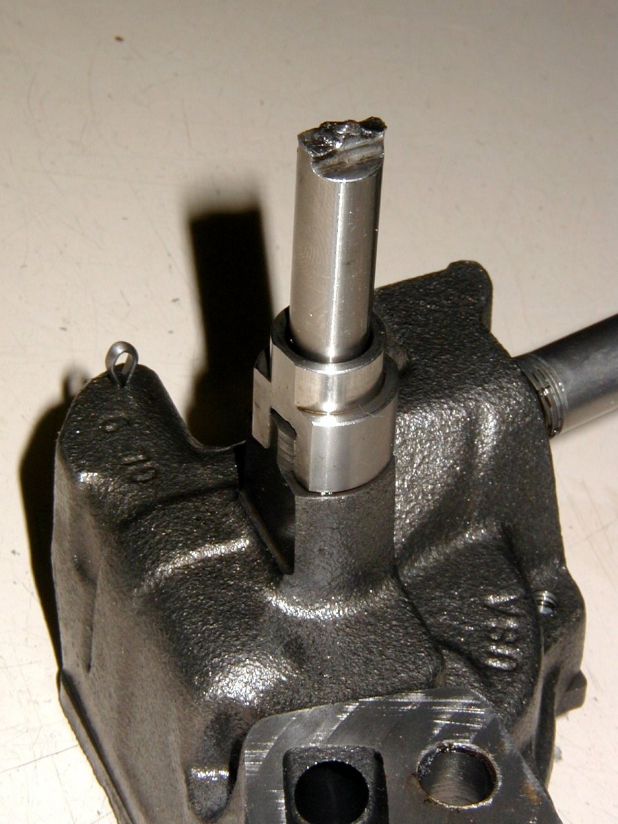

    The end of the shaft in this picture is blurry, but it looks like the piece it drives has come close to popping out and made a round dent in the metal:

    Hey Tommy, The shaft I have is the " Longer Intermediate Shaft" by HotHeads it is suppose to stick up outa the gear by about 0.100" to use the 318 distributor. but it still seems to short
    Yes exactly, end is all torn up. that pic is also AFTER i took it to the bench grinder to take the burrs ... it was worse

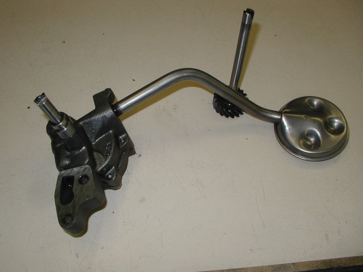

    Hey! thanks for the reply: long story short its a 318 dist .... longer shaft by HotHeads ... and the new style 340 oil pump.
    - my oil pressure dropped to 0 psi suddenly during initial tune
    - after measuring the the "Stack" of parts:
    -- The distributor is only engaging the top of the intermediate by approx 0.050"-0.100"
    -- The oil oil pump is only engaging by about 0.100"
    The bottom of the intermediate shaft got torn up. so now I'm adjusting the shafts positions to engage the distributor and oil pump properly.

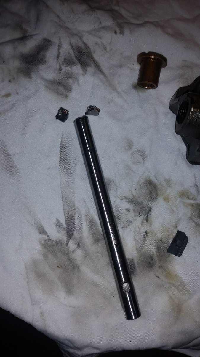

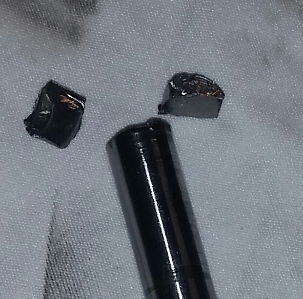

  13. this is the Hot heads intermediate shaft...
    and I later found the oil pump shaft was bent, I'm assuming it bent when the intermediate shaft ears sheared...

  14. when I called Eric back initially all I wanted to do was inform him that I had a component failure and that he should look into it as possible batch of shafts that were not hardneed correctly. He did say he would press in a new oil pump shaft for me at no cost. when I got the oil pump shaft back he left me a note on the reciept. I ended up just turning out a new shaft of the same dimensions as the replacement and pressing it into place.
    LukesMotorShop likes this.

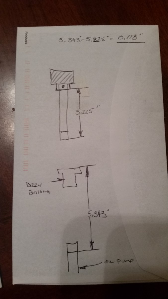

  15. So what I found was that the oil pump shaft and intermediate shaft only had roughly 0.118 interface (the original hot heads shaft). To me that's just not enough when my oil pressure is at 75psi. I ended up taking a stock 354 intermediate shaft, pressing off the old gear and pressing on a new coated gear for the roller cam.
    You’ll have to basically measure what the dimension is from the top of the dizzy bushing down to the oil pump shaft at the top (plus where its been machined to interface with the intermediate shaft) when its installed (i got 5.343). take the difference of the intermediate shaft and the measurement from the bottom of the drive gear down to the oil pump shaft (i got 5.225) and mill the difference off the Hot Heads oil pump adapter (i cut 0.110 off) with a few thou for play. this gave me near 0.240 of engagement. I used a new dizzy bushing installed when I took all measements. This was my problem.... HH oil pump adapter. Your measurements will more than likely be a little different due to block machining tolerances and the overall thickness of the dizzy bushing flange.
    I have over 8 thousand hard driven miles and no problems since and I routinely spin it to 7k. next time I build a hemi I'll probably make my own shit and save myself the hasstle, time, and money.

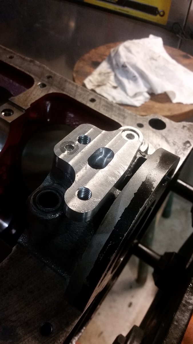

    After all the measuring and investigating what could have caused all of this it turned out for me to be the oil pump adapter was to thick. Solution was to clamp it down already bolted up to the rear main cap and take a few passes off.

  16. I jotted this down for measuring reference points. I saw what you had for measurements and they differ from what i have. I’m sure there will be some critics as to what i posted but this is what happened and what i found and what i did to resolve the issue.

    I played around with milling it down also. but i don' have mill or surface grinder I figured it was easier to play with the shafts than the milling option.
    Also; milling wouldn't have helped with the distributor engagement.
    Thanks for your drawing! I can see a bit of difference but same idea ... I'm triple measuring before and after each step to make sure!!
