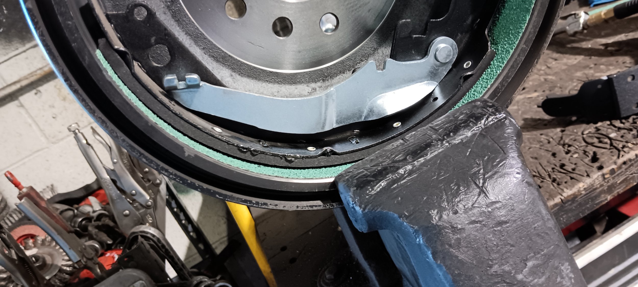

    I recently had to arc the shoes on a brand new nine inch ford because they were only wearing at the top of the shoe. I did it with stick on 36 grit sandpaper. 20250221_140304.jpg 20250221_140645.jpg 20250221_140307.jpg
