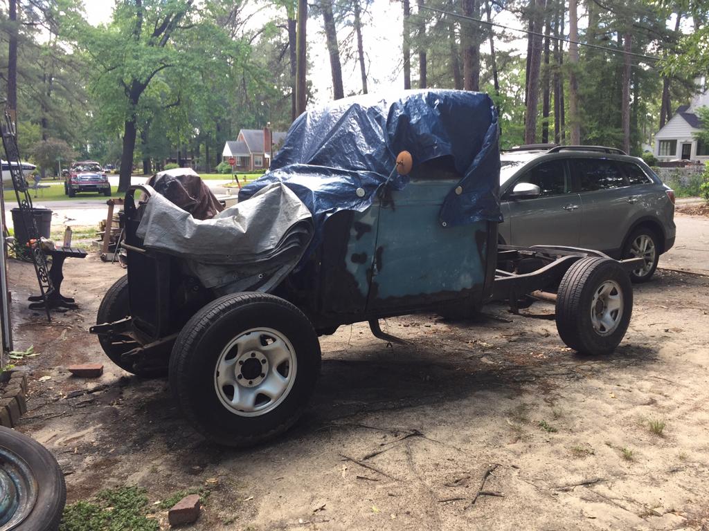

    I bought this truck from a family who had bought it as a parts truck to build another ‘47 about 25 years ago. They pulled some sheet metal and parked the rest.
    I originally made an offer based on it just being a rolling chassis and cab, having no knowledge of the drivetrain. Since I brought it home I’ve realized the engine will probably run so I’ve decided to keep what I thought was the stock running gear. Then it was pointed out to me that the engine is not original but a 235.
    The body has a lot less rust than I expected. Bottom of driver door has a rust line, front cab corners behind fenders have rust. The rest of the cab is surprisingly solid.

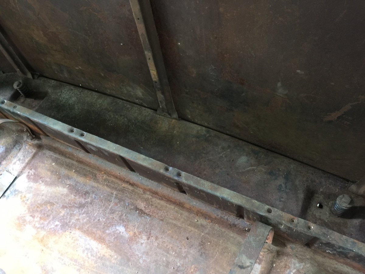

    (Floor panel removed, not rusted out)
    Back of cab separated from floor, but not rusted, just broke?

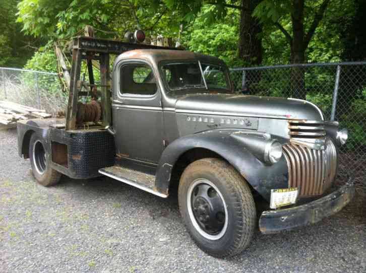

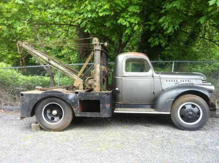

    They are cool trucks.
    I had a 46 Chevrolet big wrecker a few years back..it was alot of fun.
    Have fun with yours. 1566362339800320836085750069437.jpeg 15663623731185660679605677097802.jpeg

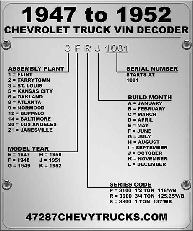

    Okay, maybe someone can help me with this. Since this truck is an early 47, it’s weird looking for information online because when I look at 47 stuff it’s pretty much always AD stuff.
    I found this VIN decoder:
    When I finally found out where the VIN plate actually was on my truck (not where most sites said it was) and managed to barely read the numbers, it comes out like this:
    14DP - F xxxx
    14 is Baltimore, seems legit since this was a Virginia truck
    D is not listed on that decoder, but E is 1947 so I assume D would be 1946
    P is half ton, and this truck is 1/2 ton
    And F is June, so June 1946, because June 47 wouldn’t be an AK truck.
    So am I correct in how I decoded or is there a different decoder for this year?

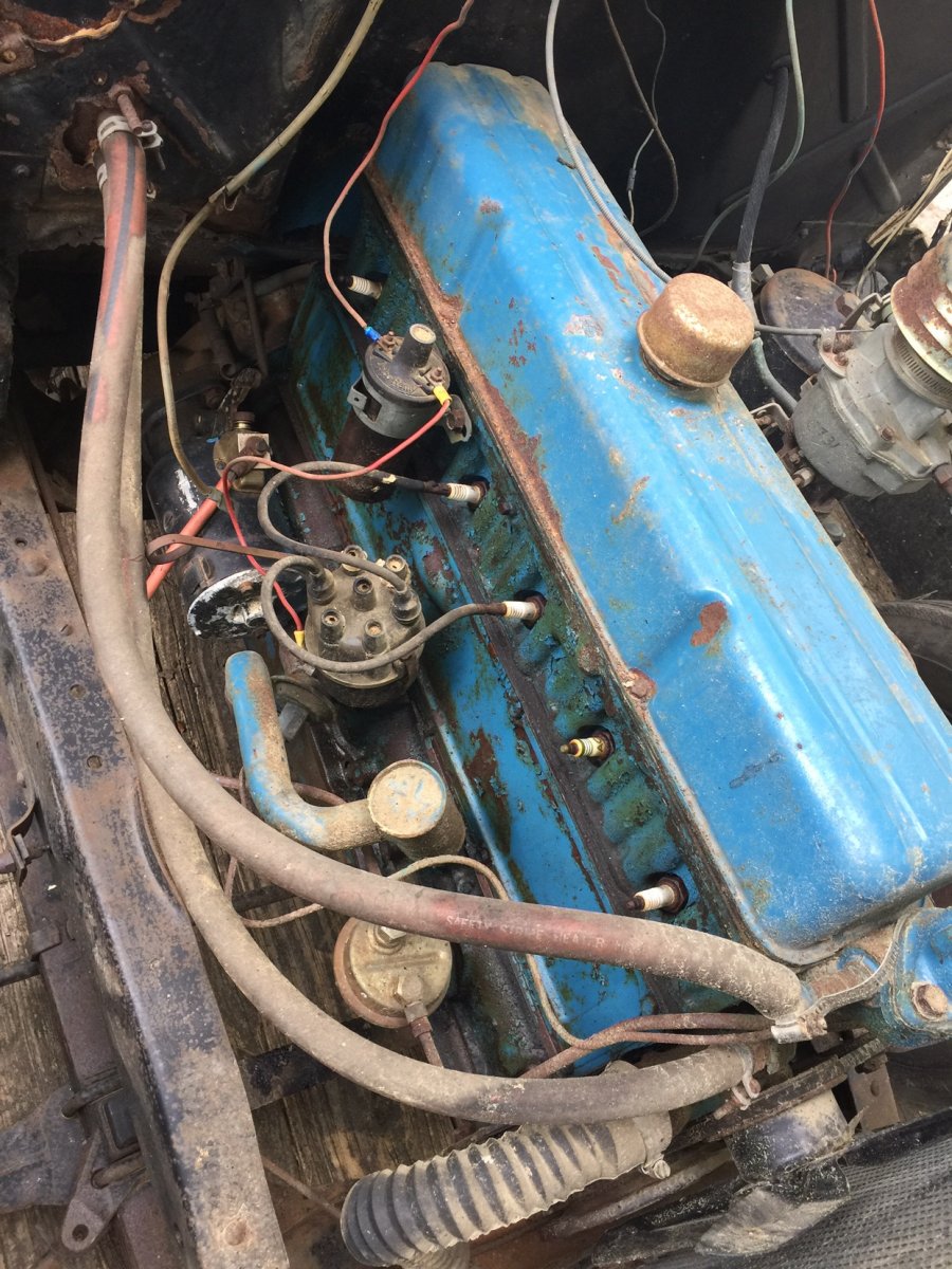

    Is this original trans or something newer like the engine?

    that is a late 46 truck maybe titled as a 47. the back of the cab is spot welded to the floor they don't usually break loose except rusting off. the usual bad spot on these trucks is on the back of the cab where the top and the bottom over lap and spot welded together.

    Your trans is a '41-'47 pickup & light duty commercial 3 speed. You could say it's the old Chevy guy's equivalent to the flathead lover's '39 Ford. They're used with a '38- '47 truck bellhousing. Insides are same as '40 up pass. car, but use a roller bearing cluster. During the '40s & early '50s , Warshawsky & J.C. Whitney sold them with the bellhousing as "heavy duty replacement" for '40-'48 cars.
    Today, they're real scarce in farm country.

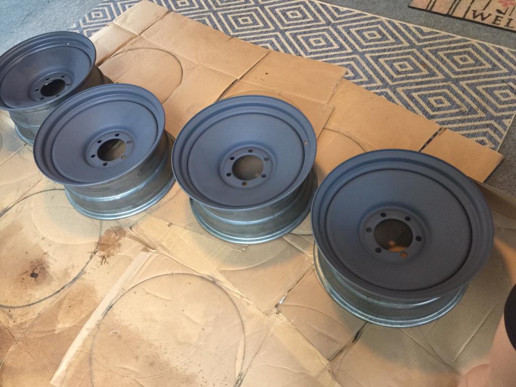

    So I decided to just go ahead and buy some wheels, got these 17x8 smoothies from Jegs in raw steel finish.
    Grey primer, red oxide primer, brown and black, and then Ivory topcoat. I will sand them to the under layers to make them seem old.
    Will mount tires when I get home from Lancaster, PA.

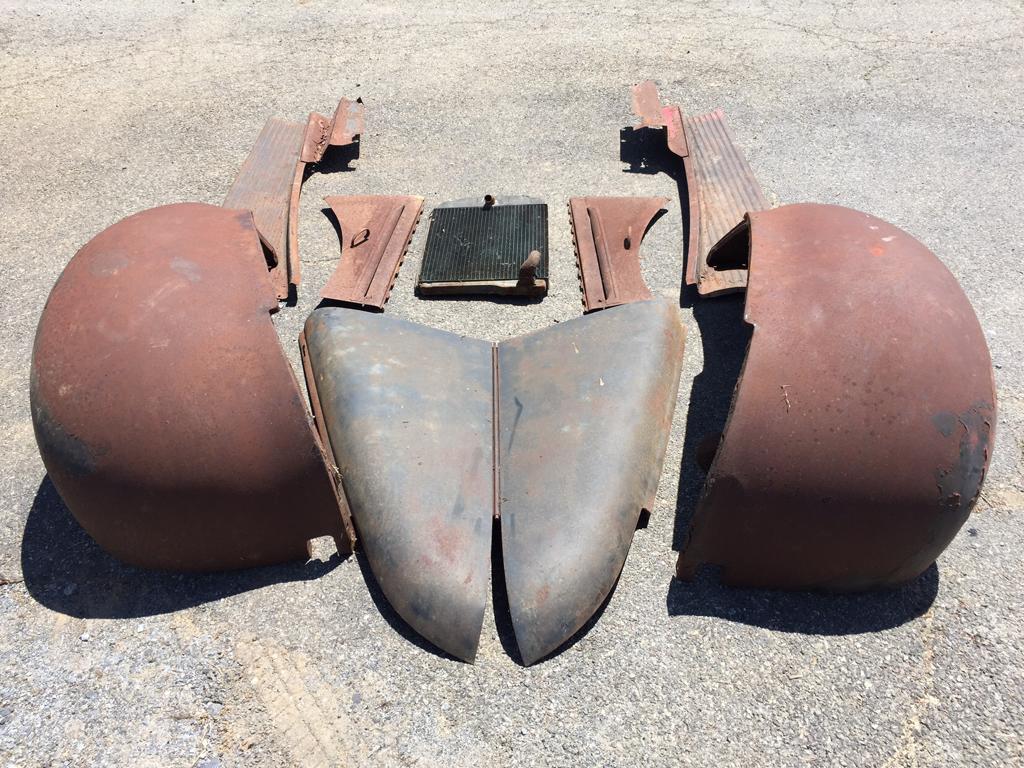

    While here in PA I picked up some sheetmetal. I might make some people upset but I was never in love with the 41-47 front end. So I am going a little different.
    I picked up hood, hood sides, fenders, and running boards from a 1939 Chevy.
    I don’t know how you guys feel about this, but the the cab is the same and the metal fits, I’m pretty excited about this front end and think I got a decent deal. Still need a grille support.

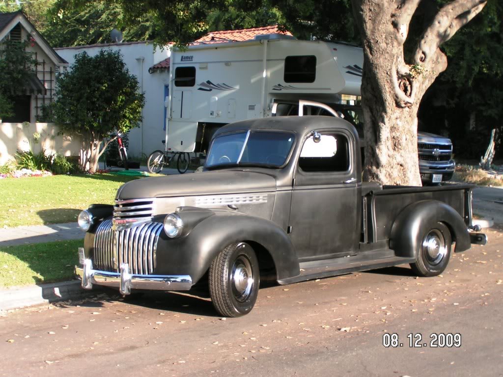

  22. ...here's a 39 I built many years ago, (used a 40 grille)...good luck with your project.

    Thanks. I’ve got my eye on a 38 Chevy “doghouse” or whatever you call the radiator support sheetmetal that holds the grille. That would give me something on the front to hold the fenders. Looks like the earlier grille doesn’t have straight sides like the 39-40.

    Engine is a late model 235 or if you are super lucky a 261. It will have 'captain's bars' on the left side of the block if it is a 261 like this II. Of all the engines that will bolt up to the original chassis and bellhousing you have one of the best with full pressure lubrication and insert bearings .
    Six cylinders may not be exciting but will take you anywhere you want to go if you are not in a hurry. I would leave it alone as long as it is in decent shape. Maybe when the rest of the truck is finished you might consider a mild hop up.

    Thank you, I really do want to keep the 235 but as I was taking inventory of parts needed to get it going (I ordered a new fuel pump, grabbed some plug wires) I got to wondering if the newer engine would have 12v generator/starter/coil?

    Got home with my front end parts today and set them kind of in place.

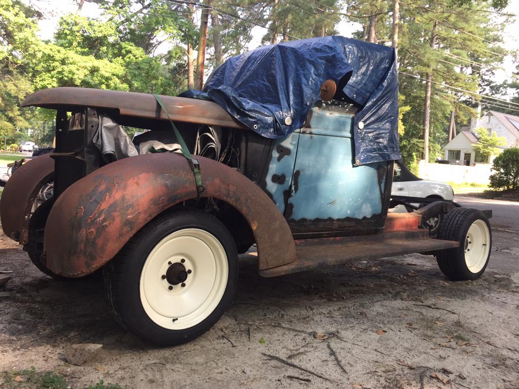

    Finally took off the Toyota wheels and put on my new wheels/tires. I am very pleased with the fitment.
    I was also curious if these wheels were worth anything to anyone, the 2 off the back I believe were original and one is rusted out around the valve stem, other is ok but both are rough. The other 2 are wider and not as bad, I might need to keep one as a spare, but anyone local can get the others free or talk me out of all of them.
