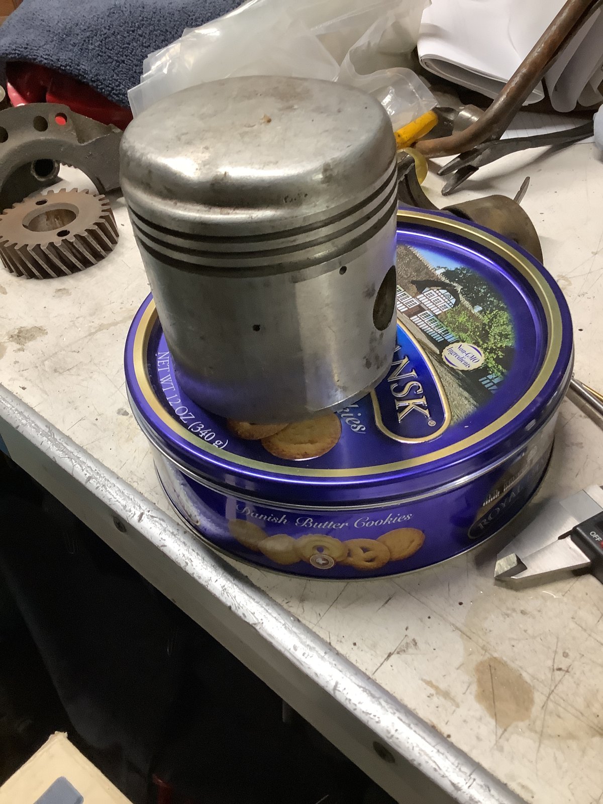

    All engines are air pumps. I ***embled more GMC6’s in 45 years than I can count. There are a few ***embly quirks but clearances are the same as any typical GM engine. We need to know your exact bore. 270’s are 3-25/32”or 3.78125…which is a ******* size today.
    If your pistons are domed Venolia for the first style head which were very common in the past. The rings are right near .100” thick sock and Venolia used that size except for the oil ring. Stock pistons had 4 rings and aftermarket 3.
    Side clearance at the pin was .003” for the piston to bore.
    You need to know the bore of the block and the size of your pistons at the bottom. If your lucky places like Egge machine in So Cal may be able to come up with .rings.
    I had forged flat top pistons made once for an over sized 270 made to a ring pack available at the time. I was going to use the last 270 small port head which had the smallest chamber they ever made.
    Do your pistons look like this. It’s a std bore Venolia for a 4” 302. Good luck. image.jpg

    I will have to get pics of the pistons. They don't have a dome like that. The owner of the engine is an older hot rodder and he collected up the parts so I am ***uming he knows his stuff based on some of the other car work I've seen that he has done. We did not measure the bores yet, I didn't have my inside mic's at the time because I was basically going on the "***umption" of someone else's info. and I should no better ! I should have just started from scratch with a clean slate so I am using my own info. and measurements. These are cast pistons and I am willing to bet they were purchased from Egge or a similar vendor because they look very new. I will get pics (of the reworked head too) along with casting numbers and good measurements so I'm not just throwing out random **** and I am sure you and all the others can point us in the right direction. Over the weekend I will get the info. and post it. Thanks for your help !
