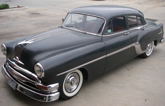

    Heres my little "shed find"
    It was painted green in 76 over the original white, runs the straight 8 and has perfect original red interior.
    Now I've lowered it a bit, put the whitewalls on and oldsmobile caps.

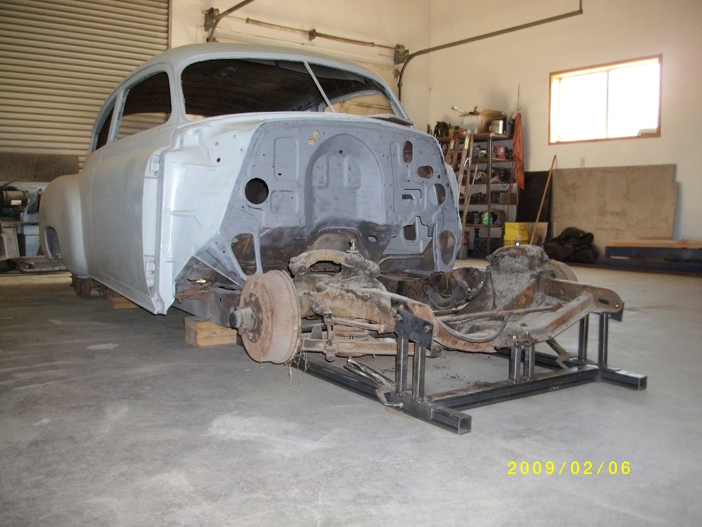

    Heres a few of mine, with fresh Patina on the front end!!!

    any one know any wat clip fits 50 ponchos the best?
    <!-- / message --><!-- sig -->__________________
    I like my cars dragging ass, like a dog wit worms
    Mine has a rear steer nova, 68-72 with discs, keeps the wheels tucked and with the sub tucked high in the frame sits low with stock springs and no dropped spindles

    That is a nice car,Ive not seen any straight Eight 50's pontiacs.(oz delivered)
    According to eddie ford(70s street rodder)there were only 250 brought in in 54,a very small number of those would have been 8s.
    Whats it drive like?
    I changed the diff ratio for 56 pontiac 3:63 (better on the freeway but painfull on take off)
    Let me know if you need any bits I dont have much I may be able to source some.

    Hey Plumfat40, I like the stance of your car, what are your suspension stats?

    It has a 68-72 nova sub, I graft it on as high in 53 frame as possible, stock springs and spindles, rides like a dream, rear is same deal, nova springs inside of frame, granada 8inch rear,

    Thanks for the offer mate, dont need any parts at the moment but once i start pulling things apart im sure something will come up.
    As for driving, it drives fine, really smooth. Does take a bit on take off but yeah, drives better than any other old car I've had.

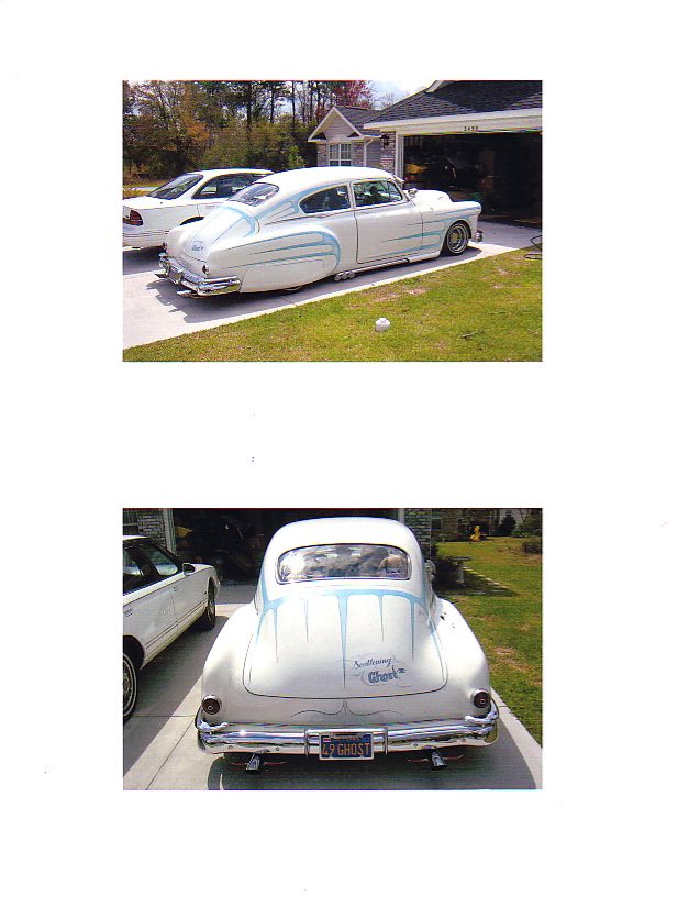

    Here is a Silhouettes member's '49 Pontiac called "The Ghost" down in
    Myrtle Beach, S.C. (looks like a '50 doesn't it?:D)

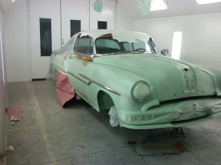

  27. my girlfriends 50 silver streak , we're looking for the body side trim for it

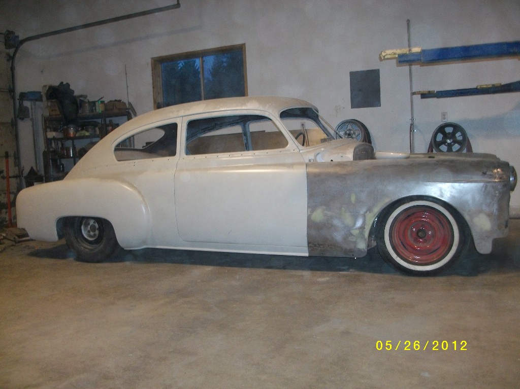

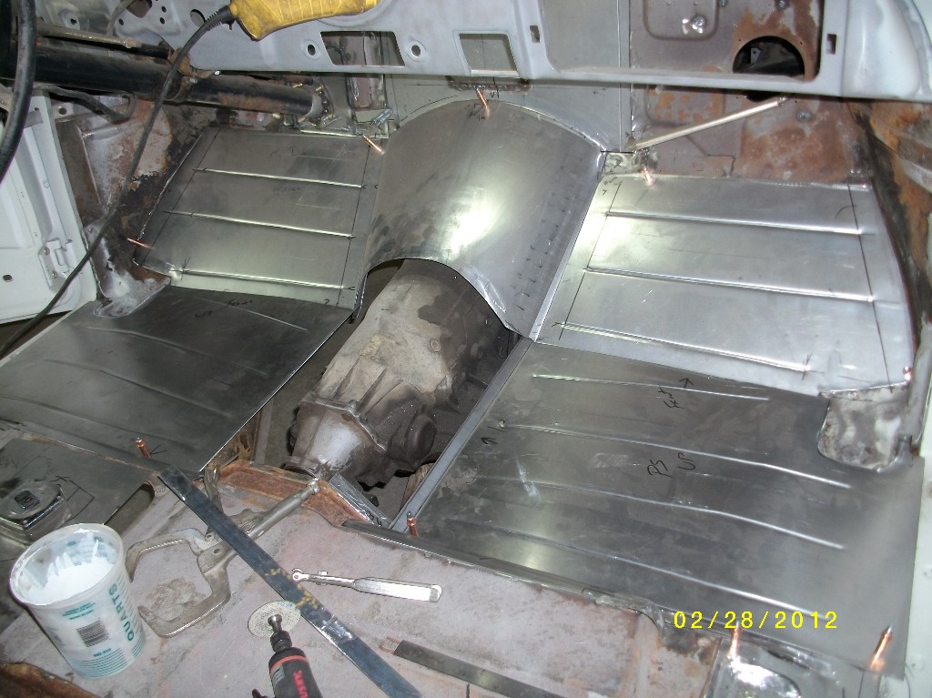

    pics of mine
  29. Thanks for bringin this one back from the dead!
  30. [​IMG] this is how it looks now still looking for the side trim
