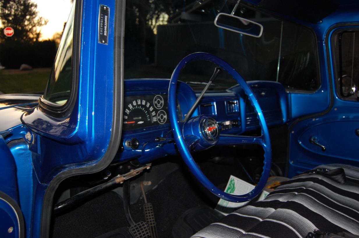

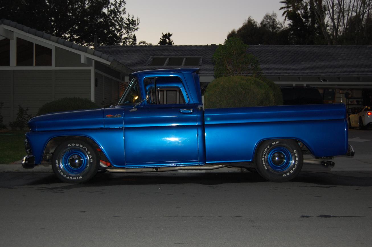

  4. TOE
    Joined: Mar 22, 2006
    Posts: 597
    TOE
