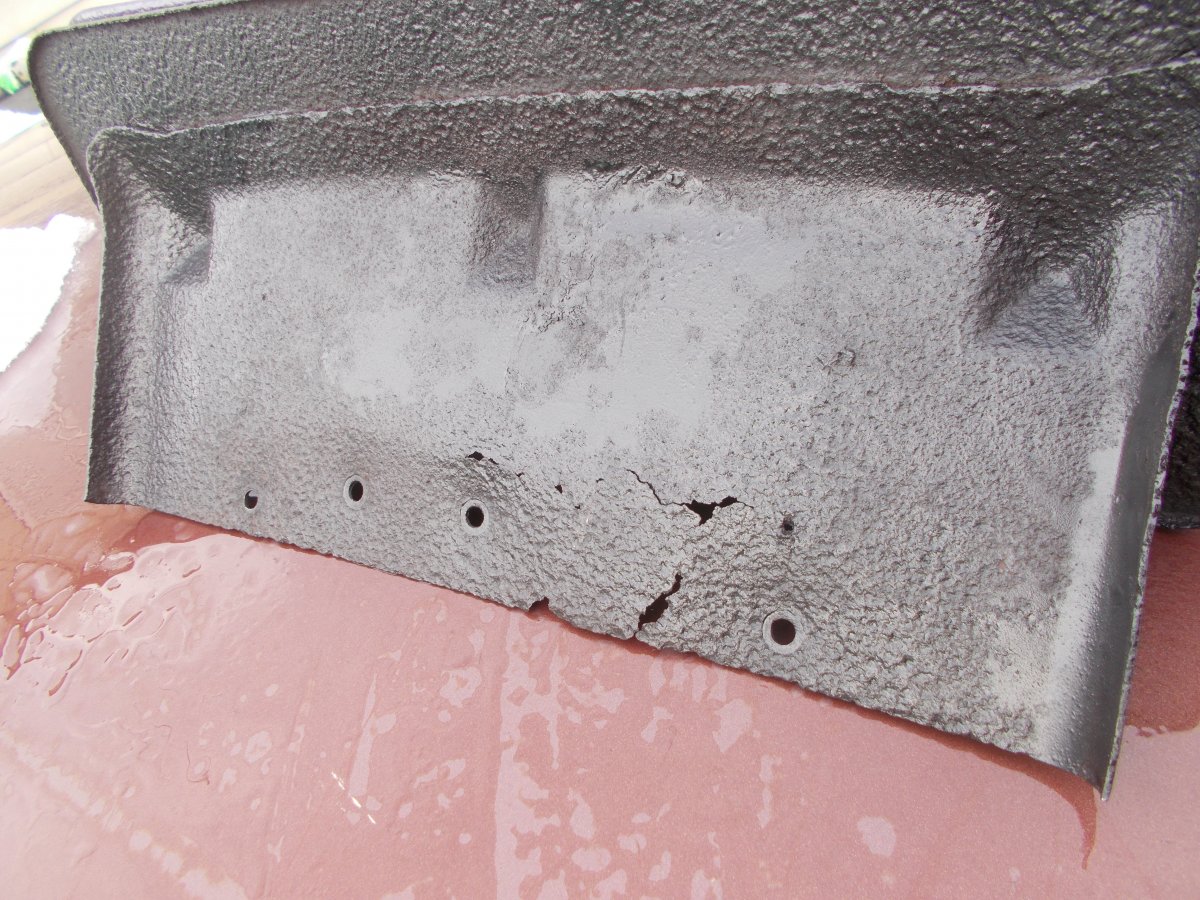

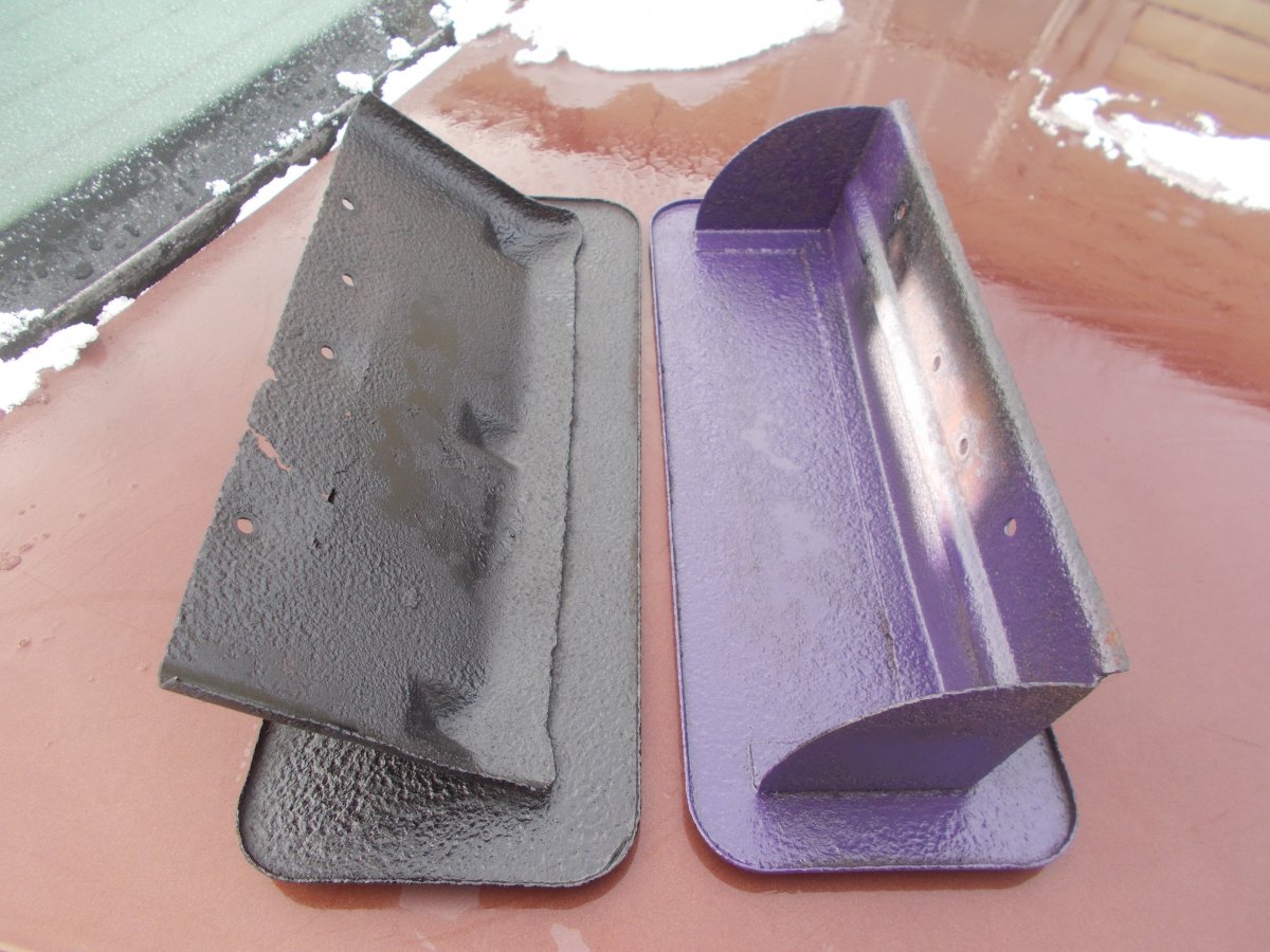

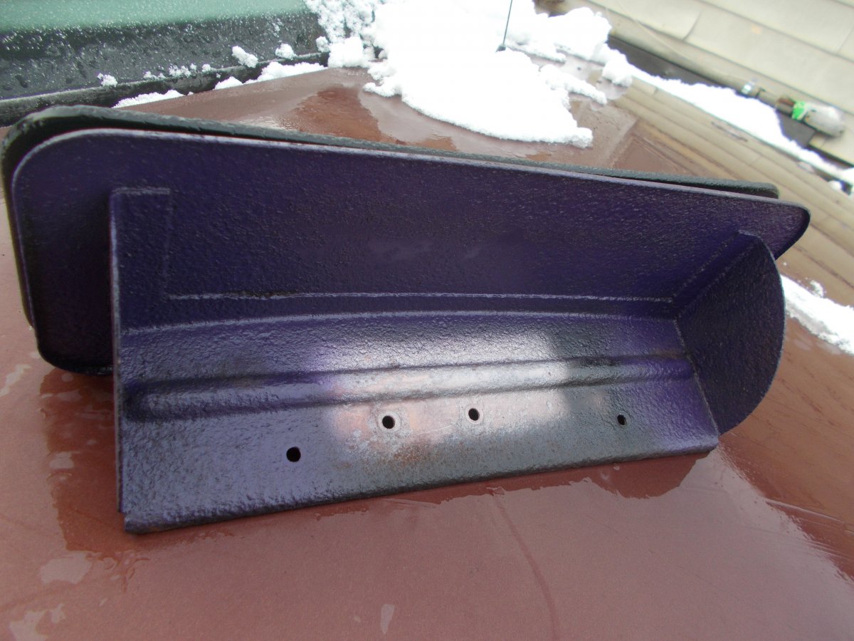

    I happen to have an early and late cowlvent lid...pix...
    anyone have other pix of 1932 differences ? purple one is the late...

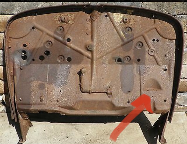

    The photo shows the concave shelf where the vacuum canister for the proposed vacuum ***isted clutch was to go. Development started and a patent was granted but it never saw production.

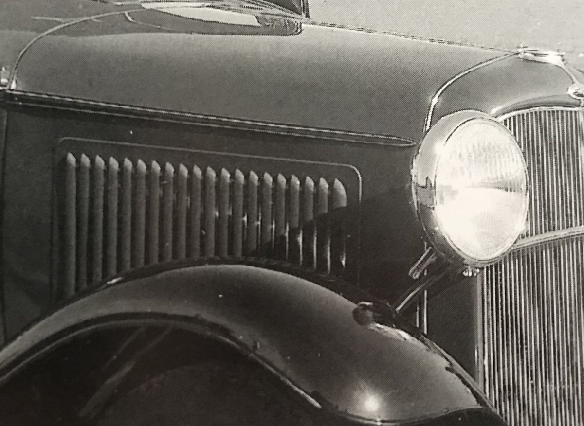

    This is a factory photo showing the raised panel louvers that were on the very earliest ‘32’s. A carry over from the A somebody (Edsel?) decided it made the hood too busy so those early stampings went to Europe. When they were used up the European Fords used the typical hood sides.

    Any Europeans with an extra pair of raised louver hood sides can contact me for a crazy offer to purchase!

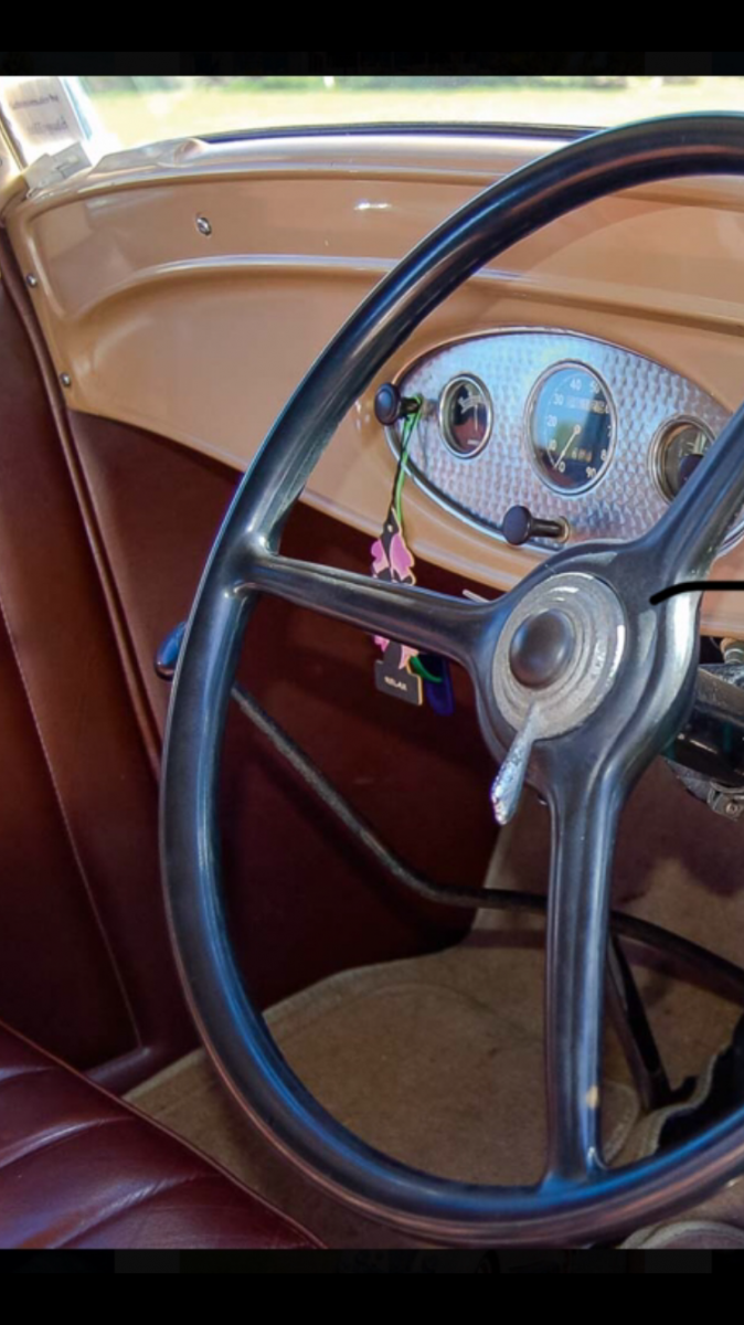

    597FA005-9BA1-4EDB-AB88-6483E80E8010.png As per OP questions, - pictures asked for.
    Here’s an outie dash below, innie above is an ex overseas car, Argentina ? with air vents for windscreen.
    one would have to wonder what the reason was to change it through such a short production run ?
    I have always wondered if the plans for the tooling (sent between the 30 odd factory’s back then) were read wrong at some locations.......
