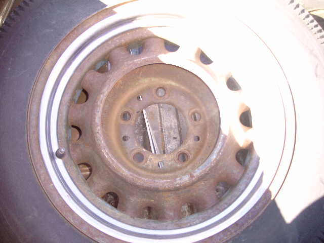

    Any idea what application these spares fit??? - the centers are cool. Are you planing on having the rim widened or cutting the centers out and having them put into a new rim?

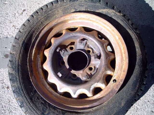

  2. as promised, here are two styles of 5 x 5.5 bolt pattern, and two styles of 6 lug. Both of the 5 lug are 16", the yellow 6 lug is 16", the bare 6 lug is 15".

    Thanks again moparsled. I really appreciate you taking the time to take and post all these pics. It really helps!
