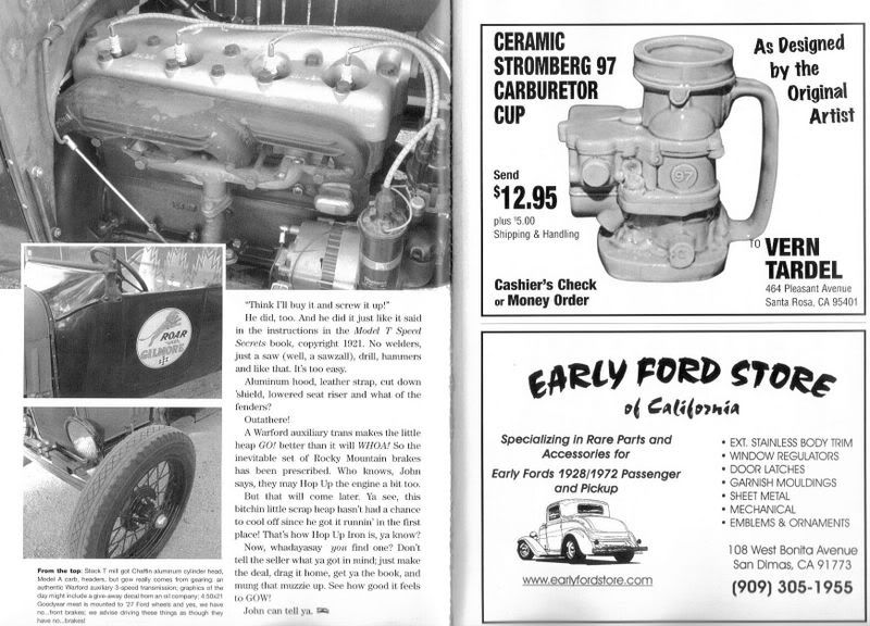

  8. docauto
    Joined: Dec 1, 2006
    Posts: 789
    docauto
    from So Cal

    docauto, i love that car!!!

    I just bought the model T speed secrets book... and model T in speed and sport, looks like there will be some good information in there! thanks DocAUTO an Bruce!..
    DocAuto, read the article, that car is pretty sweet... and yes, I see that you run rocky mountains on it... still I would like to know, how fast do you get the buggy? or do you want to keep that a secret? haha.. this is going to be fun.

    Man that's a lot of posts since I looked at this! I do have a Warford available with driveshaft and all the stuff you need, drop me a PM.
    In Warford high, the car will easily do over 65, but that's WAAAAY too fast for a car with marginal rear wheel brakes (and no it doesn't have Rockys!!). It's plenty quick with the "Z" head. I've got several overhead T's, but this one is a blast! Nothing newer than 1930 on the car......
