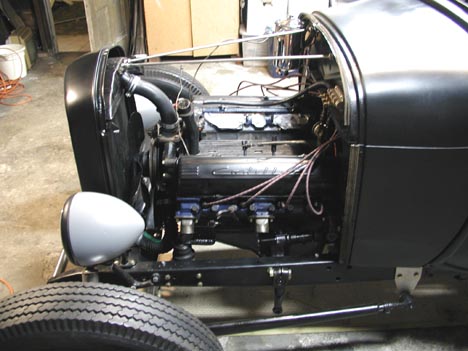

    Starting up a new build in the shop.
    1956 Cad 365 and a Turbo 350 in a 1932 Ford chassis.

    Where do you get an adapter like that for the engine/tranny? Do you guys sell them?

    I'm guessing thats a trans a dapt adapter ? sure looks tidy.

    Wow, very cool. I love those valve covers. Aren't they 331 pieces? Neat color choice on the engine, too.

  9. bigcheese: the covers interchange from '49 to '62 models. But, yes, I think they are the early (331) covers.

  11. Cool setup. That 350 turbo should make a real performer out of that 365 caddy motor. Now, I can just see a dual-quad Eldorado setup on it.
    I'm planning on using some stainless steel spray-can paint on my Hemi for the all-silver look too....
  12. Cool! It's nice to see another Caddy motor going into a rod.
    What're you running for cam and ignition?

    I guess the motor does look painted,it's not.Just bare metal fresh from the rebuilders.Got a dual quad that will be on it shortly.We need to flop the trans mount around to get the engine back a bit.Fabbing engine frame mounts is next.Cam is stock,ignition is a ball bearing dual point conversion.
    I'll keep posting pic's as we progress.

    Those "block letter" valve covers are actually from 55 and later Cad motors. Early 331's have the script letter valve covers (which I put on my 55 motor), and yeah, they all interchange on the 331, 365, and 390 gen motors. Nice to see some other OHV Cad folks!
    [/ QUOTE ]
    I was thinking the waterpump was gonna crash into the rad by the looks of things.
    The turbo is really going to make things nice with that engine.
    What body is being used on that project?

    The body is going to be a 1930 A pick up.
    Hope to have more pic's latter this week...
