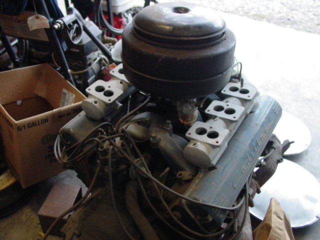

    Dirty2
    Heres mine

    from hell
    hers my 55 331. see the diffence between the back that i was talking about. look at dirtys then look at mine.

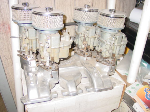

    I'll be by when my truck is back on the road, to pick up the hemi, cad and cad intake. :D;)

    from D/FW
    What a sweet looking 4 carb intake:cool: :D

    Dirty2
    Yep it cost me enough !!!!
