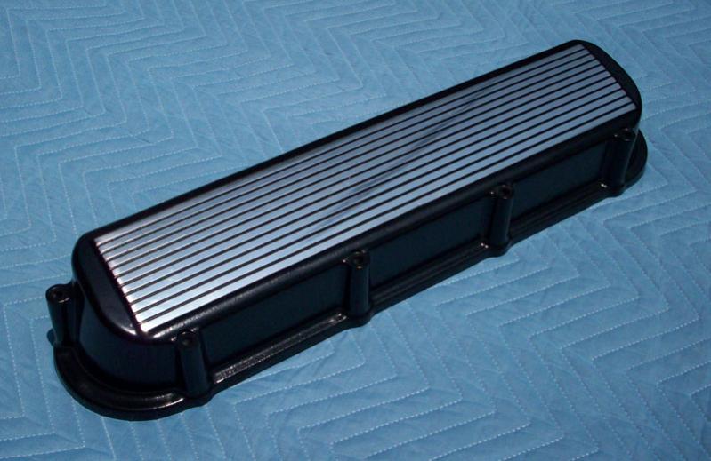

  1. We are currently working on a new product that some of you may be interested in. Even those of you not necessarily in the market for these may have some useful input to share.
    The 331-429 Caddy engines have a decent finned aluminum cover available. However, they don't clear adjustable rockers. Or have the Caddy script. We are intending to solve both of those common requests with one product, and I would like some HAMB input on the design.
    Firstly, they will have clearance divots similar to the old Hildebrandt covers (the bare aluminum covers). We have Studebaker and Isky (made for the Caddy back in the day) adjustable rockers on hand for fitting, to make sure all 3 common methods of adding adjustable rockers are supported. The other common retrofits (Ford, etc) are less bulky the bulkiest parts of the Stude and Isky rockers combined, so they should clear almost anything but modern aluminum roller rockers. Making them clear those would make them ugly, IMHO, and I don't really see any demand there anyway. Probably sell more to people who just want a cool looking cover, than to guys who need them for clearance anyway.
    Secondly, we are intending to use the early Cadillac script that is connected across the bottom similar to the early Corvette script. The stock valve covers have 2 small fins at each end in line with the script. I have attached a pic of an aluminum SBC cover that uses this script with 2 small fins at each end (the blue one). There is a similar cover with the similar Corvette script with a lot more fins (the red one).
    And yes, this will be an officially GM licenced product, not something that 'sorta looks close but isn't really right' just to avoid paying the General.
    My thought is that combining the 2 styles (3 small even fins at each end in line with the script, then extra fins running the length) would look good, but I would like your input.

    Wow, Chris - I really like the idea of the 3 small fins combined with the extra fins that run the length. Could you snap a pic of a sketch of what you had in mind? You know, draw it on a napkin, and snap a camera phone pic, to help us visualize... ;)

  5. I think if you made the fins deeper like real cooling fins with more surface area along the sides of the fins, it would look better. When the fins are really shallow, they don't really give any sort of illusion that they're there for a reason.
    Having them deeper would make it easier for people to paint in between the fins if they wanted to too.

  8. The Chevy covers with Caddy script are already in existence, so I used them for illustrative purposes since they are very close in design to the Caddy covers. I think the poly-gonal shape they used is a bit ugly, we'll be using a shape closer to the Covers I used in the photo-chop here, or more like the Offy covers for the Caddy.
    Rustybolts - when you say deeper fins - are you thinking like the depth/width of these Offy covers? That is what I was intending to get to eventually. If you have something a little different in mind, please elaborate.
    Bobby - I like your resourcefulness there. I actually have a set I've started like that using the earlier script like what we are working on for these aluminum ones, for one of my 500s. We have done the big flat tops for the 500 engraved with that script, and then there are the new ones with fins remeniscent of the 30s Cads (no scripts) that are coming out soon. That is a picture of a test pour - the molds are done.
    I PS'd 2 variations - 1 with the 3 fins close to the length of the originals, and one with longer ones for less open space.
    I like the more rounded shape at the ends like the Offys, but I'm not sure how that will work out with rocker clearance. The squarer ends will definitely be more conducive to using the adapter to put them on the 500 (the more rounded ends on the Offys means you have to stack 2 pairs of adapters with shaft rockers). By more rounded, I mean the transition between the top surfce and the ends, as viewed from the side of the cover. Thoughts?

    yeah..deeper fins like the offy and hilde ones that are out there...also dimpling them would be nice if fitted on a pair of heads with funtioning adjustable rockers. Making side dimples just because they look cool and are not functional would not be the way to go. Lots of guys would buy a reasonably priced set dimpled and use them with their adj rockers. A non polished or polished aluminum finish would also be the way to go. Guys could paint them to their liking or polish them up. The non polished or polished ones would sell better than something that is pre painted.

  15. Yeah, I was thinking like the Offy ones. Deep fins like that look cool and look like they might actually help with cooling down the oil a little bit, and deep fins look more like something that would have been made back in the '50s or '60s.
    Also, for some reason, if the bottoms of the slots in between the fins are U-shaped, it somehow looks better to me than if the bottoms were square or trapezoid shaped trenches with square corners. The U-shaped slots look like they're nice old style sand cast parts. If they look square on the bottom, it looks like new "billet" stuff that was made on a mill. U shaped slots with a rough sand cast surface looks even better. It makes the top polished tops of the fins stand out even more when the trenches between them are still rough. Paint sticks better to a rough surface too if you want to paint them.
    I didn't catch if you were going to sand cast them or die cast them. If you die cast them, but make them look like an old sand casted part with curved trenches and no sharp inside corners, I think you'll have a winner.
