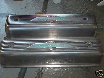

    Ok. Have no camera for the moment, but here is some old pics. Go and see my album in the future, will add more pictures all the time.

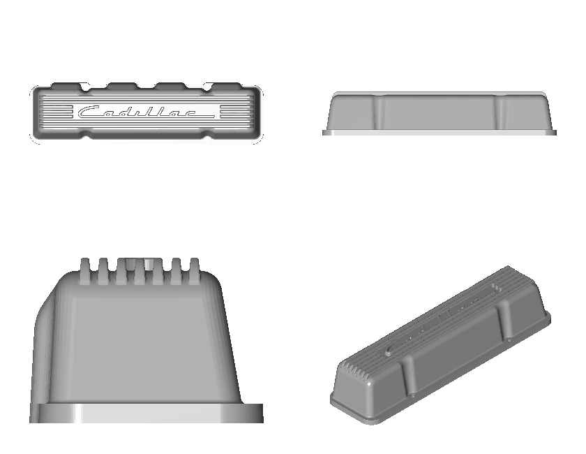

    We pretty much settled on a design, and sent materials to the tool maker (head, OE valve cover, and Isky, Ford, and Studebaker adjustable rockers) in the fall. The original ETA was this month, but they haven't gotten a test pour to me as yet, so I am guessing it will be another month or 2 before these things see the light of day. I'll pester them for an update and relay it here. :D

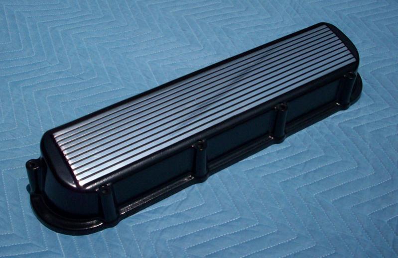

    I just re-read the whole thread, looking for any discussion of the third picture in post #8. It appears to replicate the design of the early-'30s Cad V12 and V16 covers, which I have always thought were exceptionally good-looking and "Cadillac elegant".
    I'm also reminded of the '55-57 T-Bird factory covers, which I particularly like. Seems that the fins were more closely spaced and had sharper edges than the average aftermarket valve covers. I think it would be cool if you considered that kind of minor refinement when you make your final parts (maybe this is the difference between sand cast and die cast covers -- zat true?).

    The black covers with the finer fins fit a 500 Caddy, and they exist (sort of) - they have done a test pour of 3 sets, but no more so far. They are sand cast, and I'm pretty sure those T-bird covers are sand cast as well.
    My understanding is that die casting can produce sharper edges, as well as much thinner (lighter) castings without worrying about porosity, and it is less expensive per part if you are doing a large volume. Unfortunately, it isn't practical to do on low-volume stuff (unless maybe you had it done in china or something, which I try to avoid when I can).

    Got the art and approved it today. They expect to have the tooling done by late January, and we should have valve covers on the shelf by late February / early March. We will be taking pre-orders once the tooling is done, and a fairly concrete ETA is available. However, I am accepting names for a 'call me when you have them' list, as of now.
    They are designed to clear the Isky, Studebaker, and Ford adjustable rockers.
    There will be no provision for any kind of breather setup on the valve covers (no baffling, bosses, etc).
    On a related note, the adapters to fit early valve covers on the 472/500 engines will be back in production around late January / early February. However, the rocker clearance bosses on these new covers will not line up (so no adjustable rockers with that setup), and breather setup will be a bit of a challenge.
