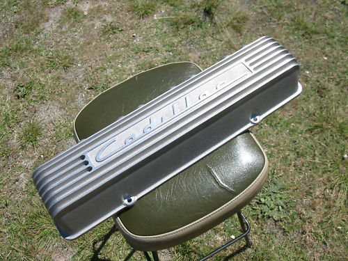

    Thanks to Langy i Did the adapters to My self missing only the 4 holes for the new offenhauser finned valve cover when i bought them i drill the 4 holes and i finish my engine

    The early Cad 331 2 bolt valve covers leaked and thus, the later 4 screw valve covers came into production after engine #33,000 plus.
    The early 2 bolt covers will fit a 4 screw if you replace the 2 rocker towers to accept the v.cover bolts.
