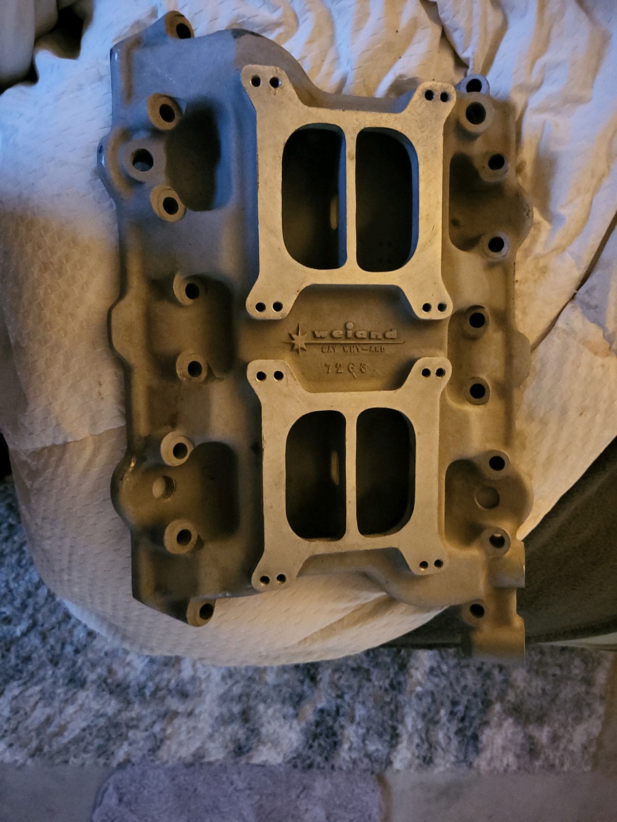

    I'm having a 354 Chrysler Hemi built. It'll have a Weiand 7263 intake on it with two Edelbrock 500 cfm carbs on it. I'm looking to purchase two air cleaners but I don't know if the two if them will fit. Does anyone have this intake manifold, and if so can someone give me a reasonably accurate measurement of carb air cleaner mounting stud to stud? I need to now how far apart the air cleaners mounting studs sit when mounted on the intake to know how big a set of air cleaners I can fit. If anyone can do that or knows that information I would greatly appreciate it. Thanks!

    7&1/2 inches, same as carb. spacing

    Thanks, Eddie!

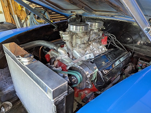

    I have dual Quadrajets on the stock hemi manifold. I used 56 Corvette air cleaners. Hemi.jpg
    51 mercules likes this.

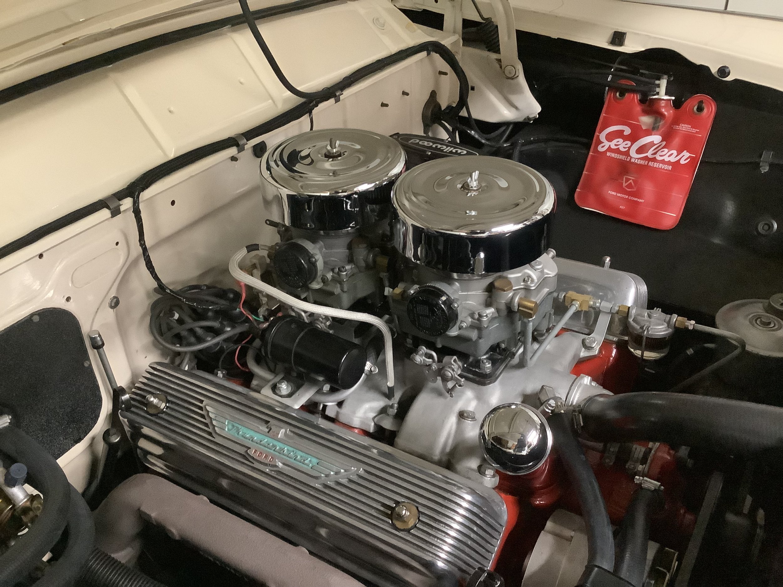

    Doug 520…..my dual quads are 7-1/4” on the centers and the tops I like touched so I used 2 90’s Harley Davidson stock air cleaner covers that have a cutout. I have the cutouts facing each other. They are also on the small air horns and I got adapters from Charlie Price. If your 500’s are later they will have the 7” air horns. Air filters are EMPI’s . IMG_0193.jpeg
