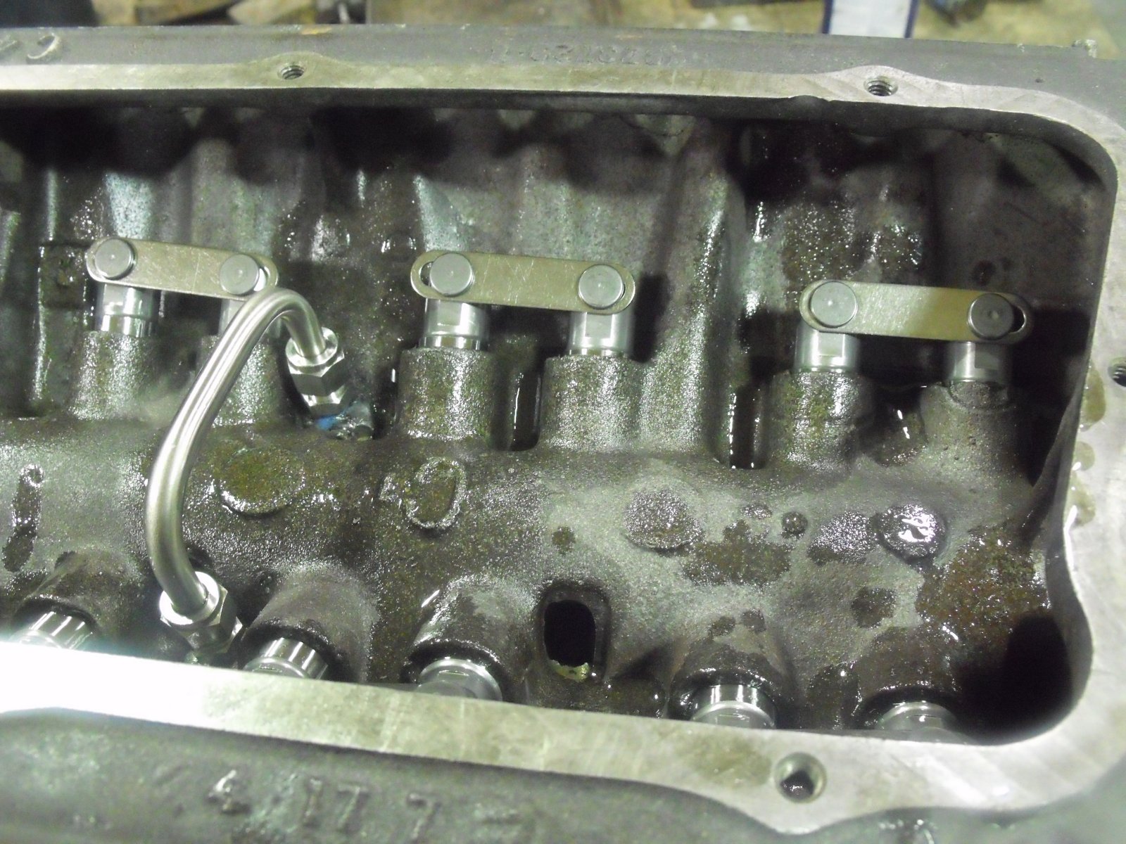

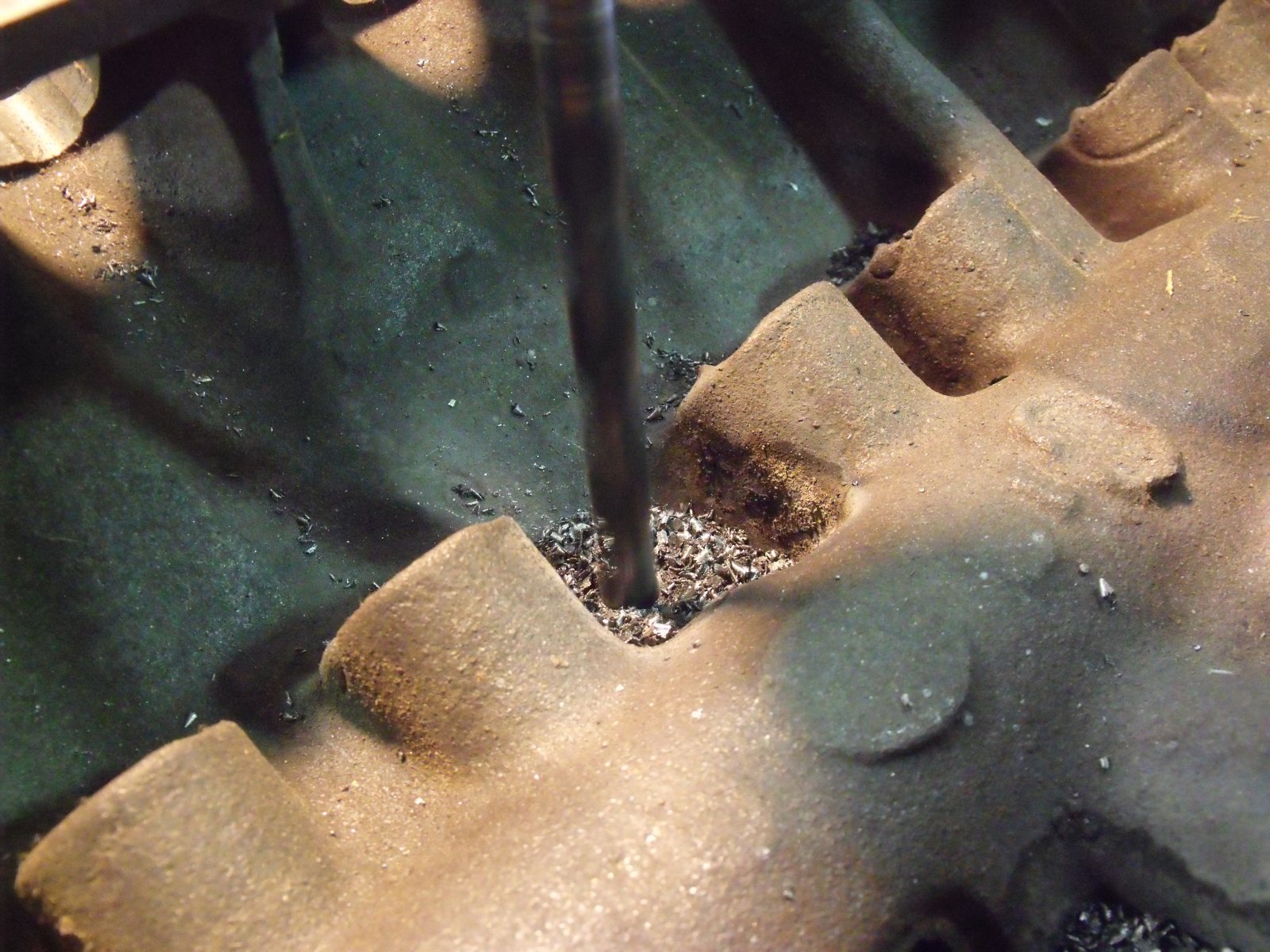

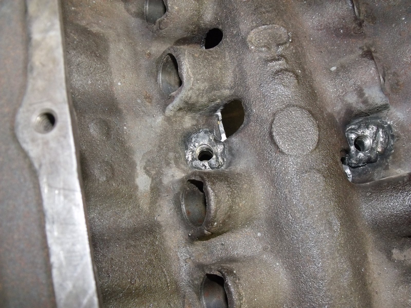

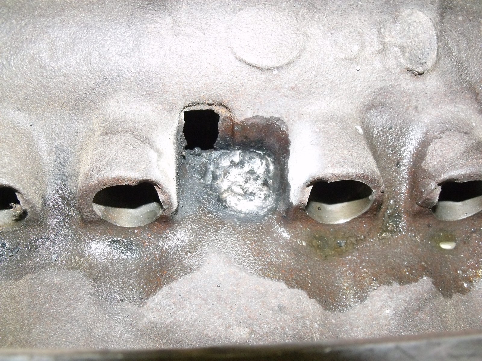

    As requested, some photos of the oil system mods that I have used on certain projects. The goal is to provide more oil volume to the left lifter galley which, in oem form, is fed from the front main bearing. Although very adequate in the average rebuild, the oil supply through the convoluted path can be made better in a high out-put ***embly.
    Once the block is stripped and cleaned I pile up some Ni-rod material next to the lifter bore above the galleys on each side.
    Next step is to drill vertical hole through the weld material and into the galley. These holes have to be very plumb or else the fittings will be angled and near impossible to connect. The hole diameter must correct for the 1/8" NPT
    Next step is to tap the holes for 1/8" pipe threads
    Next step is to install tube fittings. I use blue Loc***e to seal the threads. These fittings are for 3/8" tubing
    The cross-over tube is next. This is 3/8" stainless.
    Now the pre-***embly mock-up continues.
    I think that the process is fairly straightforward but let me know if you have questions.
