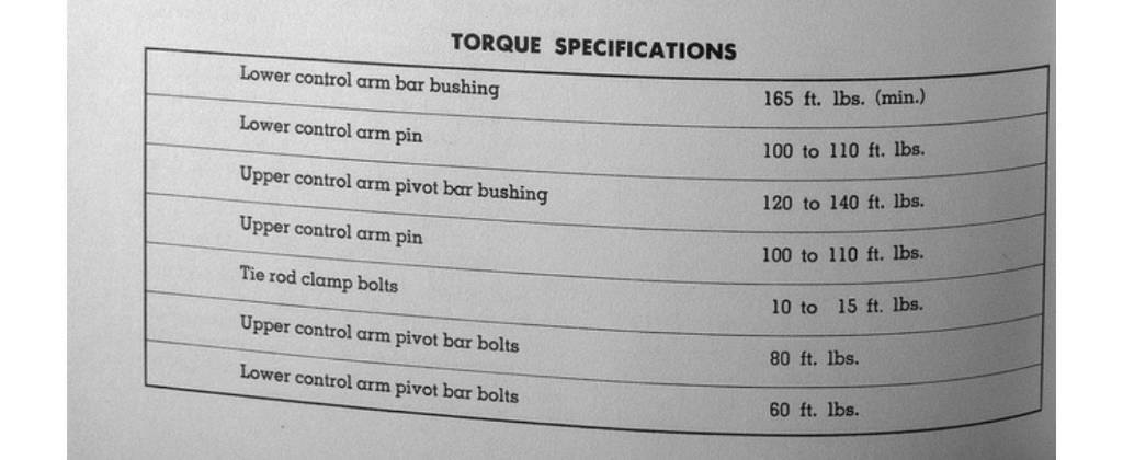

    I'm rebuilding the front suspension of my 53 coronet. Does anyone know the procedure for the inner shafts of the upper and lower control arms as far as torque specs/adjustments? Thanks
