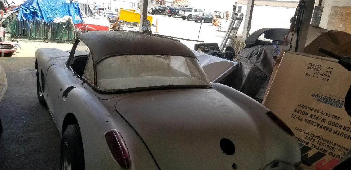

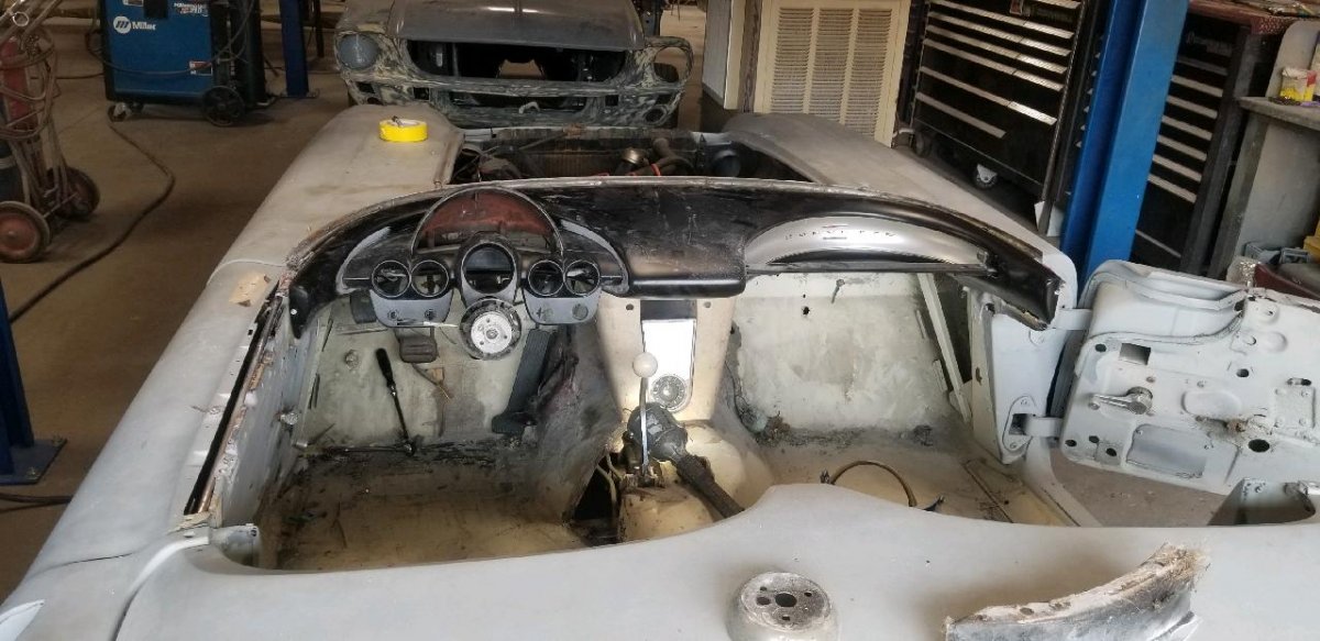

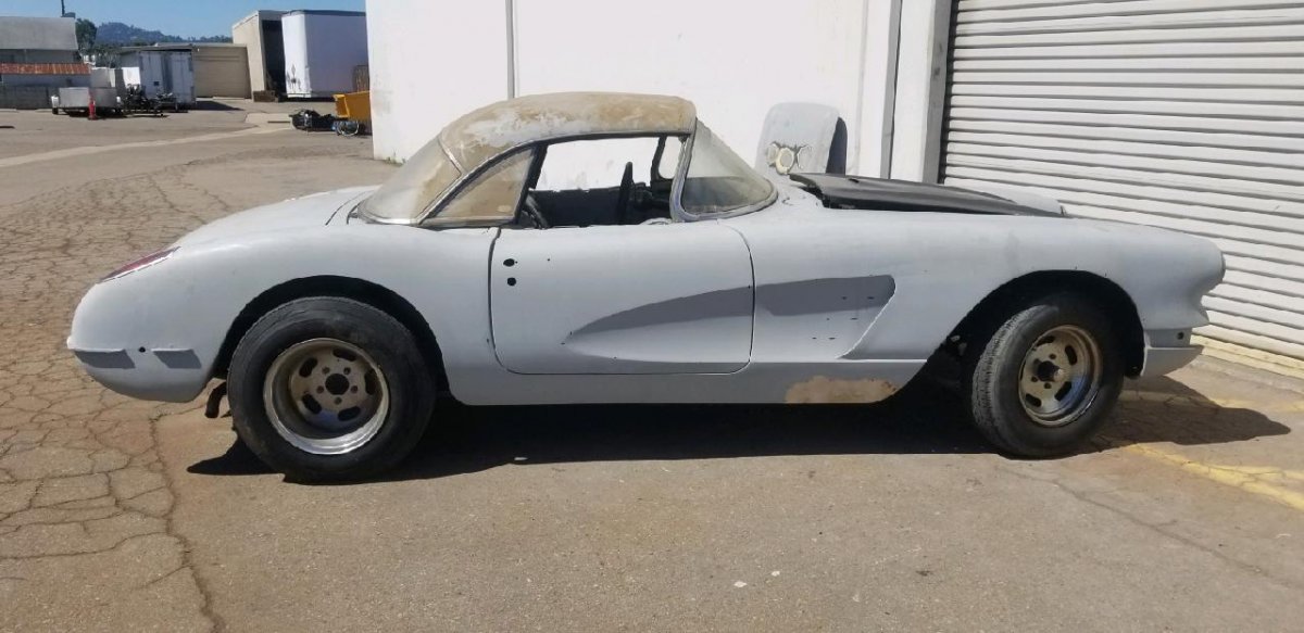

    Thanks for the roll bar pics. Here is my Vette, ex drag car that was in storage for over 40 years. Has an Olds rear end. Inner fenders cut out for fender well headers and unfortunately the PO hacked out the dash board which I am working on replacing at the moment.

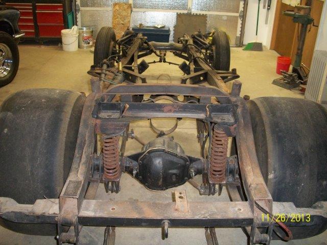

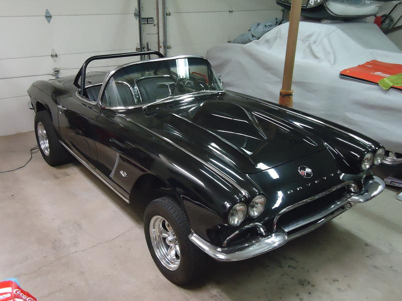

    I have some pictures of John Reidenbach's cage during construction with his black 62 that is now running low 9s. I also may have a couple of pictures that Quain Stott fabricated for the 61 that is now called Frequent Flyer.. Vetrod though has a pretty nice bar setup in his black car and he is able to run quicker that 11.5 with it, I believe. I thought I had pictures of Jim's bar and I probably do but it is not in the file I thought.I liked the way Jim went thru the convertible top lid and it looks pretty sanitary IMO. I will see what I can dig up and throw them in here for ideas or comparison. I also know Baron installed a nice setup with his big block 57 and there may be some pictures we can find on that.

    Had a crazy morning so may as well add a few photos now instead of working like I should.
    Here are a couple of pics of John Reidenbach's 62 that he built out of a derelict. Car runs really strong.

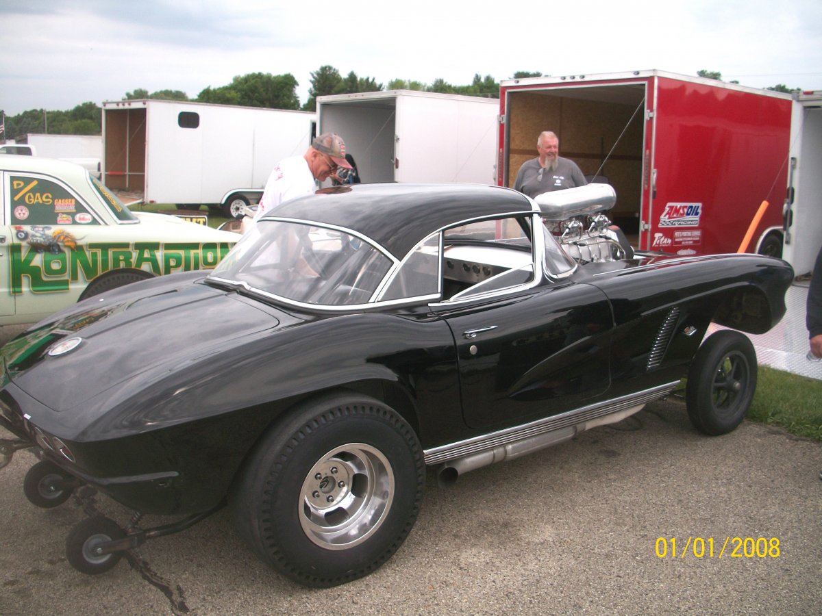

    A side shot.
    A picture of John getting in the car at the 2018 Uncle Sam's Pie Crust event-he was the quickest car at that event-date on photo is not correct)..
    John and I side by side in the pits. If he was quickest, I was not second quick that day, although we had a lot of fun. You had to average your 3 qualifying runs and then go thru eliminations. Fun day to say the least.

    Here are a few pictures of my 60 ch***is that was done by Ricky Moore in Alabama. This was an old g***er in the 60s with a small block and a Pontiac rear. Ricky updated the car in the early 70s and ran gas and modified production with a BBC, Doug Nash and Dana 60. This car did not have a modern cage by today's standards but you can make out where he mounted the tubes, making a v plate that he welded to the frame.
    I tried to find Jim's pictures but I out smarted myself and hid them somewhere. Hopefully Jim can show us how he did it. Hope this inspires some thought.

    Pics as promised.
