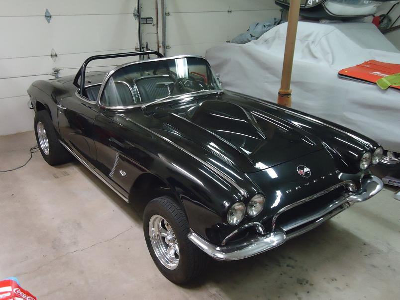

    How about his one?

    Dude that is a nice car.

    Hey JP, glad to see you are on here. You have a “cool” very fast car. I’m sure we can learn some things from your experience

    That's a real nice car!!!

    Thanks for the good comments on Butch's car. I have driven his car many times and have spent many hours working on it. It was a major part of his life. We raced each other almost 50 years. My favorite picture of him in his last years.
