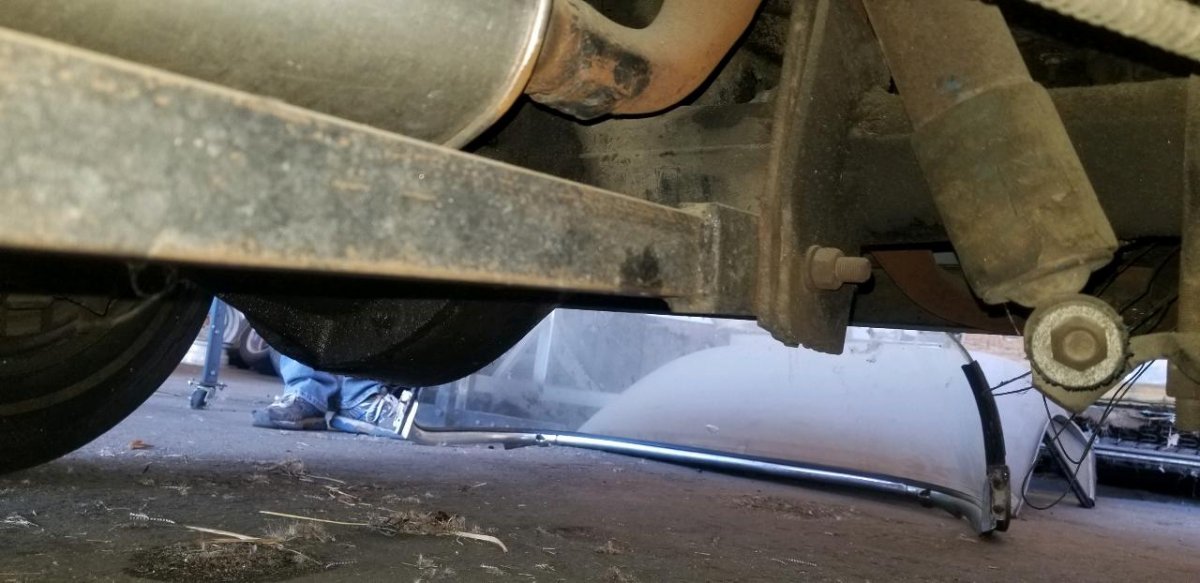

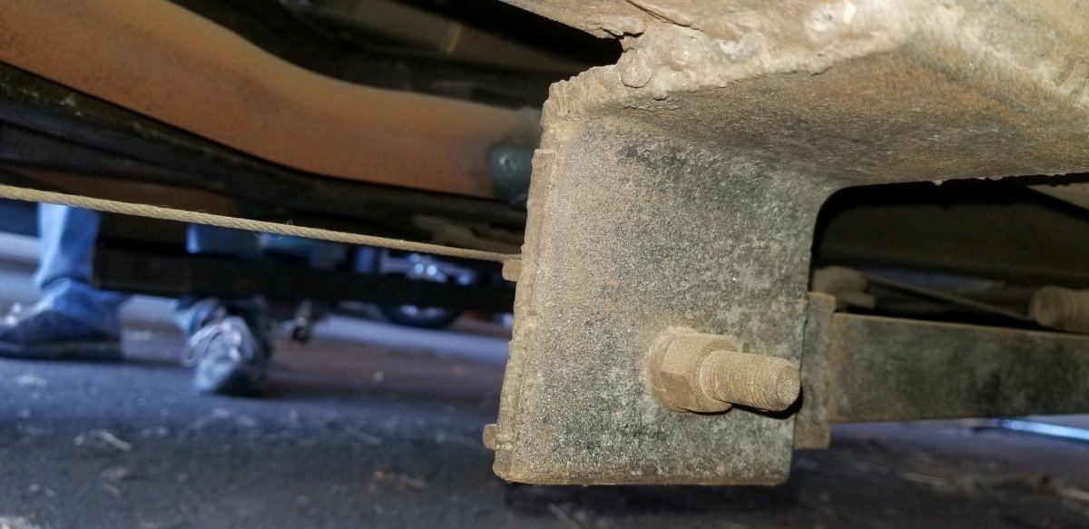

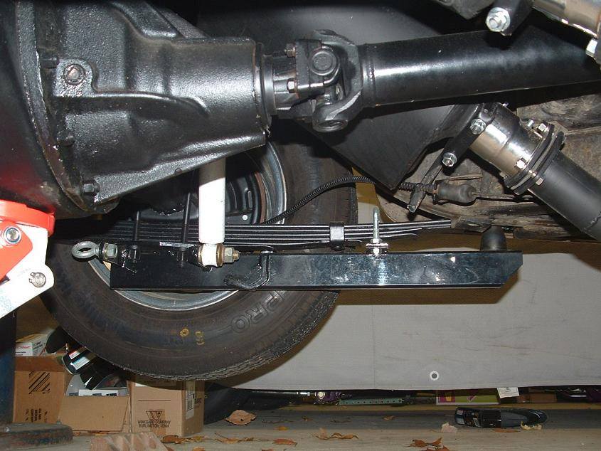

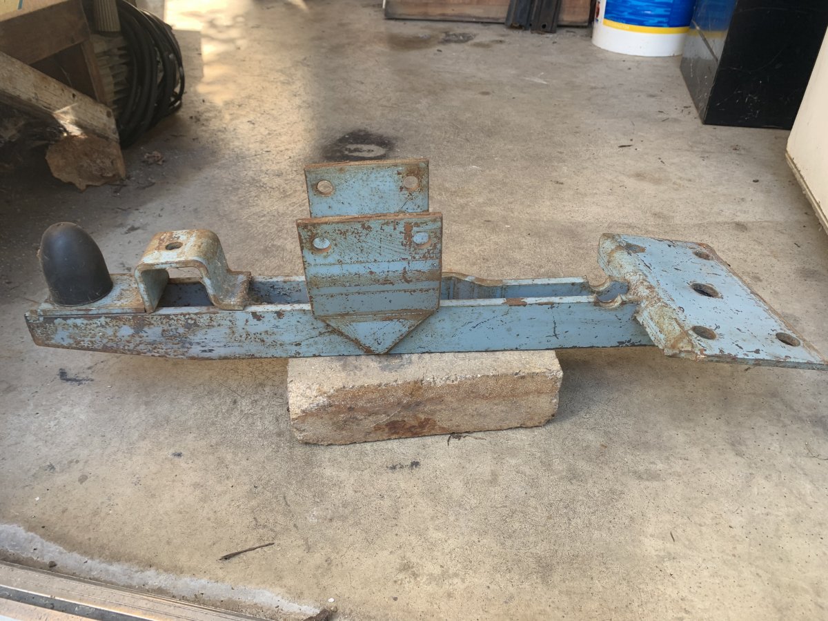

    Here are the current traction devices on my 59 :p Thin wall inch and a half SQ tubing...
    Deuces, 31hotrodguy, loudbang and 2 others like this.

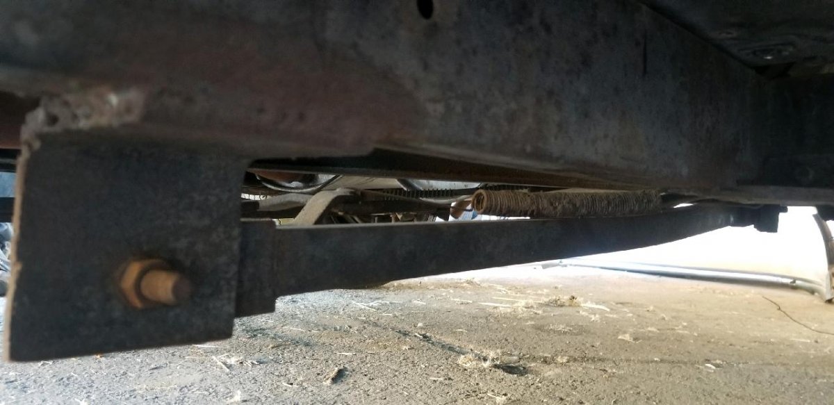

  19. C1/C2Guy
    Joined: Aug 15, 2019
    Posts: 81
    C1/C2Guy
    from Utah

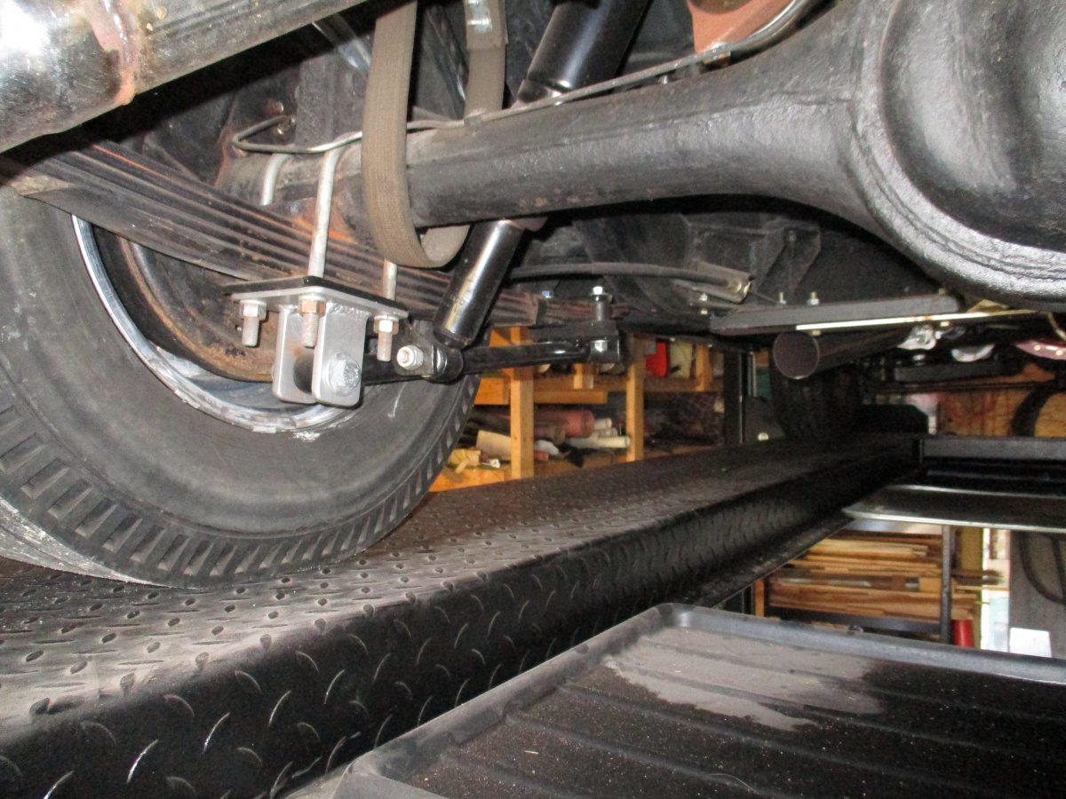

    Here is a pic of the traction bars on my 56. I think Colin and I both have room for improvement in that area ;) IMG_2774.JPG

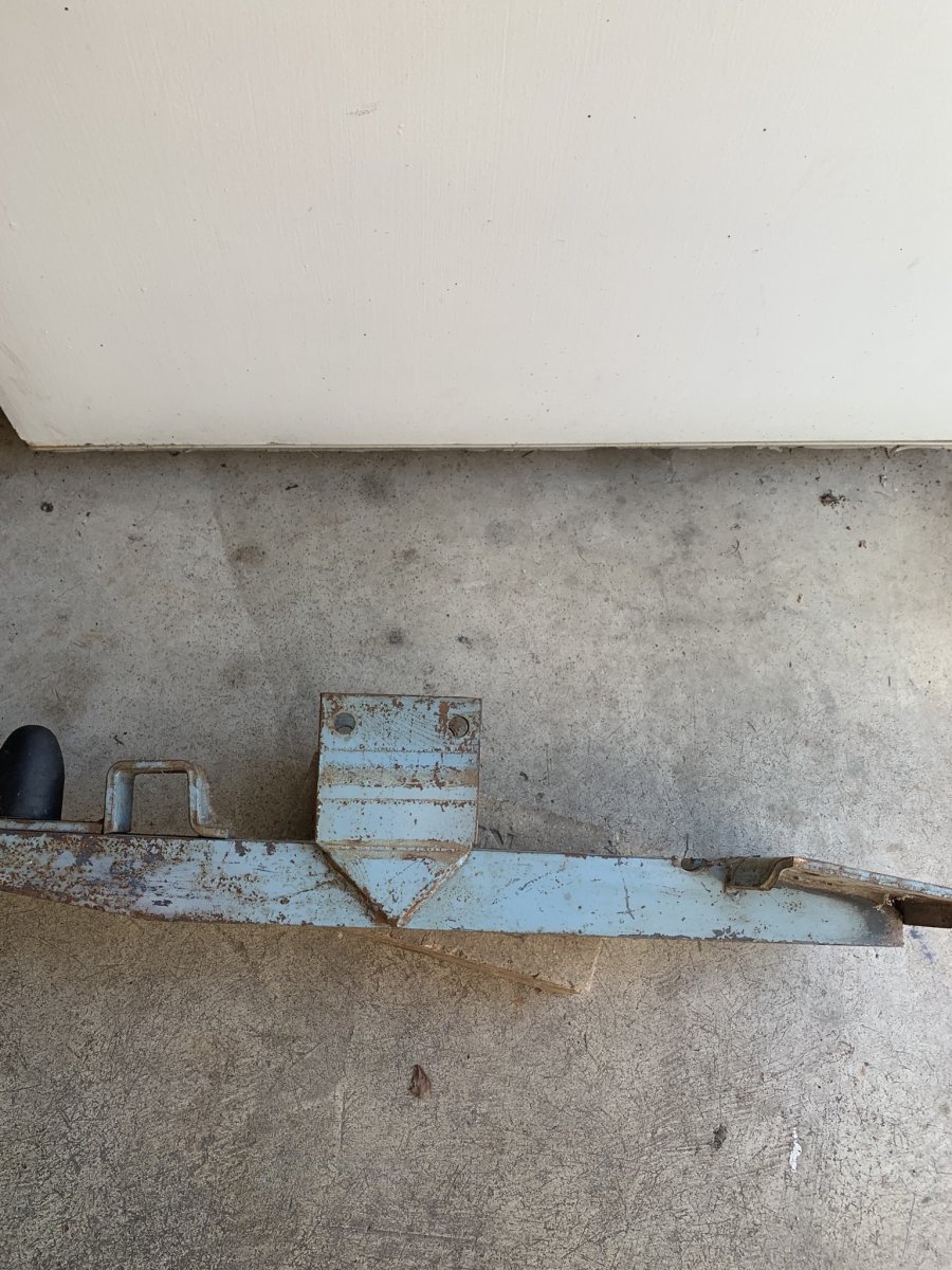

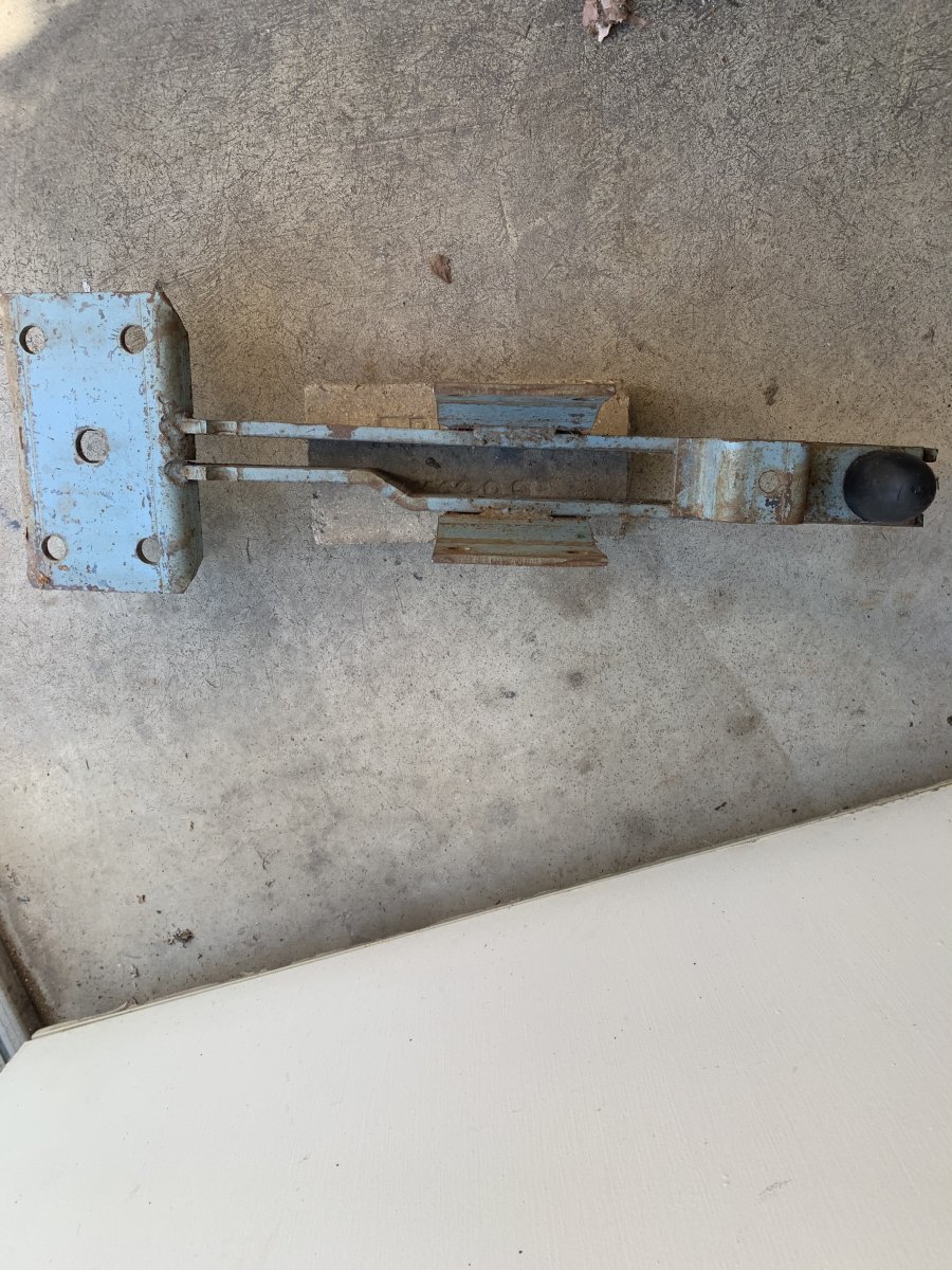

  20. bowie
    Joined: Jul 27, 2011
    Posts: 3,220
    bowie
    Since the thread ***le says”early “ Vettes... here’s a not often seen goodie for *****foot rear problems: 73315293-385A-4BB9-B1D4-1C75DAD7408F.jpeg 42A3377F-F647-4207-BF6B-6365E0234F65.jpeg 2F7D9EC0-4429-4B36-BBA1-3810619A21C8.jpeg 7D3D5B2B-85BD-40AE-A8D3-A8B5FE57FCDE.jpeg
    Deuces, 31hotrodguy, loudbang and 3 others like this.
  21. vetrod62
    Joined: Jan 2, 2010
    Posts: 347
    vetrod62
    Hi Jim D. ,I think the forward mounting point is to try to get more lift out of the bars. It does not look like the rear housing would be bolted to the springs secure enough. I do not like it. When you blast off the line, a lot of violence is happening back there. (Tip....replace the stock 7/16 U-bolts with 1/2" bolts) Also get new heavy duty saddles, the stock ones are to weak and will bend, besides they will probably be at the wrong angle to the drive shaft.
    Clamping the leaf springs with extra u-bolts is an attempt to lessen the spring wrap-up. It further binds the rear suspension.
    The technology and theory of the bars is to take the rotation of the rear axle and use that torque to lift the entire car, thus forcing the rear axle downward to have more energy placed on the rear tires and try to move toward the ICs .
    Not a lot of adjustability with bars, unlike 4-links and adjustable ladder bars. The only adjustments are on snubber bars is where to contact the rubber cushons and the air gap. On my car no air gap and pre-loaded. Jim
    Tickety Boo, Deuces, Hren59 and 5 others like this.

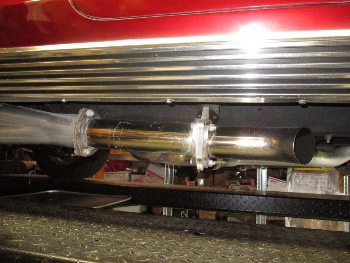

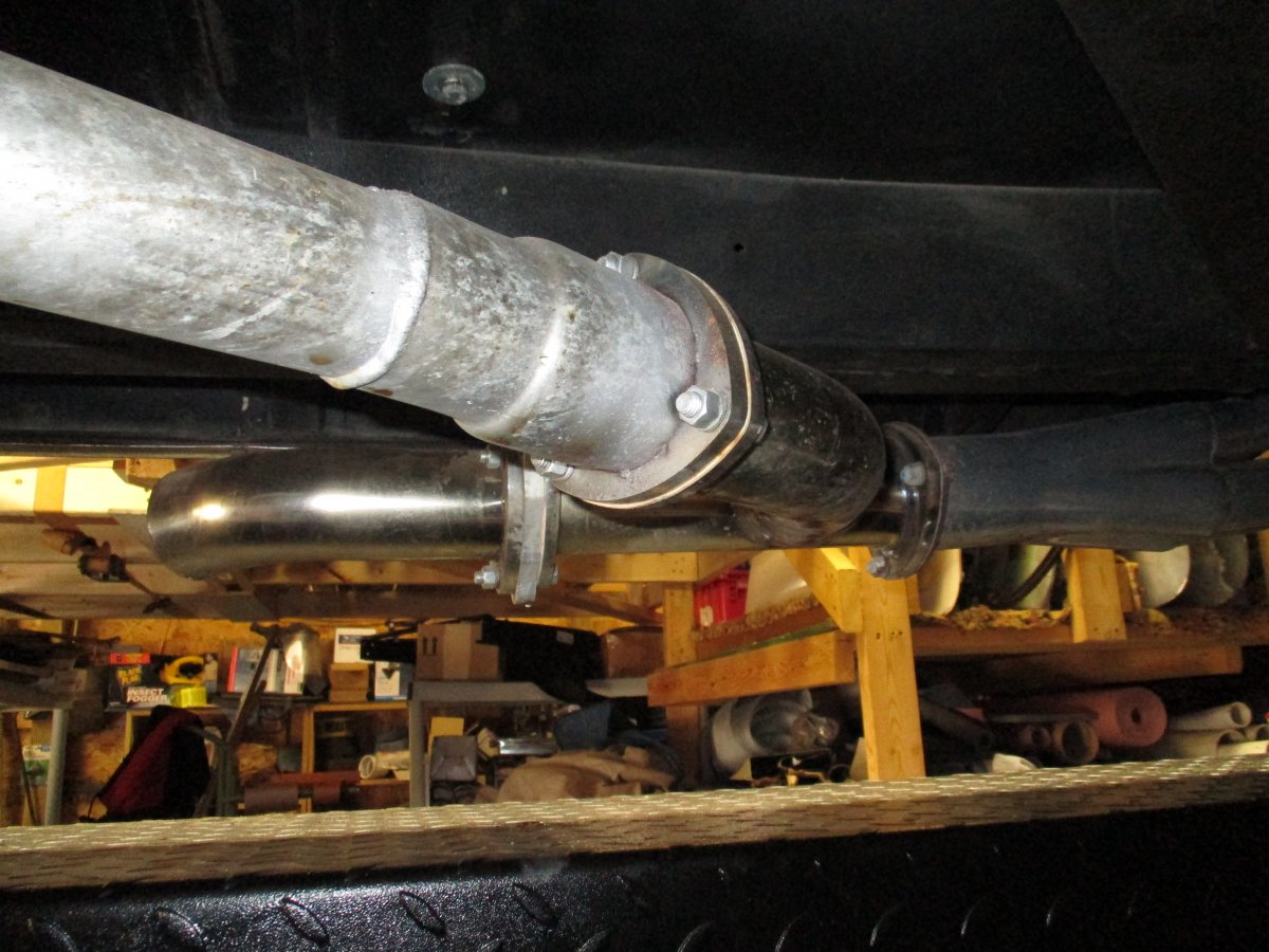

    Colin here are a few pictures of the exhaust I spoke of in an earlier post. I originally had a small muffler behind the header and it was way too loud. You can see the turbo mufflers are tucked up pretty good in the stock location and they quiet the car down considerably. I can crack open the electric cutouts to adjust to the amount of noise desired on a particular day. There have been times on Woodward where I have opened the cutouts all the way and you cannot go too long without ear plugs. The piece directly behind the header is a couple of pieces of stainless I bought from Summit-straight 3" and some y-style pipes that I welded up. I wanted a flange under the car so I could remove that section and install the collector when I have run it at the track. Pretty easy to change out the y-pipe section to the collector and the pipes left in the car are pretty solid-they do not bang around. I believe the pieces are Pypes brand but cannot swear to it without looking at my build book. I know I bought them from Summit though and the stainless are 3" and is real easy to weld with a mig and mild steel wire. Not sure how much depth to go into as you can get the idea and your application will require a different yet maybe a similar approach. I do not believe the pipes hang down too low and they are at pretty much the same height as the ******* bars anyways.
    Sorry some of the pipes are dirty-I clean the car pretty good in spring and then concentrate more on driving it so there is a bit of dirt here and there.

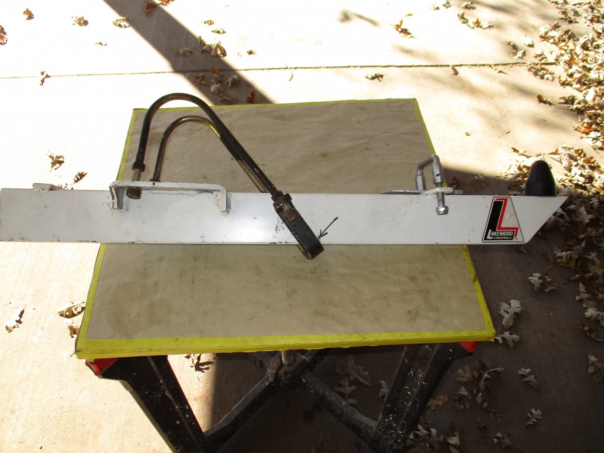

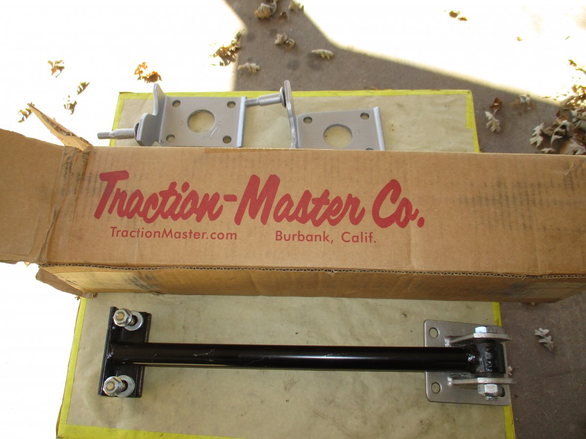

    Although Jim has explained the negative limitations of Traction Masters and I believe his opinion, for whatever it is worth Scott brought up the issue and throwing it out for whatever it is worth. Back in the early 60s the Vettes used Traction Masters and were reasonably successful. If they had known more about instant center, they most likely would have used ******* bars. I am amazed to be honest that both 283 and 327 Vettes ran in the 12s in 1962. The tires were junk and they used Traction Masters. The B/SP cl*** winner at the 62 Winternationals Gr***man-Nicholson-Wade 315 HP 1961 Vette still has the original Traction Masters still on the car.
    I had ******* bars on my "stock" black 62 but when I ran in the Uncle Sam's Pie Eating event the organizers (the Meltdown crew) felt ******* bars were "too new" and would allow Traction Masters. I ordered a set of Traction Masters for the event but it was getting close to the event and had not received them so I made my own. The car does not have that much power that it makes a world of difference but I probably had more fun at that event than any event in recent memory. I had at least 7 and maybe 8 runs. Good memories. Here is a picture of the ones I made and the new ones that eventually were shipped. They make two different types. There are the ones where the front mount is welded on (like the Gr***man car which is now owned by Dan Hamption, who also owns "The Pizza Man" Corvette record holder) and the bolt on type like I ordered. Just thought Scott may appreciate the pictures.
    Here are the ******* bars I had on the black car. Kind of funny in that I bought some Lakewood stickers but they were too big for the ******* bars so I made these ******* bars with a tube big enough to fit the stickers. I plan to use them on the next project and had these J-bolts or forward leaning bolts but not sure if I should use regular u-bolts of the j-bolts. Jim do you believe there is a problem with using the j-bolts? Is one more stiff on the street? Just curious as I have to weld a little angle where I have the arrow and not sure which way to go.
    Here are the Traction Masters I made on the black car.
    Here are the new ones I got from Traction Masters.
    Here is the ******* bars that I mad to fit the stickers (LOL). V red 1020 012.JPG
    Here is a picture that some professional photographer took at the Pie Crust event to make it look like it was back in time. It was on the Meltdown Drags website at the time. Credit to the photographer on the lower left corner.

    Jim Dillion I really like how you have configured your exhaust. Thanks for the pictures.
