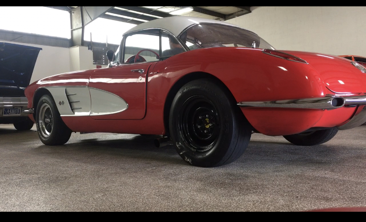

  18. Hren59
    Joined: Dec 27, 2012
    Posts: 120
    Hren59
    Wow great thread, I hope to one day modify this ‘60 for respectable 1/8 mile p***es at the local track. Should be mostly work on the rear end and suspension. Engine is aluminum head solid lifter 383, w/ autogear M22 and runs very hard

  19. lumpy 63
    Joined: Aug 2, 2010
    Posts: 3,361
    lumpy 63
    Very nice ! I remember watching your avatar at Barona. Barona is where I will be testing my Vette when running.

  20. Hren59
    Posts: 120
    Hren59
    I look forward to seeing your Vette out there. My main focus is on the Chevelle in my avatar and I have been chipping away at getting it faster for a while now. Always a delicate balance between budget, wanting to go fast and also not wanting to break my main driver
