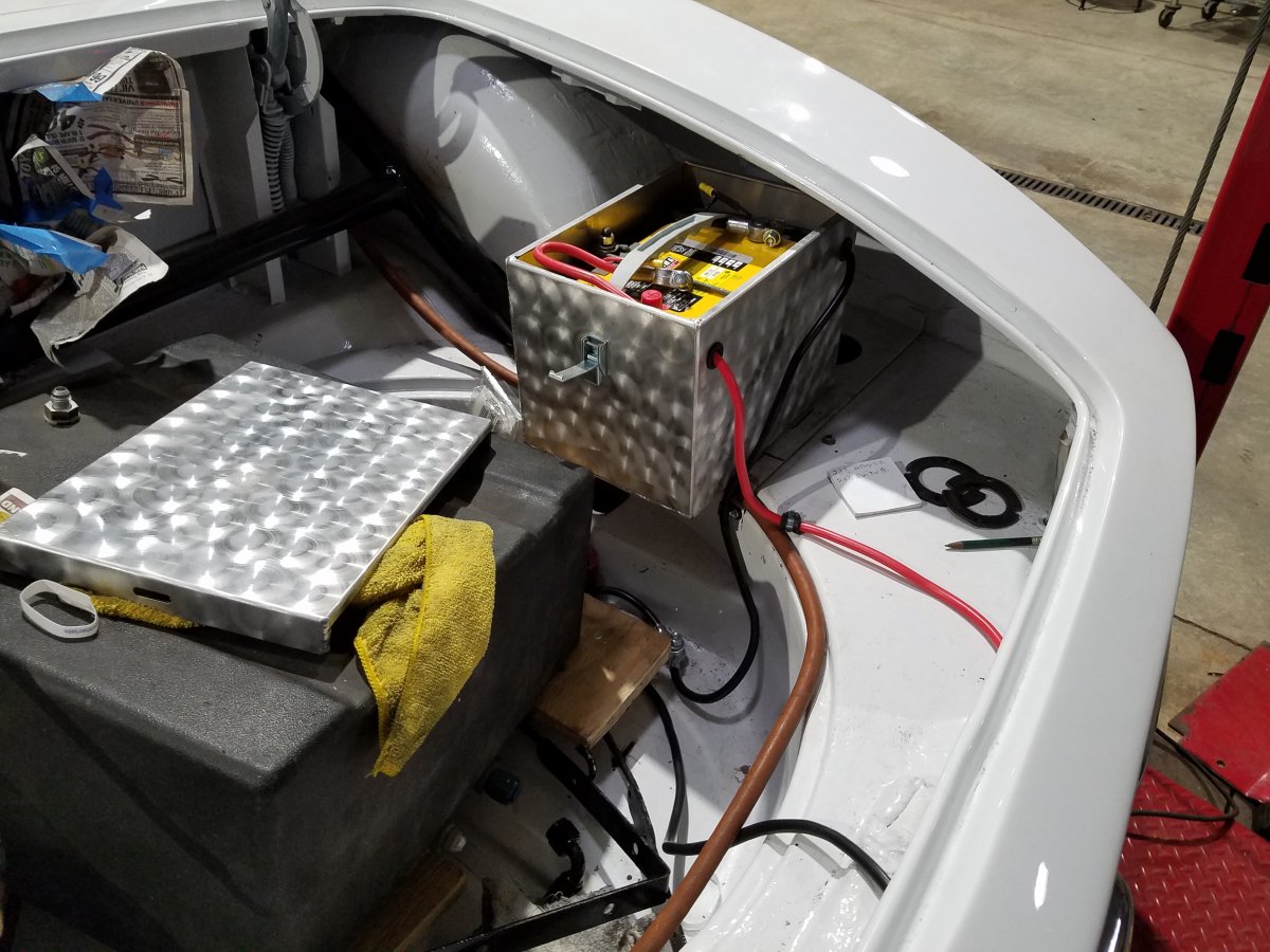

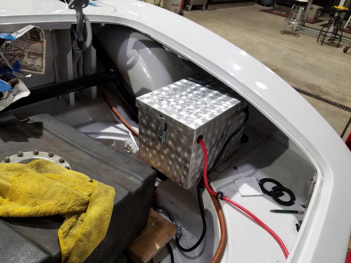

    If you mount you battery in the trunk there is not much room under the quarter panels. My fuel cell is 5 or 6 gal.. And not enought room for the battery in the spare tire compartment. I had to cut 2 in. Off the battery box to make it fit. 20190913_090822.jpg 20190913_090842.jpg 20190913_090822.jpg

  16. vetrod62
    Joined: Jan 2, 2010
    Posts: 347
    vetrod62
    and to Gearheadsqce, and Dueces( Yes, that is very tight, and you have to watch out if it is bored too thin, it will over heat,).
    Well Stephen, you know one now. It is not for the timid and weak. Do it wrong and $2500 block in the trash. That should be enough of a clue to figure it out. This is going to be fun. My car runs a 3.48" stroke, up that to 3.76" and you have a 427. I built this engine 17 years ago and it is still running strong.
  17. vetrod62
    Joined: Jan 2, 2010
    Posts: 347
    vetrod62

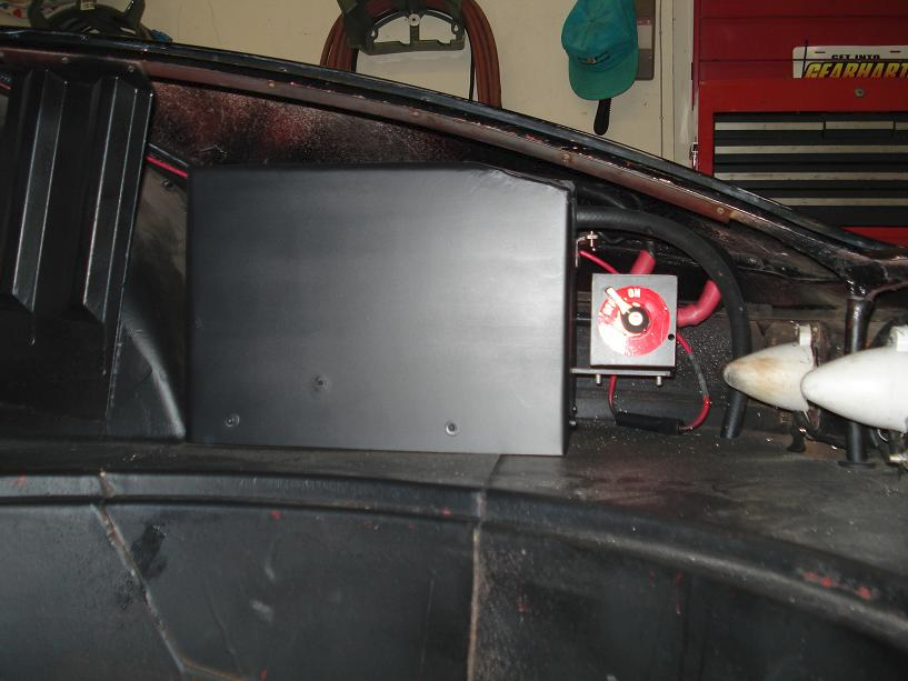

    I made my own, shaped to fit under the fender. Not easy to change the battery.
