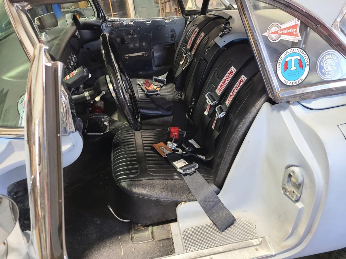

    Saw some one post a picture of their cross bar running straight across the back. I you plan on running stock seats or are fairly tall, I would recommend bending the crossbar like mine in my 57. Corvetterollbar2_zps457476ba.jpg 003.jpg 20200425_113022.jpg
    Elcohaulic, lumpy 63, Hren59 and 7 others like this.
  7. Stephen Baxter
    Joined: Sep 10, 2019
    Posts: 34
    Stephen Baxter
    Yep I wish I had bent mine and angled the roll bar back a little more. I am 5' 10 and I have enought room just nothing extra. 20191023_164816.jpg 20191023_164715.jpg 20191023_164754.jpg I also have a swing out bar.

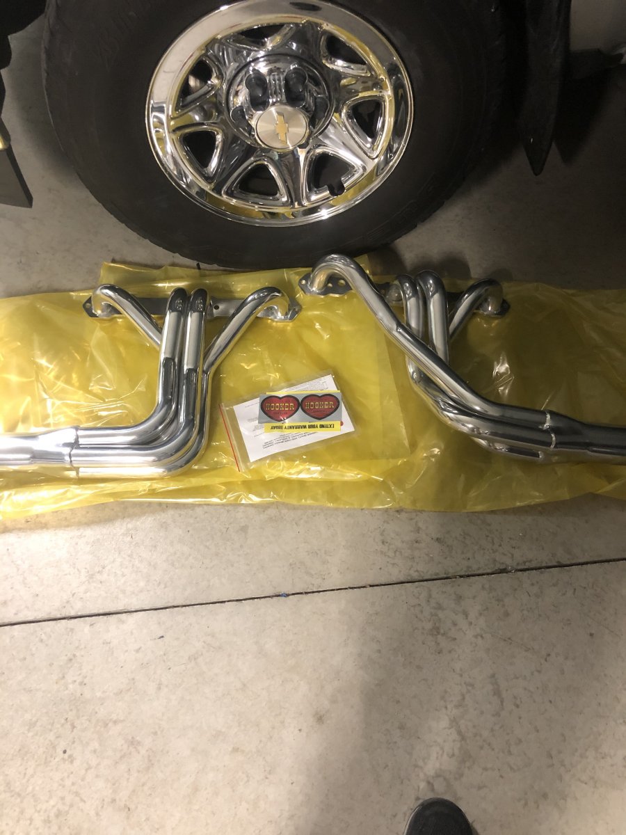

  11. 5808BEAE-973A-4FFB-9BD5-1E55203FC960.jpeg I happen to know where there is a set of used
    ****** 2456‑1hkr headers. Just sayin’
    They look like these just not as purty:D

    My roll bar came from S & W Racecars. I had them custom bend the cross bar so I could use the stock seats after I saw how much space I was going to lose.. I forget how much they charged for the new bar, but it wasn't to pricey. They leave it long so you have to notch it to fit where you want it to. Kind of a "one shot deal". I made one out of exhaust pipe for a pattern and transferred the measurements to the new bar. Take's all the guess work right out of it. 20150516_130105 (1).jpg 20150515_155821 (2).jpg Corvette roll bar through back window..jpg

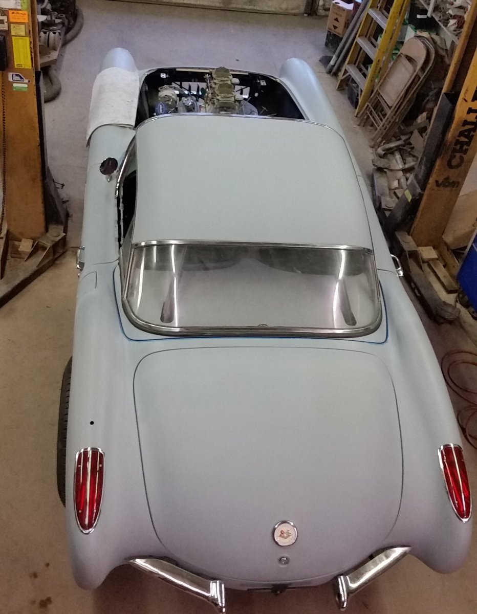

    Been a little side tracked with other projects and shop work lately... I'm really digging the roll bar pics. I bought a JD squared bender a little while ago , gonna give it a workout:D Keep the input and pics coming. Thanks Guys.

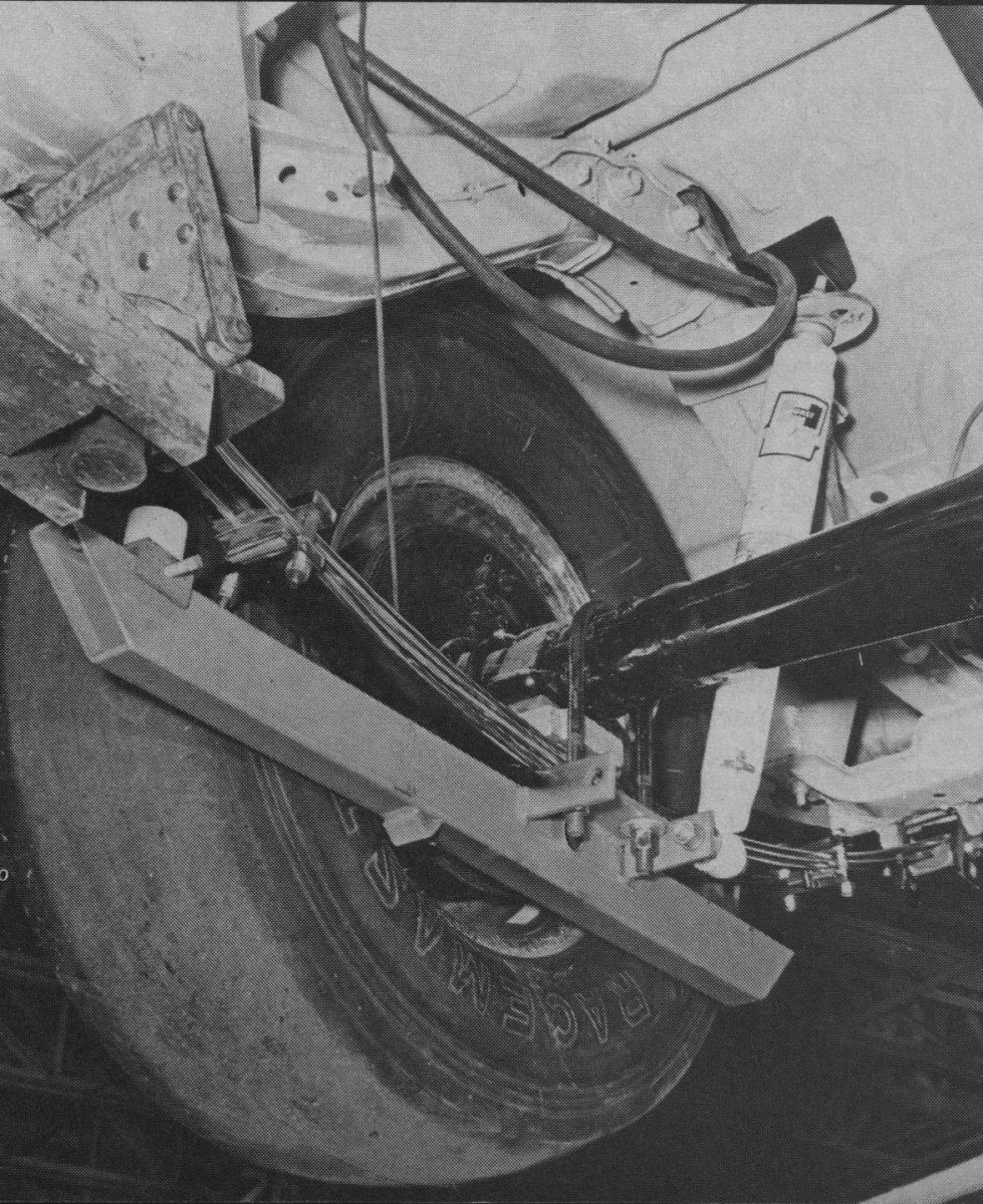

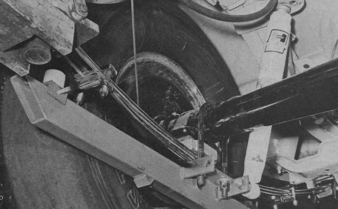

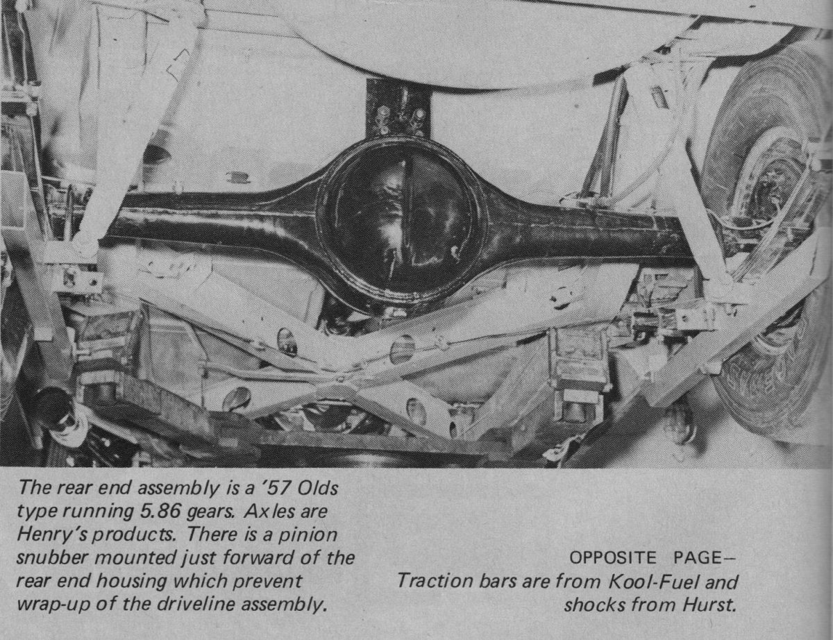

  23. jimdillon
    Joined: Dec 6, 2005
    Posts: 3,321
    jimdillon
    Just throwing out some food for thought. Some guys want to use ladder bars and others may even use a four link but many of us want to use ******* bars or traction bars. Of course when we purchase a set of traction bars we get what is packed in the box and install them on the car often with little thought. I have heard that the snubber should hit just short of the spring eye and even some say to let it hit the spring eye itself. I would imagine others would also have a different opinion. I am attaching an article from July 1973 Popular Hot Rodding on Ken Adams 1962 Vette. I am including the whole article but have blown up the picture showing how he installed his traction bars. It appears that he clamped the spring and has the snubber hitting outside the spring leaf itself, unless my eyes have gone bad or mind is playing tricks. I imagine he could have a plate mounted that I cannot see in the photo.
    It made me wonder if there would be any advantage to such engineering, which of course would include modification to the mounting plate itself? Just curious?

    Hi JimD, A few observations from the photos.
    That rear axle housing looks to be rotating like mine, but not as much. Meaning the subber bars are working. Look at the crush of the left rear tire and slight rotation of the rear housing. I am sure that has some effect from the the extra rear mounts on the engine to frame. Mounting the engine and trans at 3 points is looking to break the transmission in half.
    Several things wrong with the bar/ spring pictures. First shooting the pictures with the rear axle not under load tells you nothing. Second, having the lift obscuring the final position of the subber is worthless. The rear springs look weird, 3 leafs to the rear, and 5 leafs to the front, including 2 half springs. makes no sense.
    I think the photos of the rear/bars are a photo illusion. No one would move the rear springs or the snubber contact outward, because there is little enough room for tires in the wheel wells to give up any space for that. Jim

  26. loudbang
    Posts: 40,346
    What I want to know is why if he is using ******* bars why does he ALSO have a "Pinion snubber" to prevent "wrap up" of the driveline ***embly. For the *******s to work there has to be some "Wrap up"??

  30. vetrod62
    Joined: Jan 2, 2010
    Posts: 347
    vetrod62
    I do not get the snubber thing, my car at launch raises the entire rear of the car at least 4", well out of the range of the pinon snubber bracket. Maybe he needed better springs?
