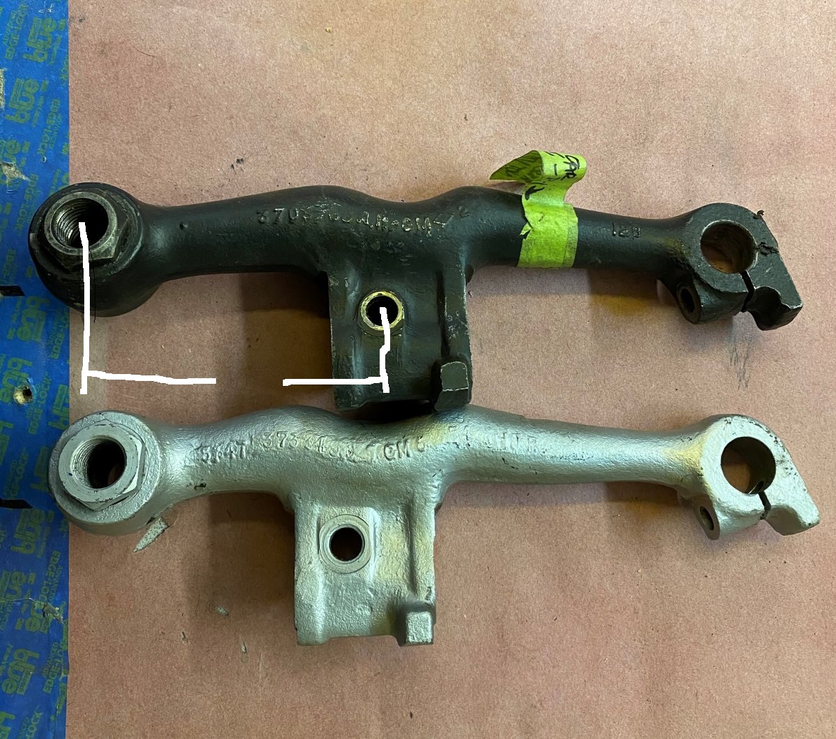

    Hi Guys, Jim's picture shows Corvette upright vs 1953-54 p***enger car.
    1953-62 Corvette are forged # 3733449 left, 3733450 right
    1949-52 p***enger # 3687651 left, 3687652 right
    1953-54 p***enger # 3703785 left, 3703786 right
    1953-54 p***enger are commonly used to lower 1949-52 p***enger (and I now know Corvette), I don't know how a 1949-52 p***enger car upright compares to Corvette?

    @jimdillon,
    I knew that it was the upright but called it the spindle. Thanx for pointing that out.
    Can you give the dimension shown?
    31hotrodguy and loudbang like this.

  8. jimdillon
    Joined: Dec 6, 2005
    Posts: 3,321
    jimdillon
    Bruce I will measure it tomorrow..

  13. jimdillon
    Joined: Dec 6, 2005
    Posts: 3,321
    jimdillon
    Bruce I measured centerline to centerline and the black one measures 4 3/8" and the silver measures 3 5/8", for a difference of 3/4". Just for the record I am not sure what year the black support is from as my knowledge on lowering these cars is extremely limited. If I have any knowledge, it is in the other direction with raising the stance.
