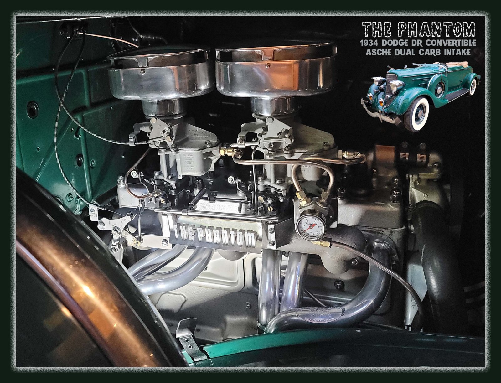

  16. Semmerling
    Joined: Jan 6, 2022
    Posts: 30
    Semmerling
    hamb 1.jpg You folks were very kind to me in all the responses. I went to work and finished up the engine after a couple of years. It runs perfectly and, well its a brand new car in regard to performance. Now I could go on and on and on about what works and what doesn't on this build. Let me know what you want to know and I'll do my best to give you a full response. To all that took the time....thanks!
