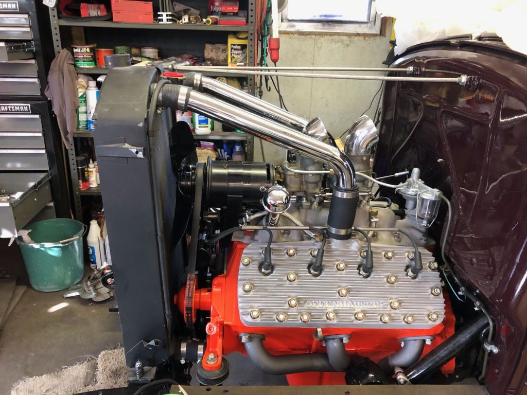

    plugs.jpg I'm running a 60's Ford generator with a 37 fan and pulley on my 8BA, will be interesting to see if I have bearing problems. Only have about 70 miles on it right now, ran the same set up on a GM one wire alternator on my avatar with no problems years ago.

    while i have no personnel experience with the bearing size of a delco unit, i think many of the stories we hear about fans flying thru the hood are from modern alternators, and not old ford stuff. again, my opinion, no facts to back me up. so is it the metallurgy of the shafts, or the bearings? take a guess, thats all we can do. back to the original question, what 2 brush can hold a fan. i think we need to know more about the bearing on the big shaft later generators. as i said before, same part # in the bible, but not true if the shaft is bigger. another identifying tip would be the nut size on the end of the 32-36 takes a 9 1/6" wrench, the later big shaft nut takes a 3/4" wrench if i remember, noticeably larger. mac vanpelt chimed in the last time this topic came up, perhaps he will see this

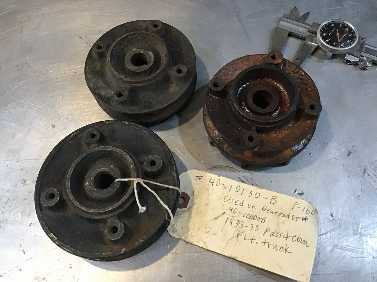

    A few pictures of the different pullies as well and you can see the one pulley has the .656 or 21/32 diameter hole. image.jpg

  21. Just to add to the confusion, they used to sell aftermarket fan mount pulleys which fit on to the shaft of the '40 -'48 2-brush generators. Those aftermarket pulleys allowed the modification of readily available 2-brush generators to mount a fan. I have at least one of those pulleys that is not up to the usual Ford quality.

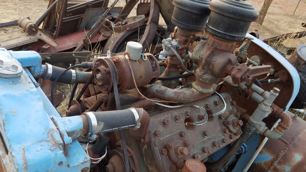

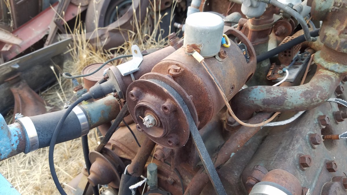

    I was moving some of my gold (junk) today near my 1940 Ford V/8 air compressor and since I was near, as I do now and then, I turned the crank mounted fan to keep the rings from sticking. But before that I noticed something. It has an early 3 brush generator with a fan mount pulley! Doesn't need it either as it has the crank fan. I will switch it out and use it 'til I find a '39 gen with fan mount.
    BTW, this air compressor runs great. 4 cylinders gas and 4 cylinders air. It was a factory made conversion. Little short straight pipes pointed up sure make a racket! been a couple 3 years since I've run it.

    a couple observations from me. that seems odd that it has no holes in the front plate for cooling. cooling is important, and quite often the death of the 3 brush units if they are set up on the high end of charge rate. and, it looks to be the large pulley diameter which will give you slow fan speed, and not much charge happening at low rpm's. may be ok if you do a lot of highway driving and not so much on secondary roads or cities. i forget if you mentioned, but what are you running for lights? any other needs for big power? also, note the holes in the photo of all the gennys on the back of my honda.

    @rusty valley , you are right, I see no air holes! Car in question is a '32 Ford Fordor with a later flathead V/8. Either a 59A or an 8ba with 59A heads, etc. 7" sealed beams in BLC headlights, '39 tail lights, hyd brakes, '36 trans, '32 rear. No accessories. Will be a road car so the big pulley doesn't scare me, especially with the 4.11 gears!
