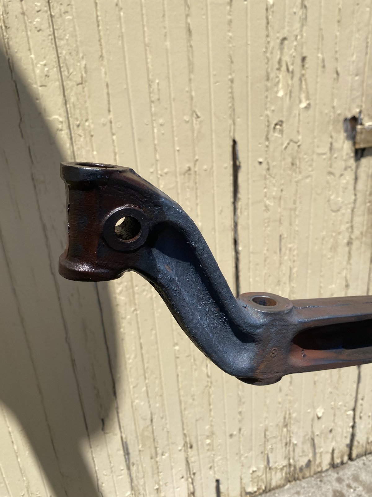

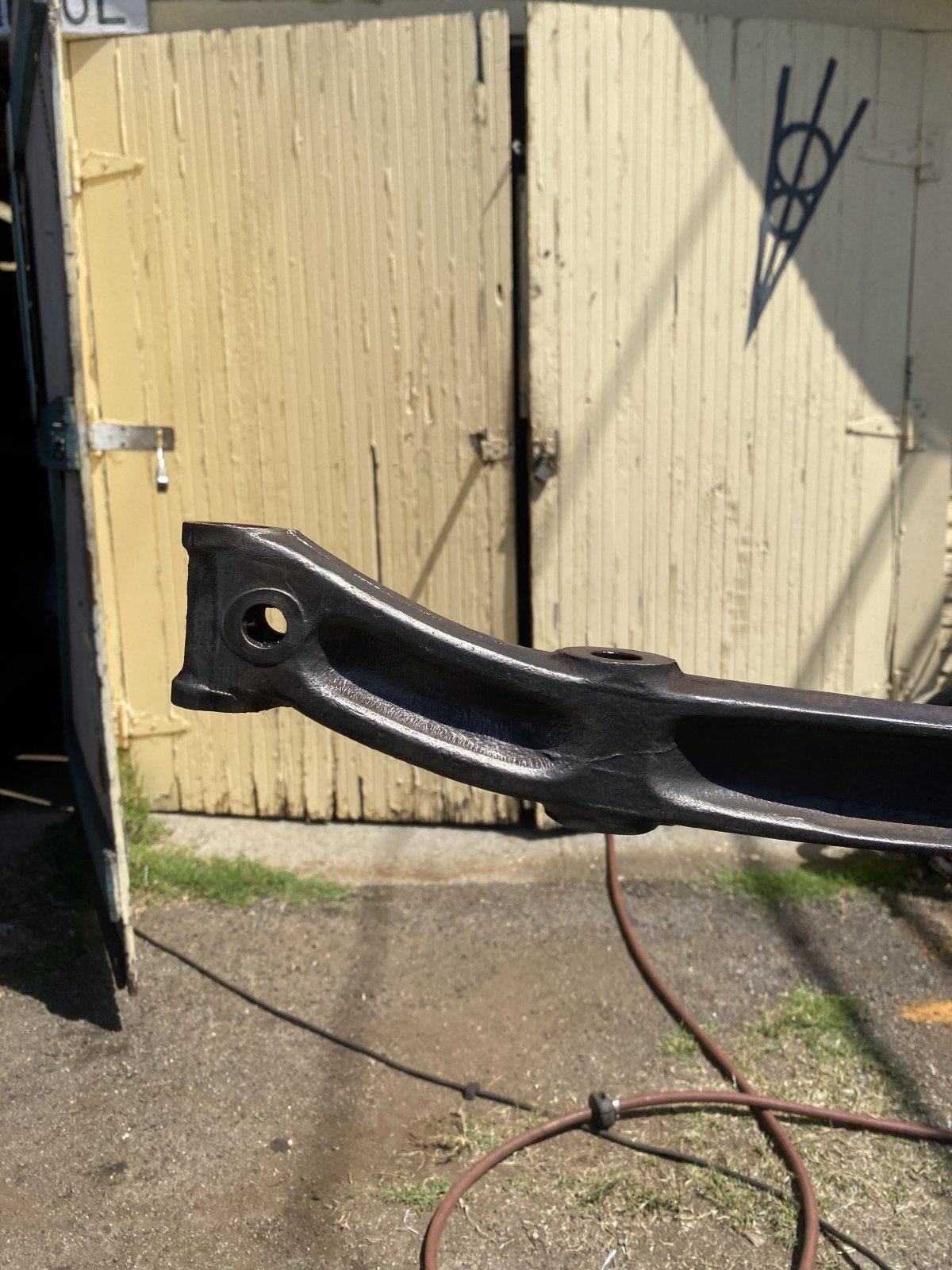

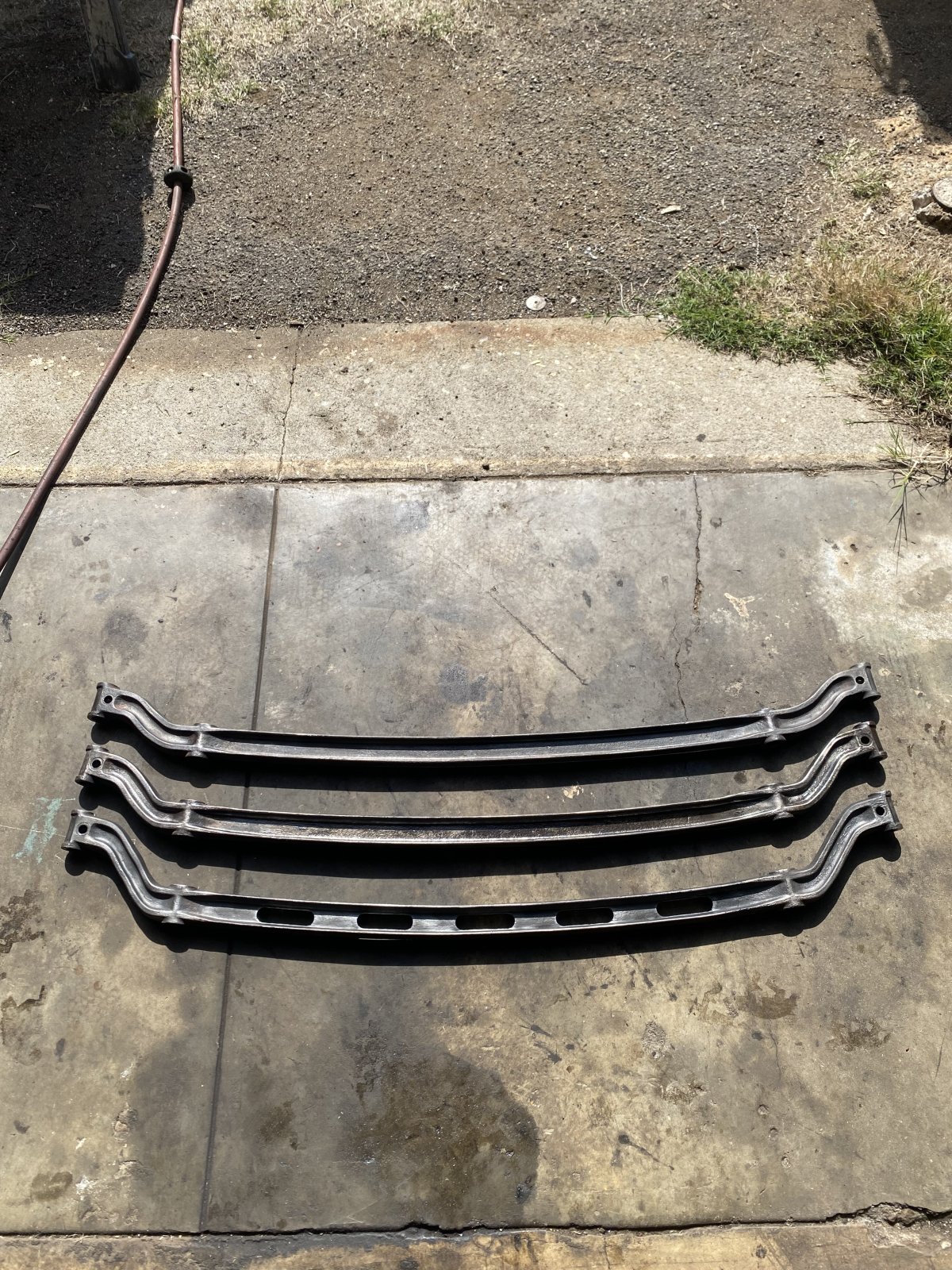

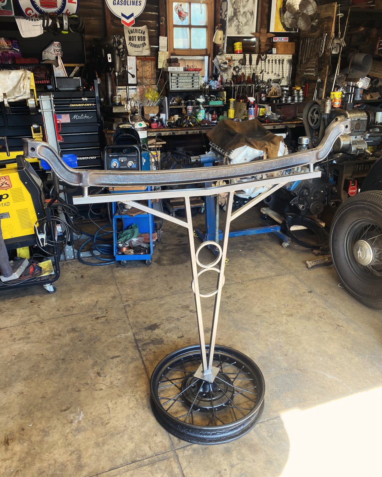

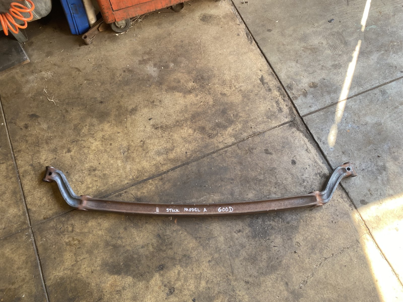

    IMG_3841.jpeg B2ACB997-5B67-437B-9137-34A496FAF3B7.jpeg IMG_3564.jpeg IMG_3530.jpeg E544E0A7-79E1-4771-8A7D-E7034A41BA13.jpeg FA077E77-1A87-4402-81DB-E00F71AB22F2.jpeg IMG_3294.jpeg IMG_3298.jpeg 8FC09D81-D552-47ED-A16A-C5CC0426C1EB.jpeg 72955324749__0CDEB000-9CD7-4E2E-A32D-2F964DCF8A56.jpeg IMG_3041.jpeg IMG_2769.jpeg IMG_2766.jpeg Early Ford Axles dropped in So Cal if anyone is interested. I do at the moment axles up to 4” from Model A stock from 1928 to 1936. (37-up axle drops coming soon). Current Price is $200 a drop and includes some straightening (for typical forward and aft bowing) , holes cleaned up.
    Axles with twist or vertical bends prices will vary and will need photos. I also ask please that axle is somewhat cleaned and freed of years of crud / rust. I wire wheel the ends where the drop will take place but that’s it. The rest of the axle can be wire wheeled / cleaned at extra cost. Shipping cost not included. Typical turnaround is 1-2 weeks from received. I can be reached at..

    See attached photos of some of the axles I’ve done .

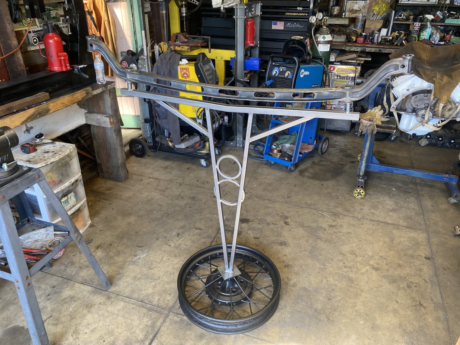

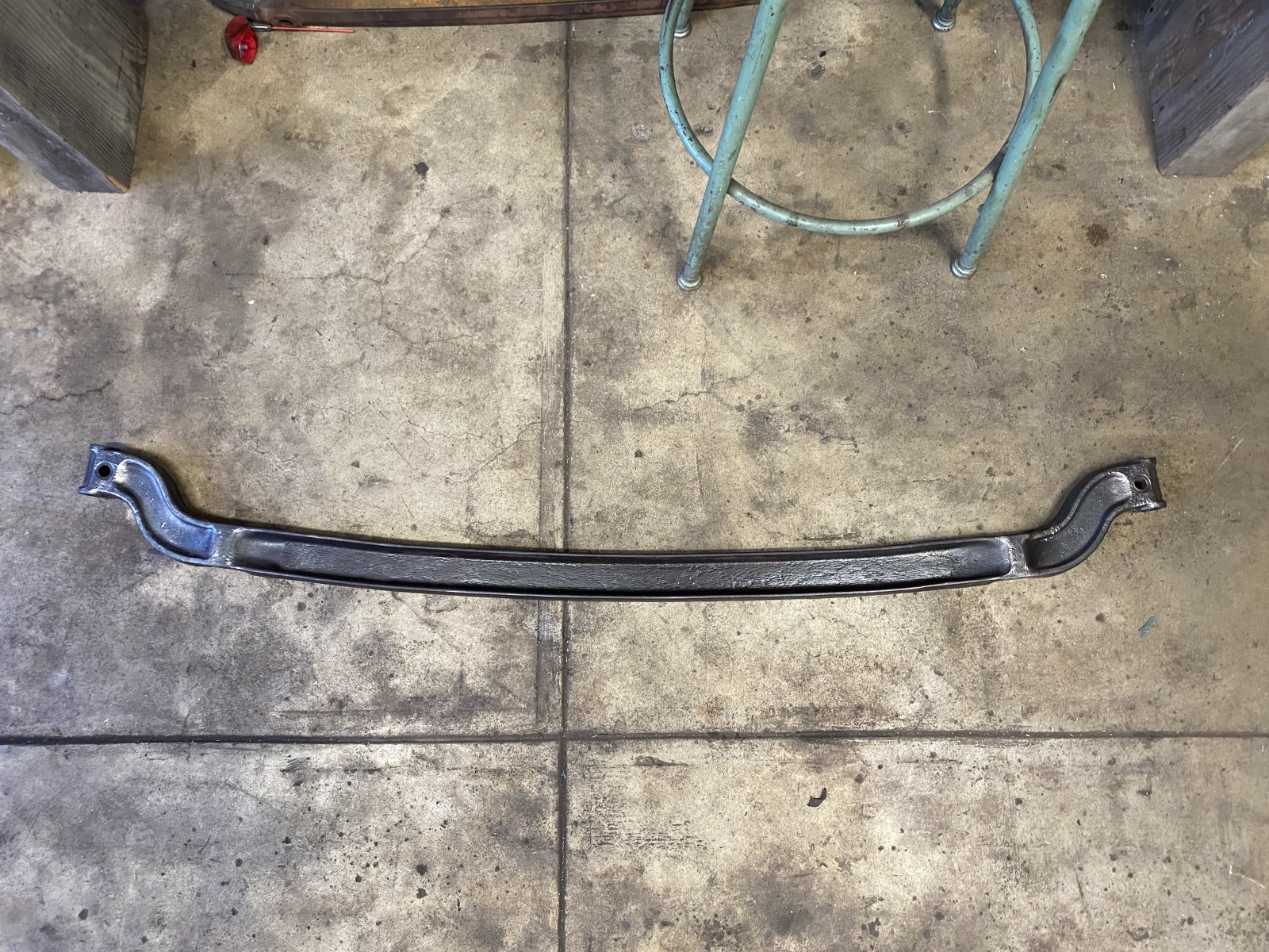

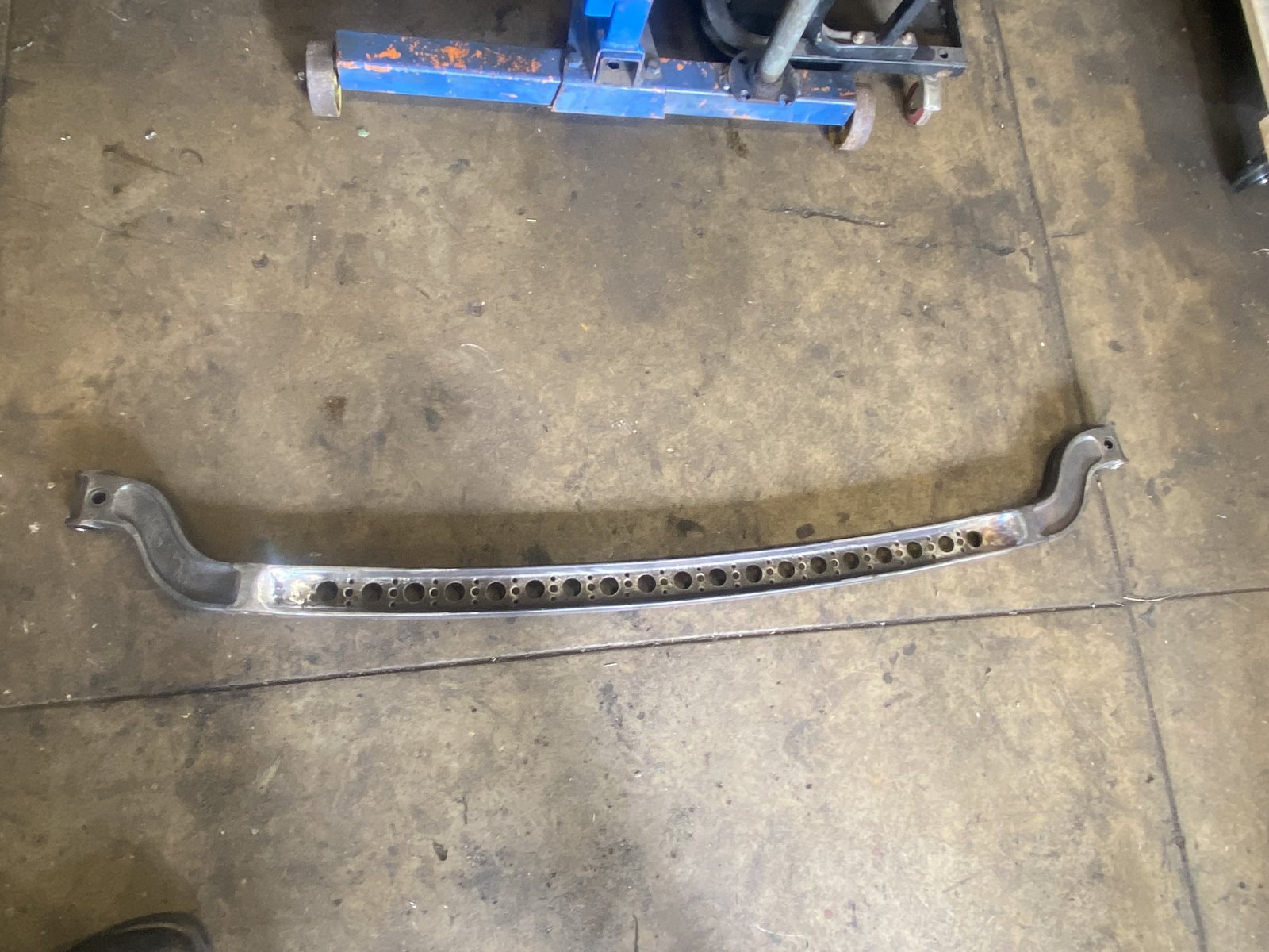

    IMG_3861.jpeg IMG_3862.jpeg IMG_3863.jpeg IMG_3864.jpeg IMG_3865.jpeg IMG_3866.jpeg IMG_3867.jpeg Today I cleaned up a crusty ol’ 37-41 axle I had laying around and was able to finally drop it . Here’s the before and after with a 4”.

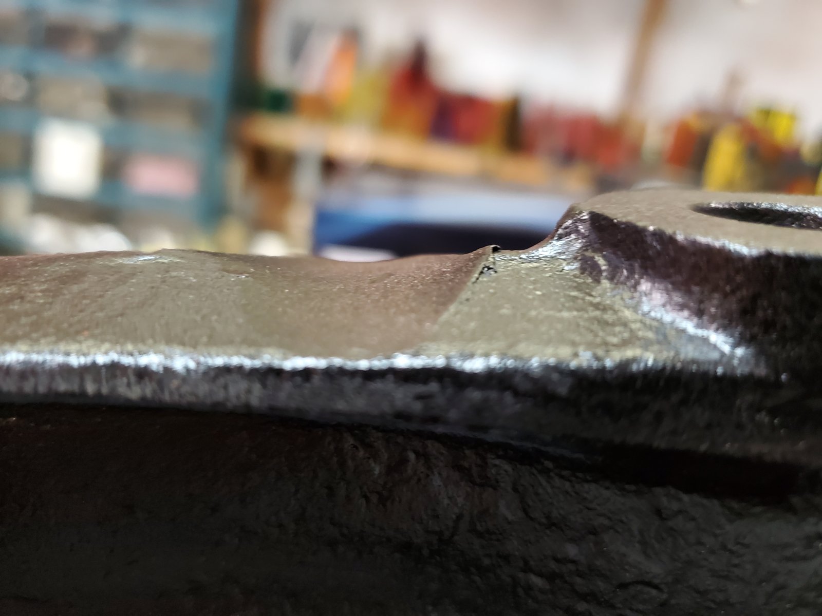

    ......a couple years ago I sent off a real nice stock axle to a fella in the state south of me. I wanted a 3 inch drop. I didn't get my original nice axle back, but instead was greeted by this when I unwrapped it.
    20211230_094302 (2).jpg 20211230_094335.jpg 20211230_095612.jpg 20211230_095723.jpg 20211230_095000.jpg
    Not sure if he was trying to pull a fast one, but I contacted him and got my original axle back with a 3 inch drop, but the camber is off a couple degrees on one side. I am reluctant to do any more business with them.
    @Gearhead79 I'll likely contact you in a month or so, and ship you an axle to be done right.

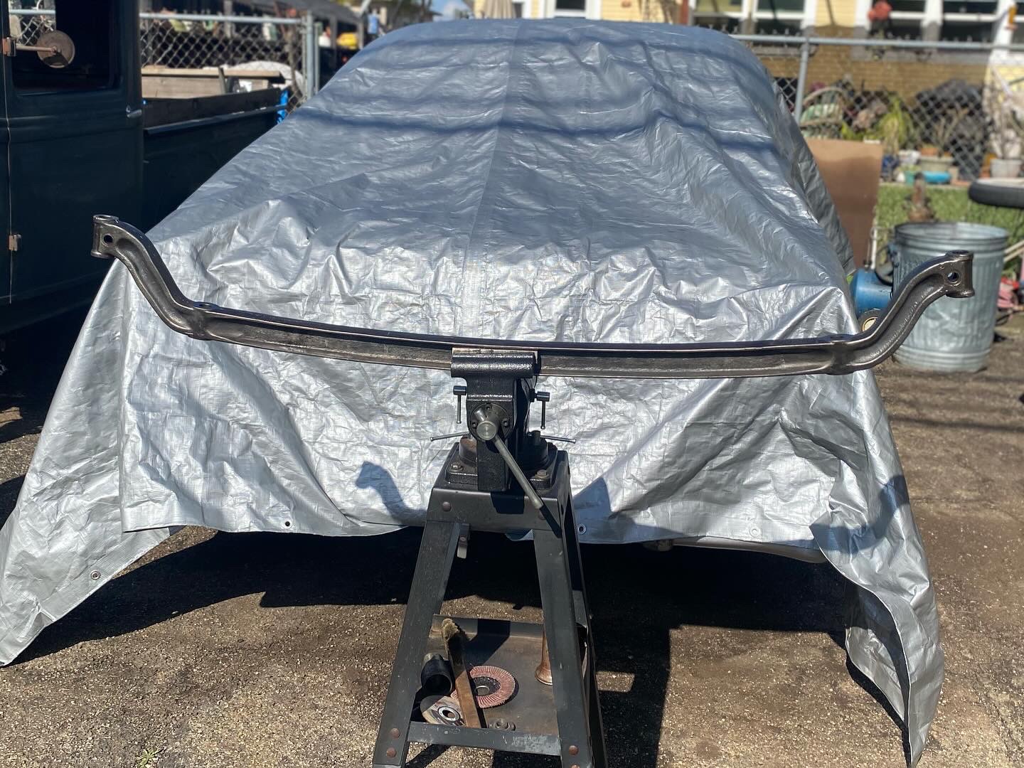

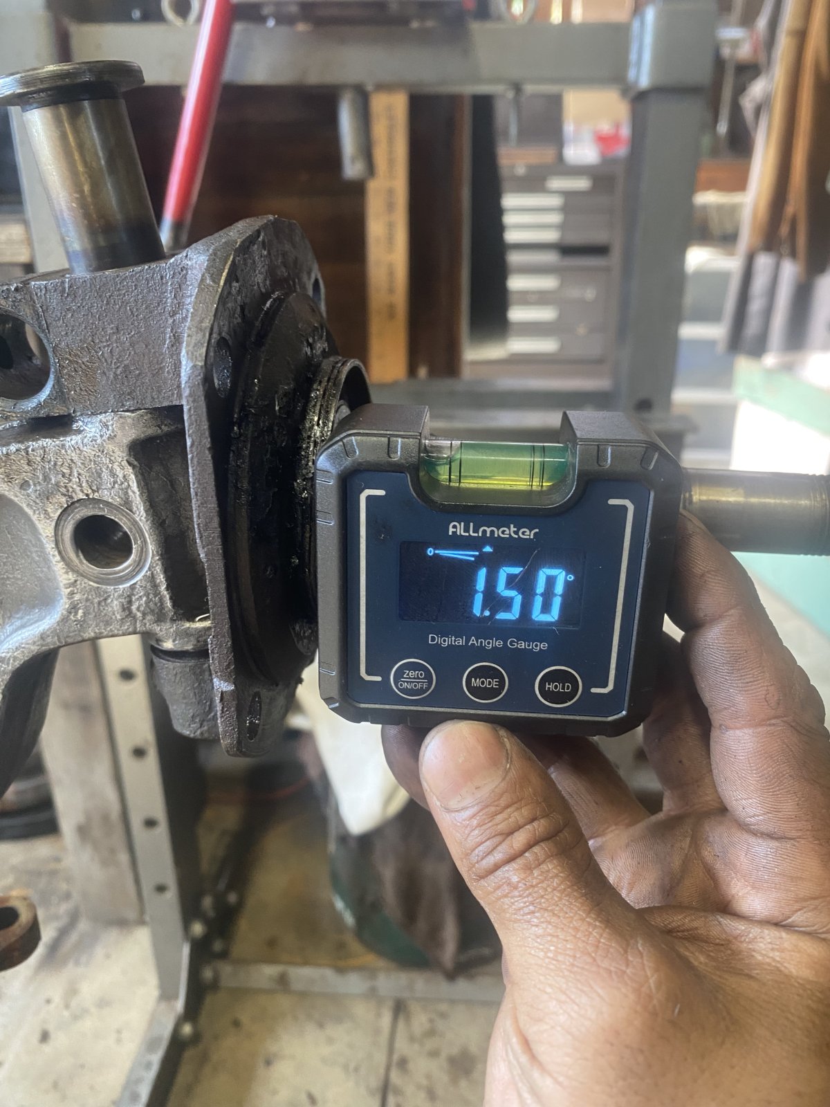

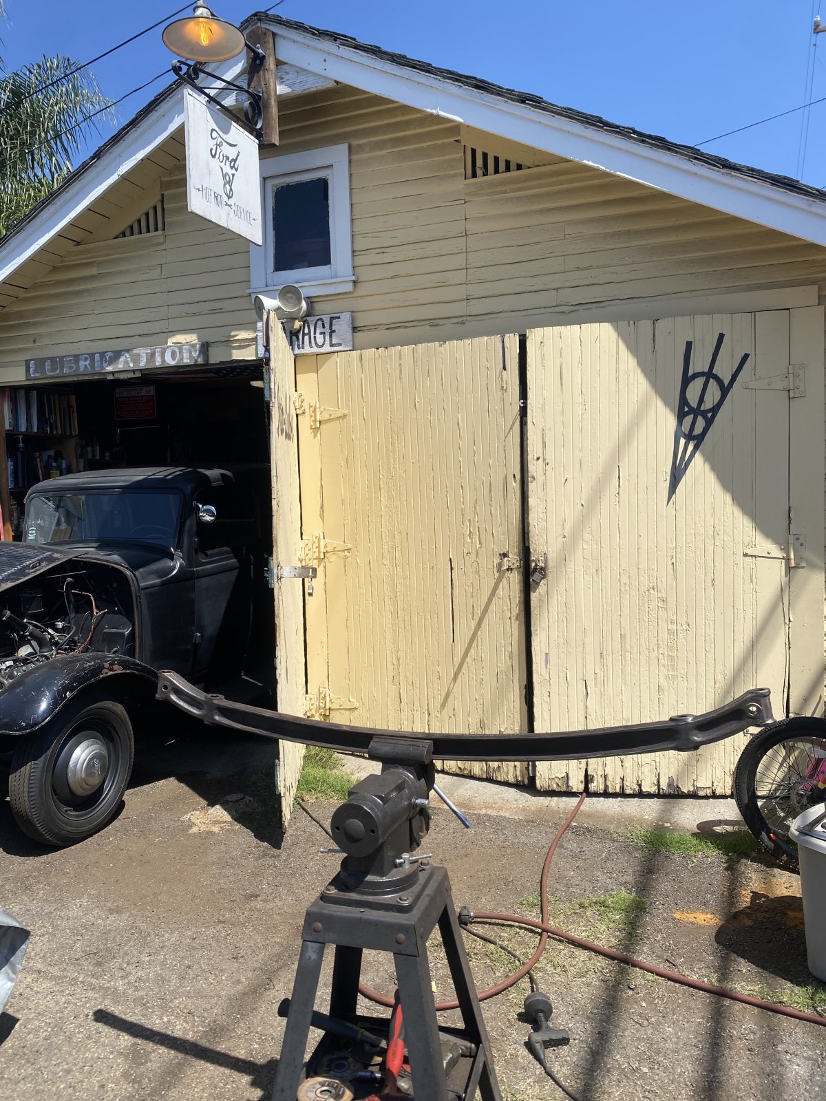

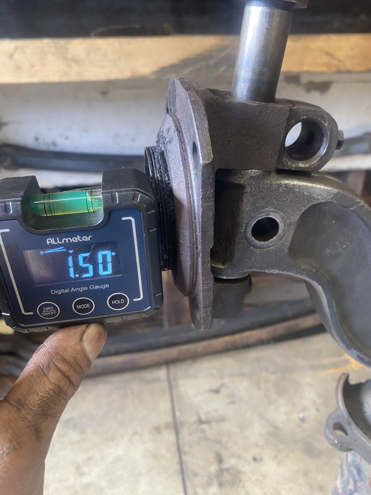

    Just to add to my original post, all my axles get dropped in the 1 1/2 postive camber area. Ford did them between 1.0 and 2.0 and I don’t think I’ve ever seen one out of this area of camber unless bent. My jig is not set up for anything else. I believe the reasoning for the postive camber was to facilitate steering on the rough roads of the time. Personally I like the look of slight positive camber thus why I stuck to it. Some guys like them at 0 degrees but getting this is too difficult for my press at this time. Not an option for the initial drop. Achieving exactly the same on both sides can be a challenge but I aim for identical symmetry . Some of the axles I receive are way way off this initial camber being bent over the years and I spend time getting them as close before dropping. After I drop them I adjust them on a press if necessary. I’ve seen axles dropped from old school droppers and no disrespect but they’re off the 1.0-2.0 positive degrees of camber . Almost always and even had one dropped that was one side positive camber and the other side negative .

    The one I have on the build I'm doing now is 2º negative on one side and it looks like ***. Before I put it on the road I want to get the camber straightened out. I'll be in touch, thanks!
