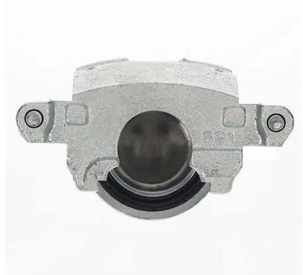

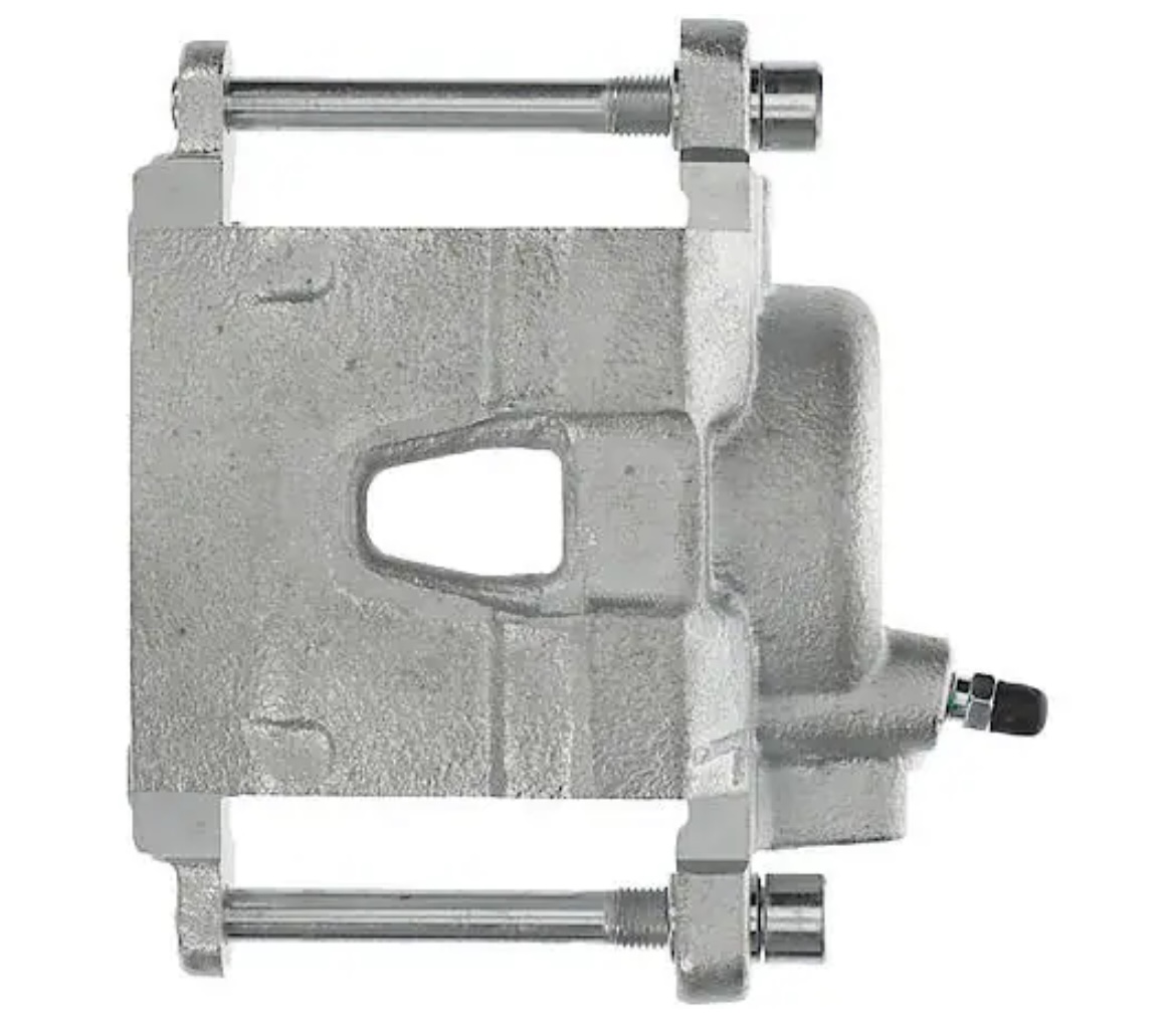

    These are known as “metric” calipers, they were used on GM intermediates starting in 1978.
    IMG_0420.jpeg IMG_0419.jpeg IMG_0418.jpeg You might want to google metric low drag calipers, those require a different master cylinder.
