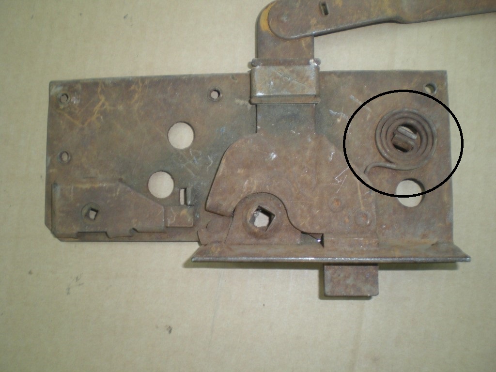

  13. RICH B
    Joined: Feb 7, 2007
    Posts: 6,036
    RICH B
    This spring.
    38Chevy454 and Petejoe like this.

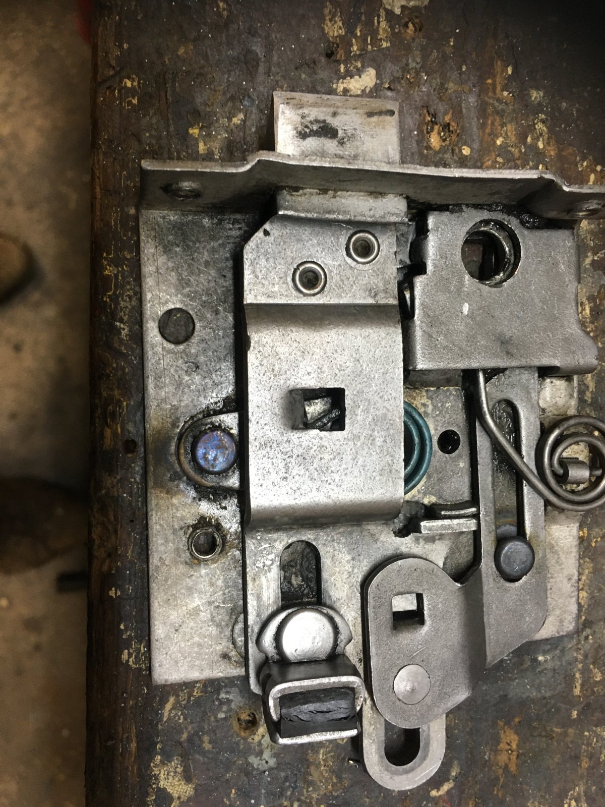

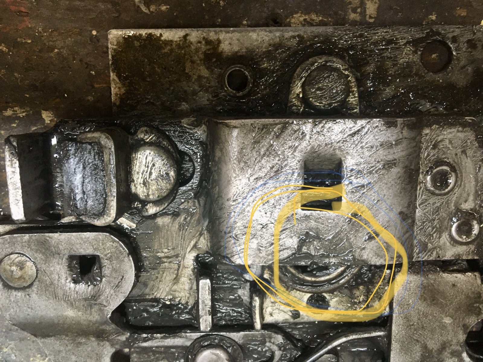

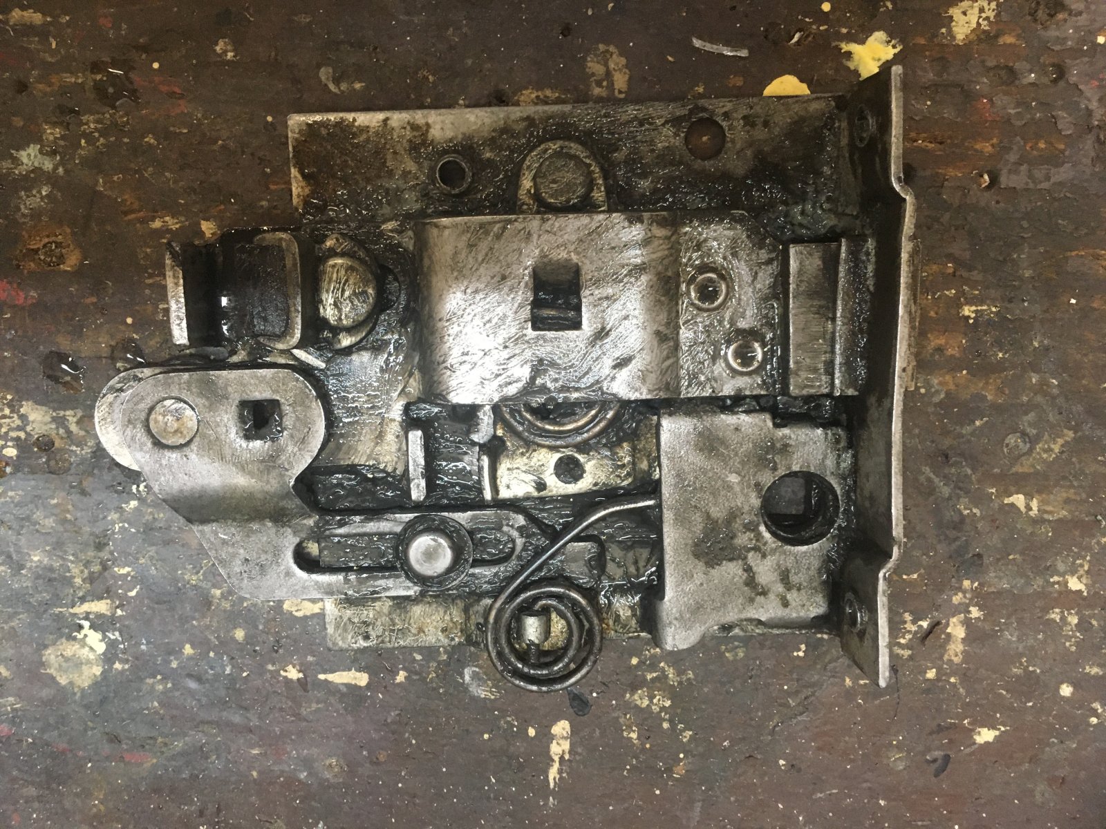

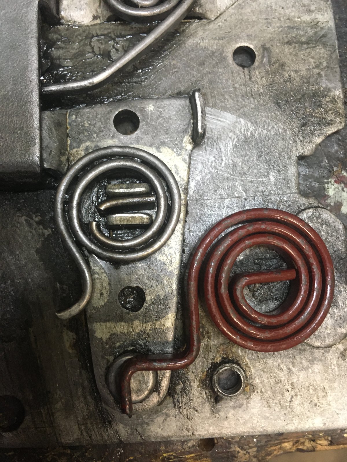

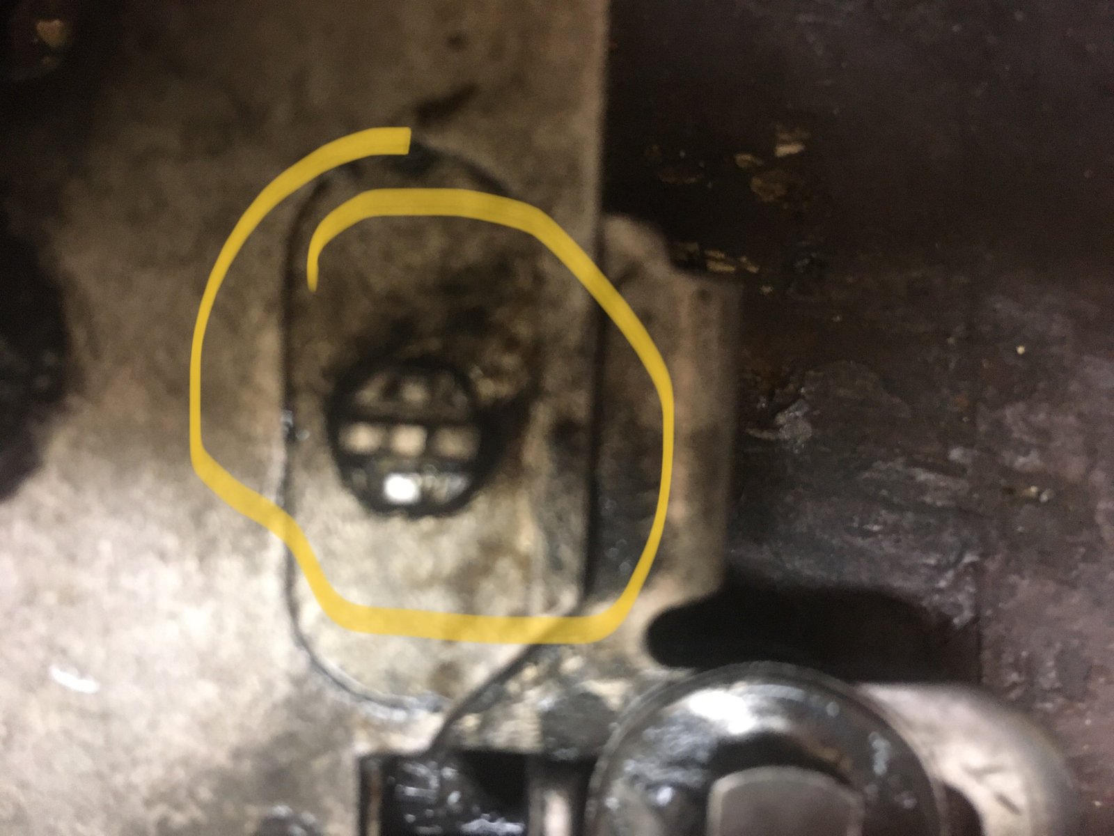

    1BA41DED-ADD6-4B8E-BCFE-863929F25EDE.jpeg 1D01E30B-3B8C-457C-963B-92CC82766F93.jpeg 9733142B-D27D-4940-A8A1-BE20CBB5408B.jpeg Finally removed my latch and while it’s soaking in some degreaser. I have a few questions…..
    It appears the spring behind this latch is broken. Correct??
    Next how do I access that spring with everything pinned in place?
    Do I grind off the pinned backside??
    See pics and video.

    It appears as though there are actually two different springs in this ***embly. Correct??
    Has anyone had to replace the spring under that plate??
    Did you Grind off the swaged pins to access it?
  21. alchemy
    Joined: Sep 27, 2002
    Posts: 22,823
    alchemy
    I have never repaired that year, but yes it seems that removing the guide pin would allow you to lift the striker up and put the new spring in between there.
    Petejoe likes this.

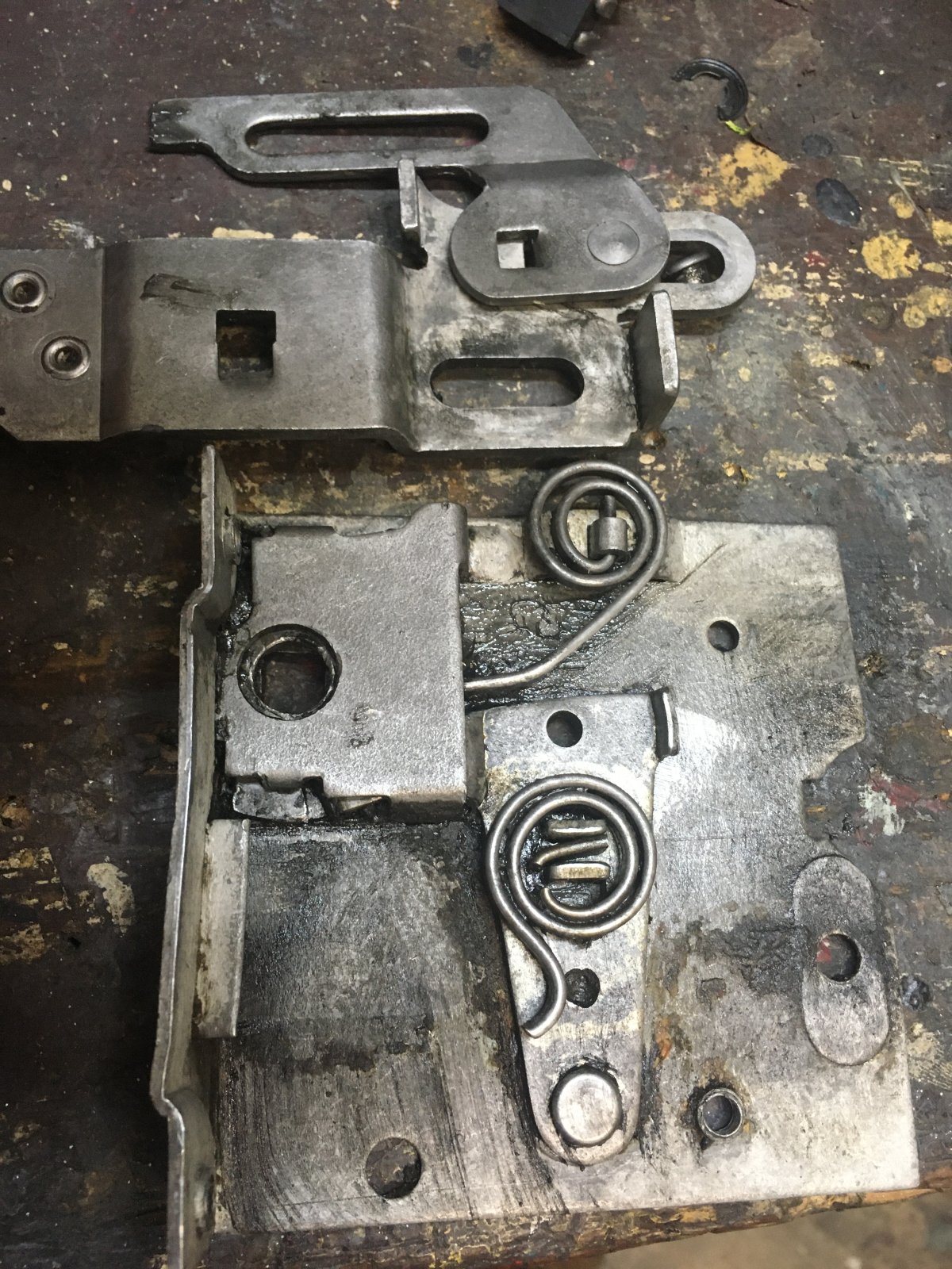

  22. Petejoe
    Joined: Nov 27, 2002
    Posts: 12,642
    Petejoe
    from Zoar, Ohio
    Well ****…..
    Yes removing the pins got me to the hidden spring.
    Yes it was broken. But……
    The spring doesn’t match the one I ordered for this car. :(
    Now I’m onto a search to find one.

    I may try heating and bending the new one but I’ve noticed it also has extra spring tension with three loops instead of two.
    TIG weld the broken tab????
    Being a spring material I wonder how long it would last????

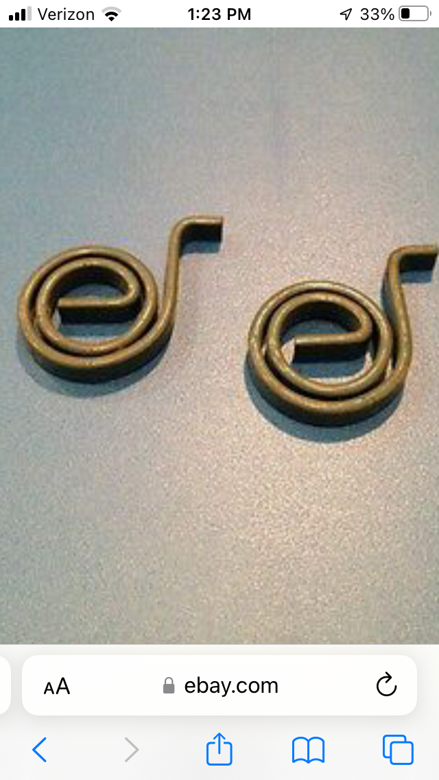

  24. Petejoe
    Posts: 12,642
    Petejoe
    from Zoar, Ohio
    I believe I found two here. :)
    eBay…. Free shipping.
    I may just live to be 90 with a working door and no bungee cords.
    warbird1 and Joe Blow like this.

    Your latch looks like a '38-'40 latch vs a '37 latch. Maybe that's why the spring didn't match.
  27. Petejoe
    Posts: 12,642
    Petejoe
    from Zoar, Ohio

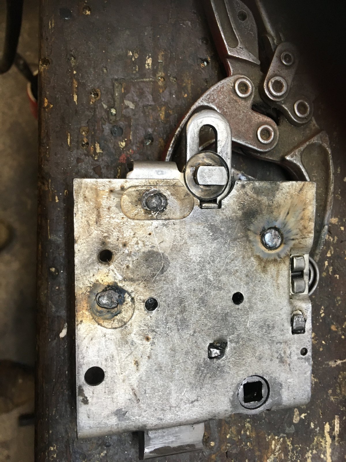

    746D97FD-D0D5-46AB-BCD8-CACDF583D414.jpeg CB41F0F9-2EF6-44C3-9945-CB41B4F32570.jpeg
    yes I believe your right Rich B.
    These replacement springs were marked 38-40. So now we know some of these latches are interchangeable.
    Here it is in action with two pics of the welded pins in back. Worked perfect. thanks everyone for your help.
    MAD MIKE and RICH B like this.
