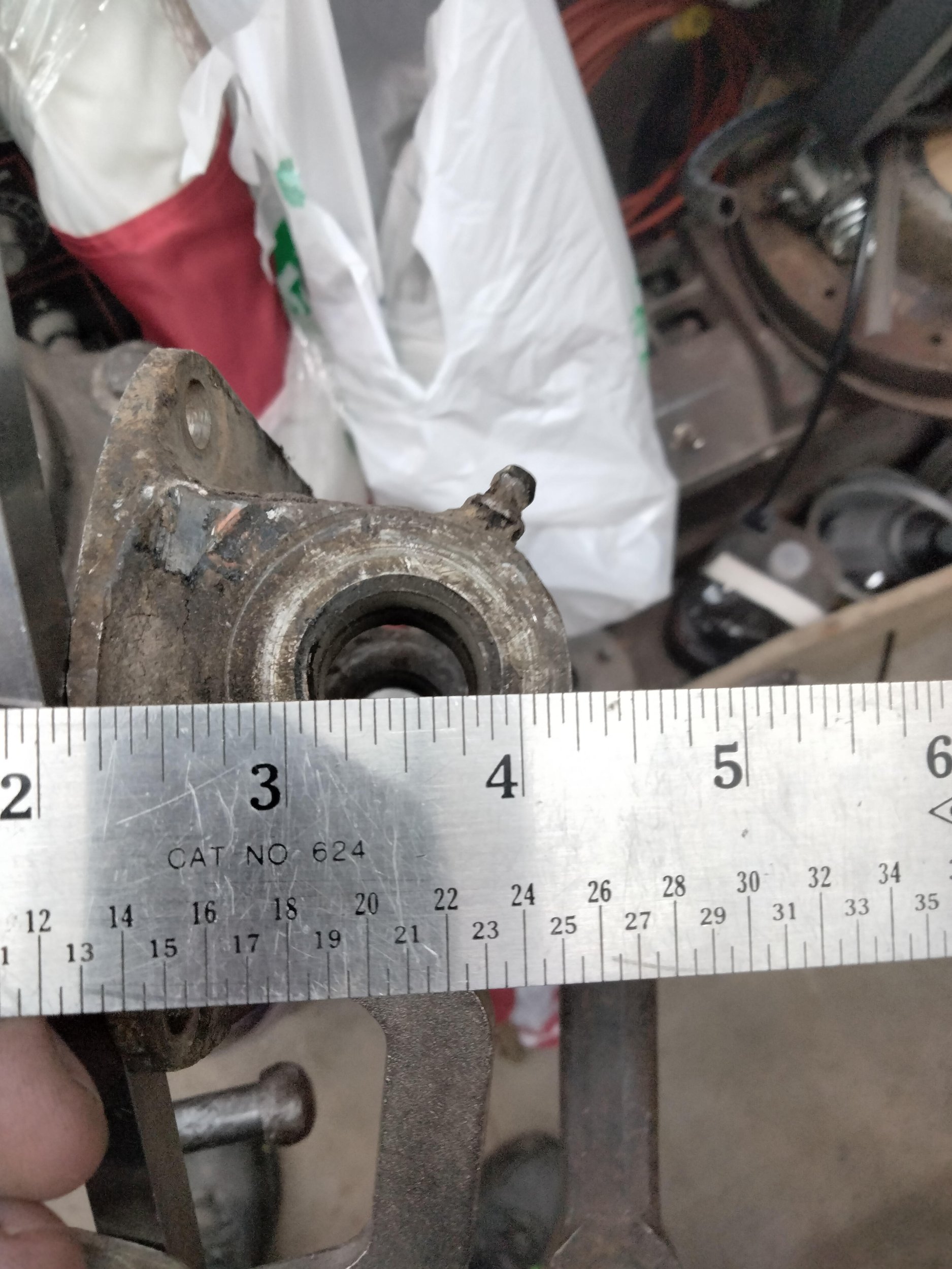

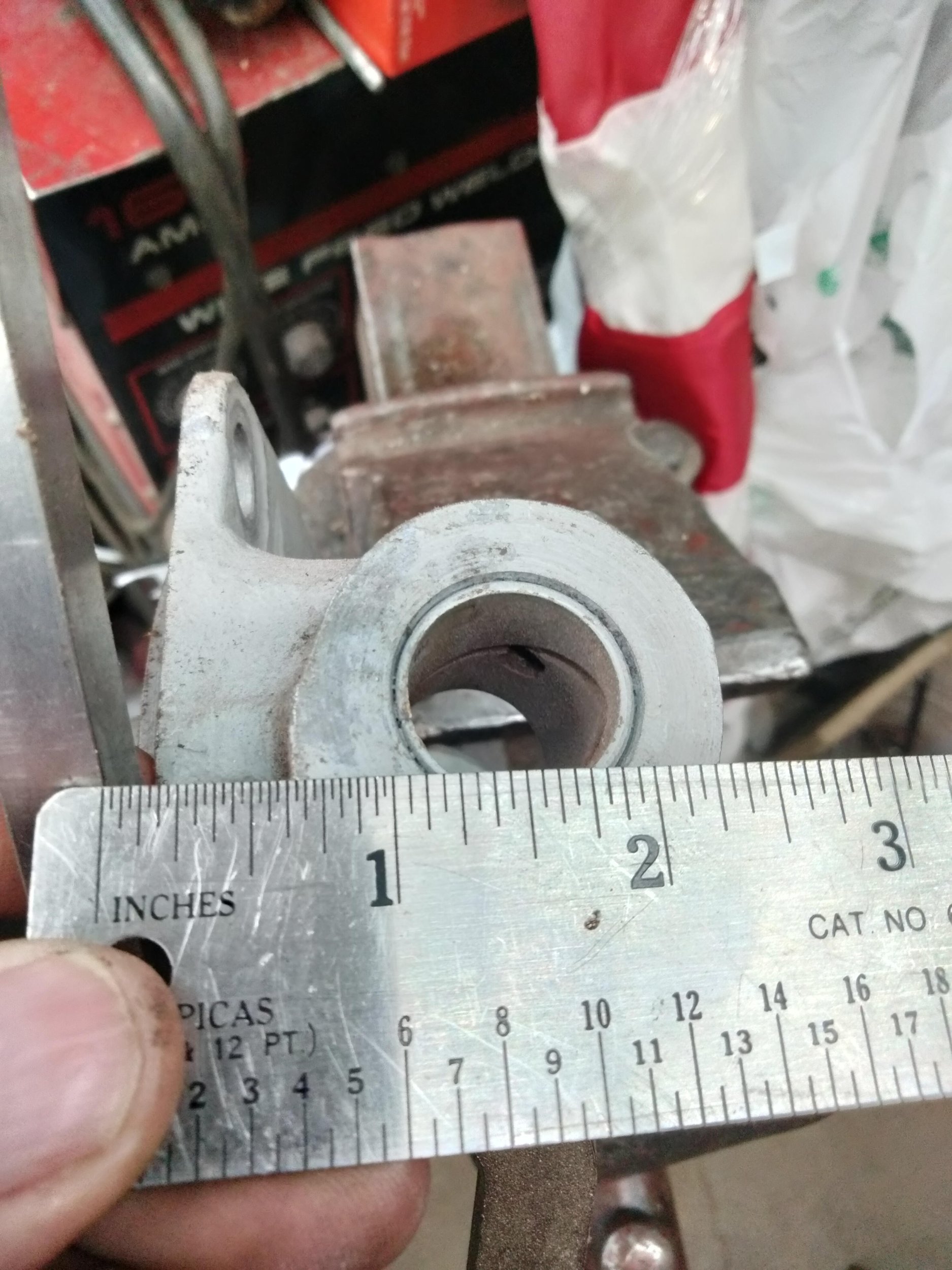

  7. I was moving some stuff around and grabbed another picture as you evidently don't have any of the stuff you are asking about to actually measure yourself.
    If you add 1-1/2" to 3-1/4" you get 4-3/4" from the kingpin center to WMS; then double that to 9-1/2" and add that to what ever width axle you have (or don't have yet) you will have your WMS-WMS dimension.
    Just in case; the 2nd picture is an early spindle which also measures 1-1/2".
