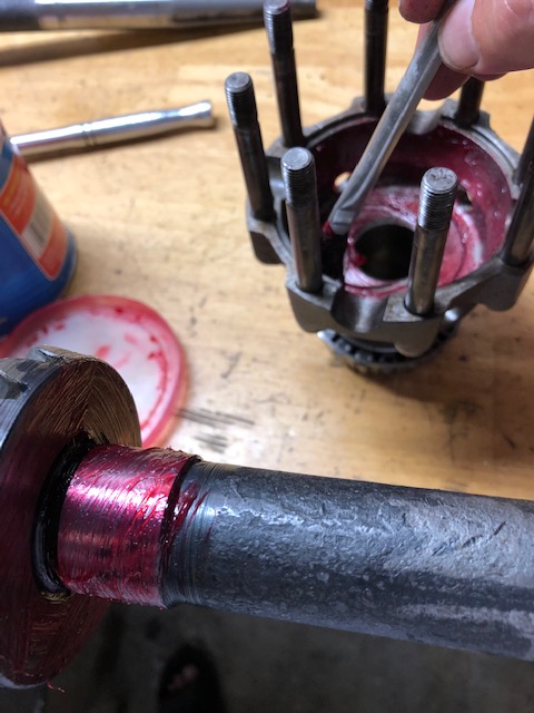

    Alright, time for the axle ***embly. The only hiccup I encountered was the fit between the driver's side axle and the ring gear. The axle goes through the ring gear in the area circled in red in the photo below and rides on the area of the axle circled in red. The fit was a bit tight, so I found a socket that was the right size, wrapped some 500 grit sandpaper around it, and honed the opening in the ring gear ever so slightly. That did the trick.
    I got all my internal parts cleaned up and spread out ready for ***embly.

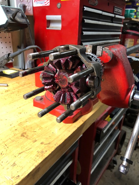

    I greased up the p***enger side axle and the p***enger side of the differential carrier....
    And slid the p***enger carrier half onto the p***enger axle. I then clamped the axle down in a vise to hold it steady when the rest was ***embled.
    Some more grease on the axle teeth and the spider gears...
    Then I fit the spider gears into the p***enger side carrier half.
    I greased up the driver's side carrier half and installed it the same way it came off. Note the punch marks on each half (circled in yellow), which were made during dis***embly. An important step I am told...

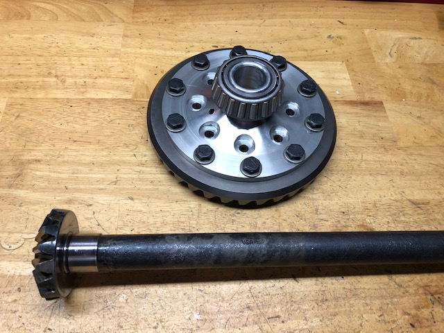

    The last remaining parts are the driver's side axle and the ring gear ***embly.
    Those got greased up and went together nice and smoothly thanks to the quick hone job.
    Then that whole ***embly can be bolted to the p***enger side ***embly that is secured in the vice.
    Threw some washers on, applied some loc***e, and torqued them down.
    That's it for the axle ***embly. Next post will be ***embling the housings and shimming the quick change gears.

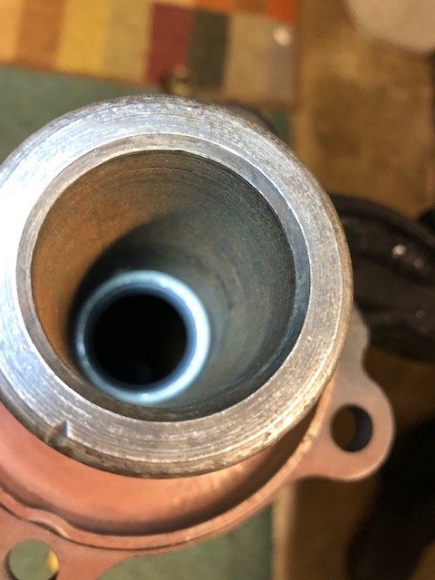

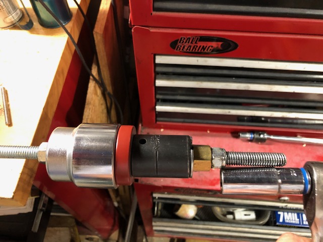

    Before final ***embly, I finally installed the axle seals. These are the seals at the ends of the banjo housings and they can be tricky to get seated correctly. I used a 3 foot length of allthread and a few sockets to build a little tool to press them in.
    The spacing is very important here. You can see my socket held up to the end of the allthread to check to make sure I will be able to dis***emble everything once it is pressed/pulled into place. The big socket on the right presses the red seal into place when pulled in with a nut on the end of the allthread shown in a few steps below. The black socket centers the ***embly nicely in the axle housing end. The allthread needs to stick out far enough to get on nut on it with a strong enough spacer (I used another socket) to take the load.
    The ***embly gets inserted in the axle housing. I did this with the axle standing up and elevated from the ground, but you can do this with it laying horizontal on the ground too. Probably would have been easier :rolleyes:
    If you measured correctly, you'll have some allthread sticking out the end of the housing.
    I then placed an appropriately sized socket over the allthread and tightened a nut to pull the seal into the housing. The vice grips on the other end ensure the allthread won't rotate.
    The axle seal is nicely in place without any damage. The picture makes it look uncentered but it is in fact centered perfectly.

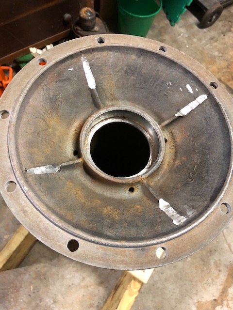

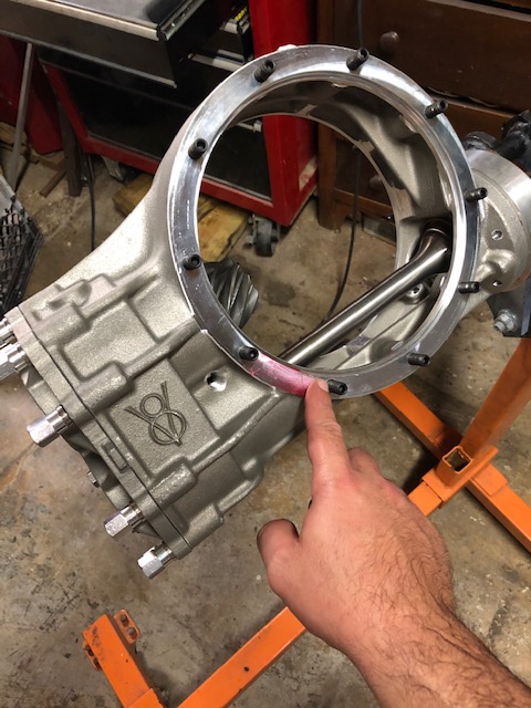

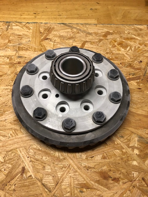

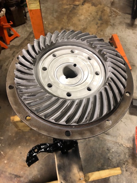

    The next step was prepping the center section. I changed my mind a bunch of times deciding whether to use studs and lock nuts (which came with the kit), studs and acorn nuts, or bolts to fasten the housings to the center section. I ended up deciding on studs and acorn nuts. That meant I needed shorter studs than what came with the kit. I got some set screws for the job. There are two holes on each side of the center section that go all the way through, so I used sealant on those to prevent any leaks.
    This next part is really where the engine stand comes in handy. I rotated the center section so that the p***enger side is facing up. Again, I decided against using any sealant and just greased the mating surfaces lightly.
    I installed the gaskets/shims for the p***enger side based on the test fitting discussed above.
    I greased the axle housing mating surface...
    And then torqued down the acorn nuts in a star pattern. The instructions said 25 foot pounds if memory serves...
    Then the center section can be rotated on the engine stand and the axle ***embly can be inserted as shown.
    Repeat the same steps for the driver's side taking care to use the correct gaskets/shims and torque it down.
    Once I ***embled it for the final time, I rechecked the carrier bearing preload and the backlash. All was good. The last step is shimming the helical quick change gears, which I'll cover in the next post.

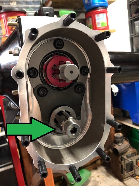

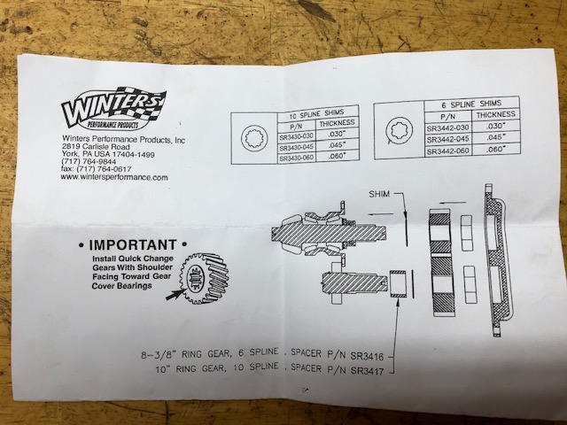

    Time to install the quick change gears and get them properly shimmed.
    When you opt for helical cut quick change gears, it is recommended that you use the shim kit to adjust the forward and aft play the gears have on their respective shafts. This is done with shims shown below.
    The shims come in .030, .045, and .060 thicknesses. The instructions that came with the set were straightforward, but did not address how exactly to measure the play.
    Before we start shimming, the spacer needs to be installed on the lower shaft. That's part number SR3417/SR3416 in the diagram above and shown in with the green arrow below. It's a tight fit so maybe heat it up a bit and be prepared to tap it home. A large socket or pipe is helpful here.
    I couldn't figure out the best way to measure for the right clearance. Bruce had a great suggestion, which was to over shim the gears, install the cover with the gasket (barely tightening down the cover) and use a feeler gauge to see how much gap you have. The first trick is getting the gap to be even from top and bottom. My clearances were slightly off when I used the same shims on both shafts. My top shaft needed a .060 and the bottom shaft needed a .045. That got me a uniform gap between the case and the cover. See the picture below of me using a feeler gauge.
    Some math is obviously involved here. If you have .025 of clearance between the case and the cover, you need to remove about .015 worth of shims. You are shooting for a clearance of .005 to .015.
    Once this setting is figured out, you can carefully torque down the cover and your quick change will be essentially all done. I still need to figure out how I will be venting mine, but for now, the project is complete. Hope this helped some of you get an overview of how this project goes. It was certainly a fun one and I am thrilled to have an early Ford style quick change rear set aside for my next project. Thanks for following along. And once again, thanks to @GearheadsQCE for selling a great product and providing even better technical support!
