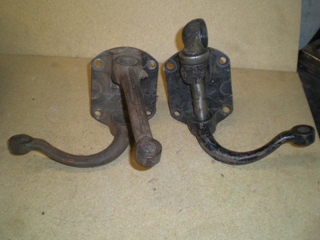

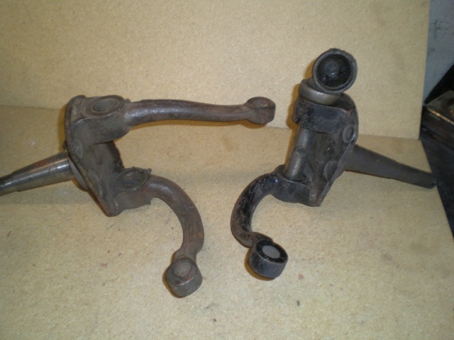

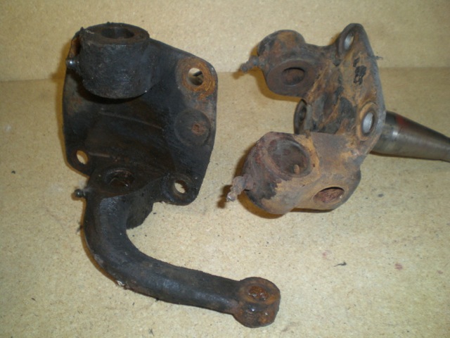

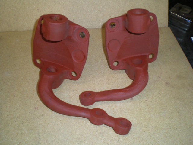

  7. Here are a couple of pictures of the various spindles discussed above.
    Model "A" easily recognized by bolt on steering arms and 3/8" backing plate mounting holes.
    '32-'34 are the only spindles to have an integral side steering arm, also the same 3/8" mounting bolts.
    '35 spindles have an eye for cross steering and the same 3/8" mounting bolts. '35 no longer had the steel grease "seal" as earlier spindles and included a area for a normal seal to ride.
    '36 is similar in appearance to a '35, except the spindle snout (bottom) is now shorter and the space between the tie rod eye and the drag link eye is longer as compared to the '35 in the above picture. The earlier upper spindle snout pictured has the bearing spacer used to fit later hubs for juice brake swaps
    '37-'41 round-back spindles have 1/2" backing plate mounting holes and the steering thrust bearing now goes on between the bottom of the axle and spindle instead of on top of the spindle as in earlier years.
    '42-'48 square back use a longer kingpin and bushings; but are otherwise functionally the same as round back spindles.
