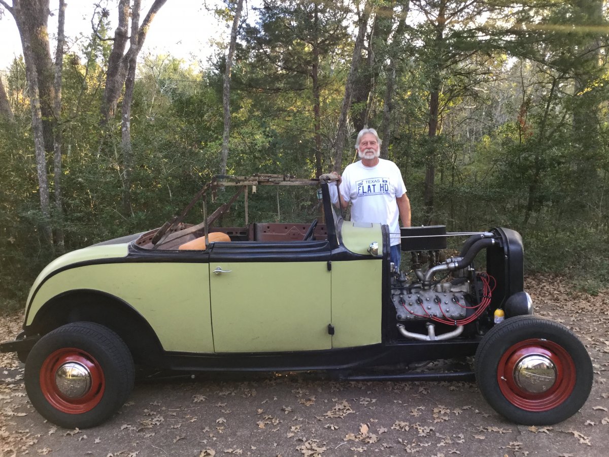

    CFCF15C7-488A-454B-A1EA-83AF3CD13EA8.jpeg They were marginal when new,now they are 80 years old and wore out. My “hot” flatheads used to tear up 2nd gear and cluster gear regularly. Back in the 70’s,bought an adapter from Offenhauser 5272a to put a Chevy 4 spd behind the strong flatheads and many power shifts later—-NO MORE PROBLEMS! Simply put—- if you want to run hard and fast—— leave the early Ford trans and banjo rear end to the restorers or to the 50’s wannabes. NUF SED! This 70 yr old man runs 80 mph in the 1/8 with my Henry 32 cabriolet and it damn sure ain’t no 39 Ford 3 spd trans.
