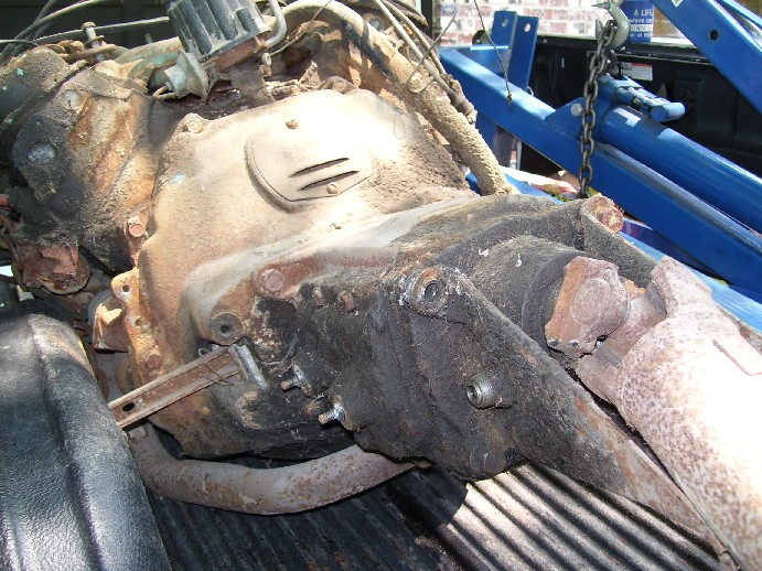

  11. How's about a 4spd toploader, I've just mated one to my nailhead by making an adaptor between the box and my transdapt adaptor which was originally designed to mate up to a chev box.. Damn strong box and when you add a T176 top out of a jeep the stick basically comes out where an original 3 spd ford one would.. ImageUploadedByH.A.M.B.1406437745.171627.jpg ImageUploadedByH.A.M.B.1406437800.518324.jpg
