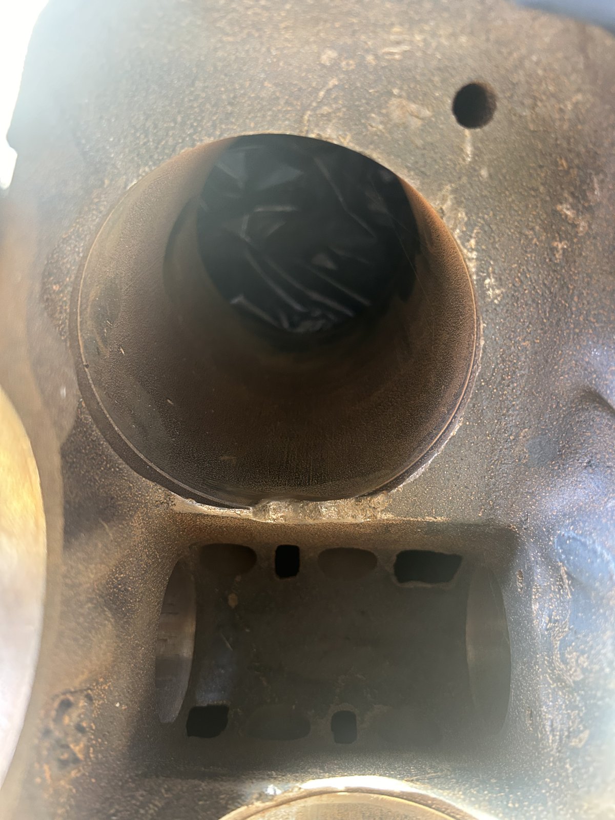

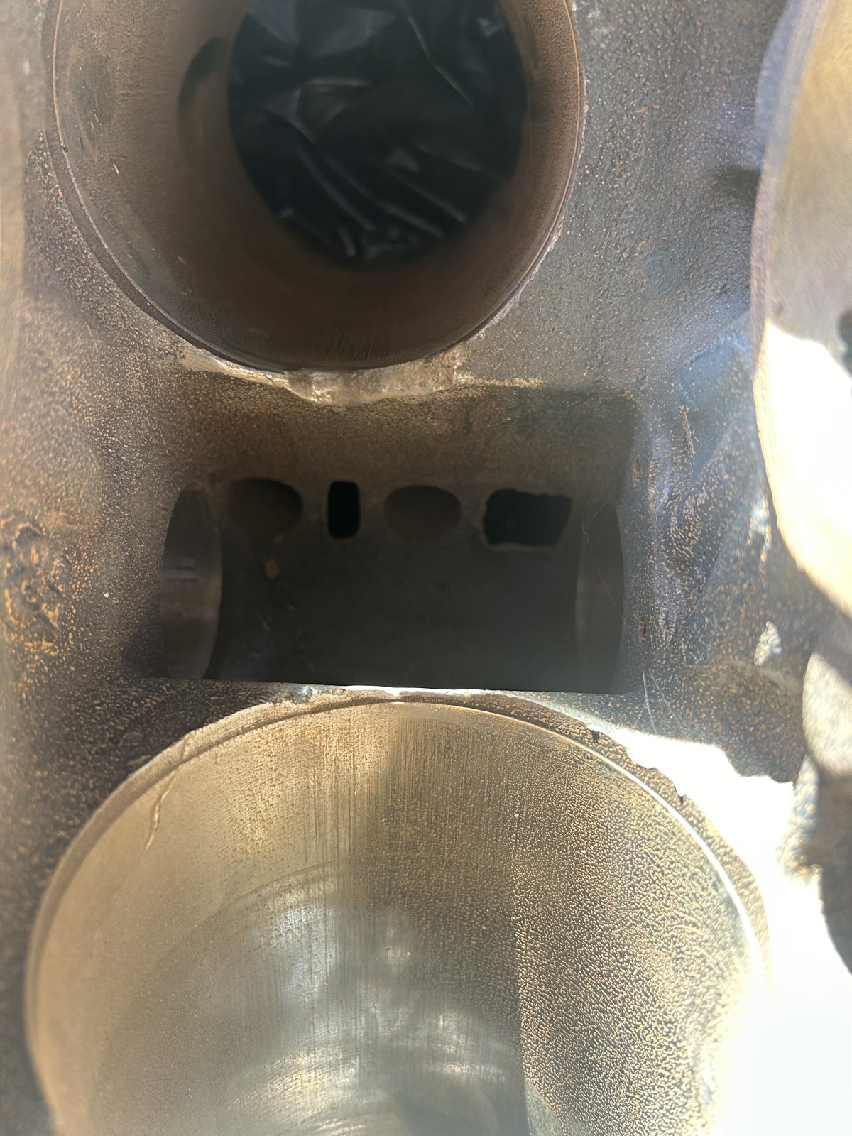

  10. 427 sleeper
    Joined: Mar 8, 2017
    Posts: 3,369
    427 sleeper
    Has that block been sleeved, or are the bottom of the bore's stepped, making it look like it has been? Just curious, not a big deal.
    Sharpone, mad mikey and Desoto291Hemi like this.
  11. 57 Fargo
    Joined: Jan 22, 2012
    Posts: 6,227
    57 Fargo
    No sleeves, I think what you are seeing is where the connecting rod beat the hell out of the bottom of the bore, “mushrooming” it so to speak

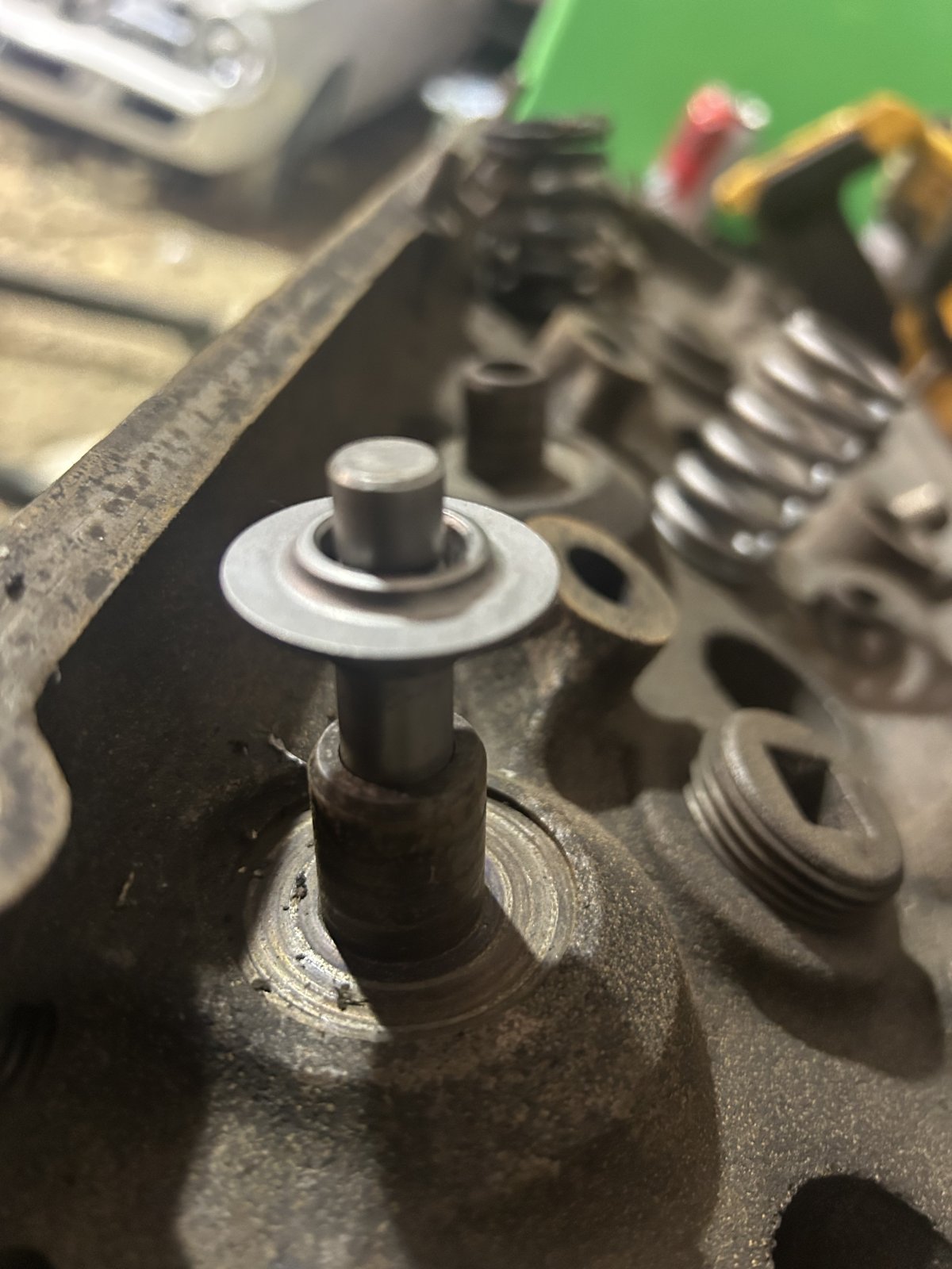

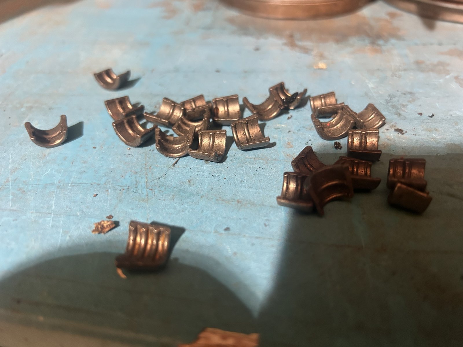

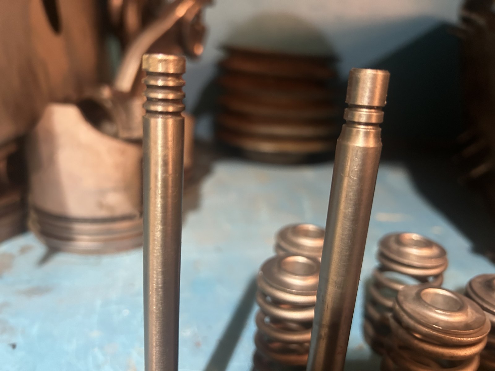

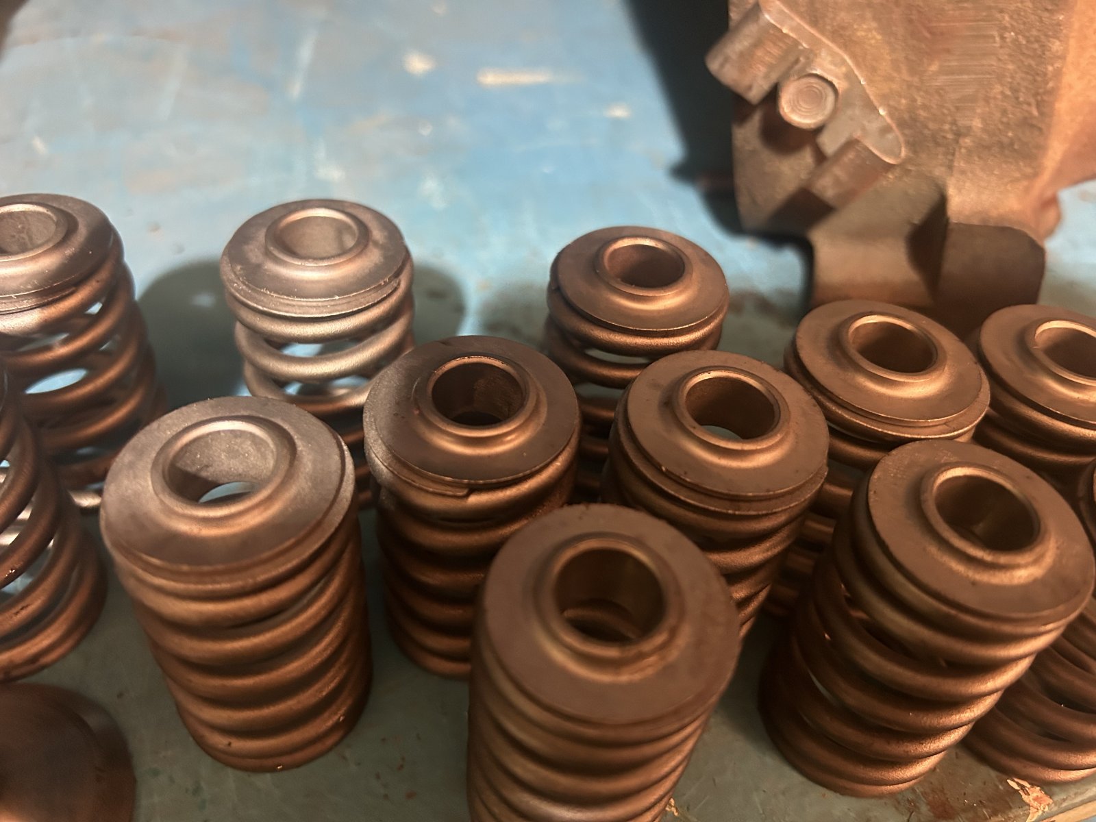

  17. 57 Fargo
    Posts: 6,227
    57 Fargo
    Here is what he gave me, I’m quite positive the retainers are not from this, I would seriously question the valve springs and there is only 15 of them…. IMG_5391.jpeg IMG_5392.jpeg IMG_5393.jpeg
  18. gimpyshotrods
    Joined: May 20, 2009
    Posts: 24,537
    gimpyshotrods
    I always opt for fresh springs rather than the unknown.
    That's a good place to spend not too much money.
    Sharpone, RodStRace, 73RR and 2 others like this.
  19. 57 Fargo
    Posts: 6,227
    57 Fargo
    I don’t disagree, if I had springs and they tested good I would hesitate but new isn’t that expensive.

  24. No,,,,Mopar blocks are factory back cut like that at the bottom of the bores .
    My DeSoto is just like it,,,,,except without the damage.
    I bored mine .020 and the relief is still fairly large ,,,,I’m sure it’s there for an important reason .
    Tommy
  25. 57 Fargo
    Posts: 6,227
    57 Fargo
    Now that I went back and looked at my own pictures.:rolleyes: I see what @427 sleeper was talking about. Thanks Tommy!

    Looks like you have the exhaust retainers, but only 15 total? Missing the intake or exhaust?
    There are other guys using truck heads...HEY GUYS, who has a spare exhaust retainer?

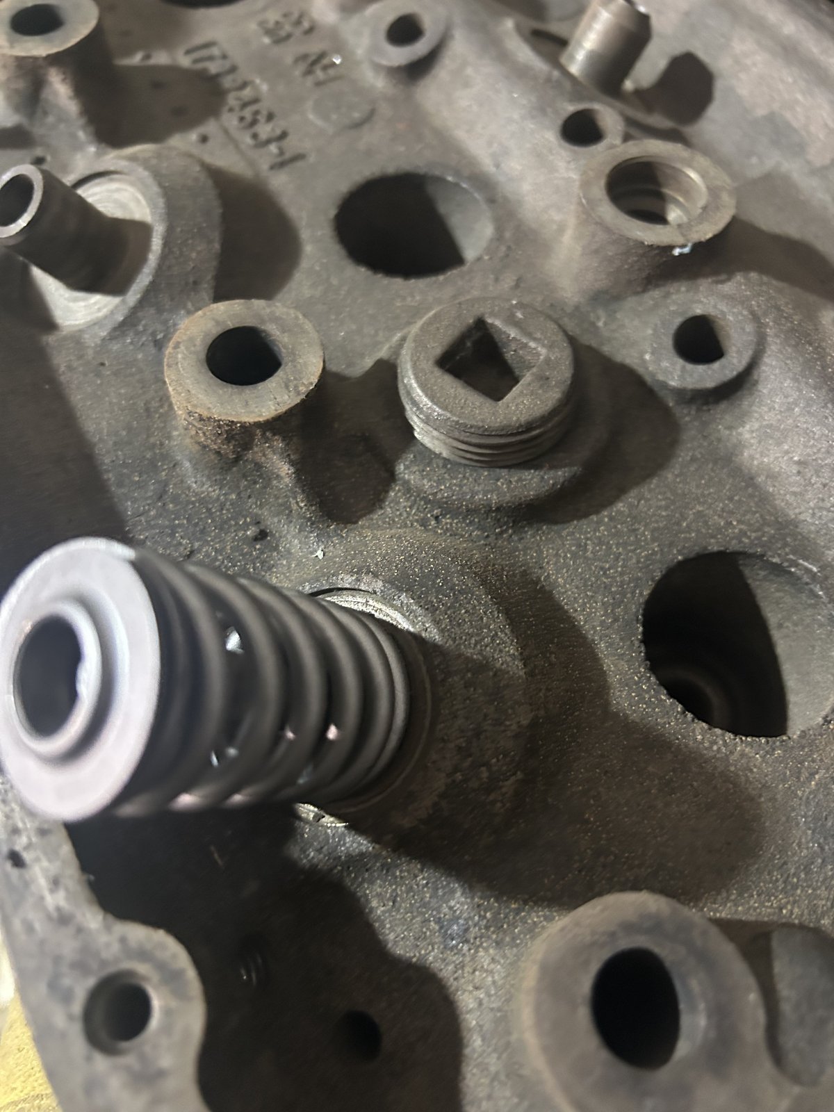

  27. 57 Fargo
    Posts: 6,227
    57 Fargo
    Gary I’m headed out to
    My shop to take a better look at what I have here!
  28. gimpyshotrods
    Posts: 24,537
    gimpyshotrods
    Someone has to have extra exhaust ones! The intakes are easy to swap for new ones, or other used ones.

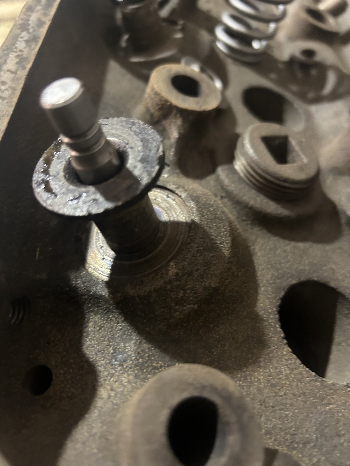

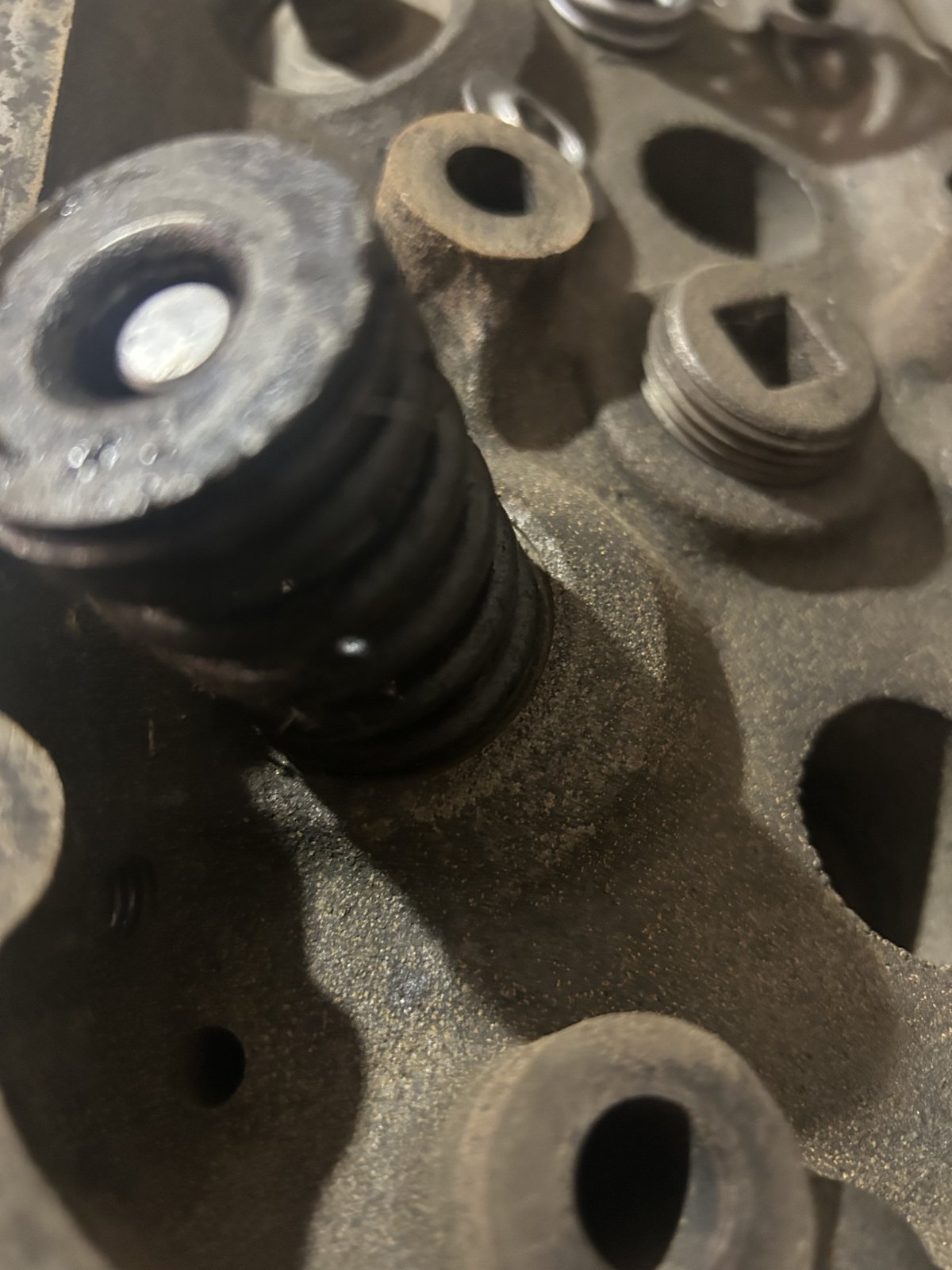

  29. 57 Fargo
    Posts: 6,227
    57 Fargo
    Upon closer inspection I think I have enough stuff here… @73RR so kindly told me that there are LA dodge valve springs that fit which I already happen to have a new set of. I also have plenty of LA retainers and keepers, I think I am actually set, let me know if you guys see something amiss here…first pics are the springs and retainers he gave me, clearly wrong now that I look. IMG_5398.jpeg IMG_5399.jpeg
    Second is old LA springs and retainers, I’ll verify installed height etc but should be fine I think.
  30. gimpyshotrods
    Posts: 24,537
    gimpyshotrods
    Right on!
