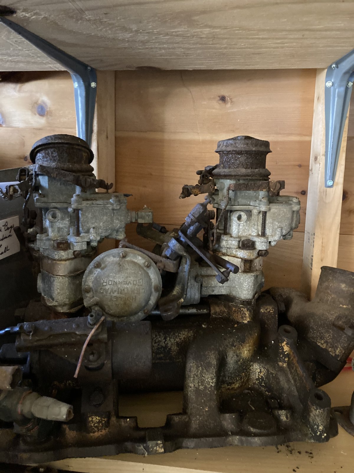

    At this point since I’m not building for big power this is, I think, my preferred intake, with two two barrels adapted, it would look killer. Eventually the 6-71 will find its way on but that is a long ways off happening
  12. George
    Joined: Jan 1, 2005
    Posts: 7,966
    George
    I mentioned on some Thread that there is/was(?) a Thread at Hemi.com where a guy used 1 bl to 2 bl adaptors to put two 2GC carbs on one of those. Last I heard his wife developed health problems & I don't think he ever finished the project.
    gimpyshotrods and 57 Fargo like this.

    Just a small clarification on an earlier post. The 2-pcs Marine intake has a large round carb mount that has enough room to bore out for the 2-bbl. The truck piece not so much as shown in the pics.
    bchctybob, gimpyshotrods and 57 Fargo like this.

  17. gimpyshotrods
    Joined: May 20, 2009
    Posts: 24,499
    gimpyshotrods
    If you can get the 2x1's, just run those.

    Hey, how about a couple 50mm Weber or Dellorto on top?
  21. 57 Fargo
    Joined: Jan 22, 2012
    Posts: 6,155
    57 Fargo
    Now that @73RR has explained the difference that’s exactly what I would do.
  22. gimpyshotrods
    Posts: 24,499
    gimpyshotrods
    That could work, too!
    If only we knew someone with a 5-axis CNC machine.
    73RR, 57 Fargo and Truckdoctor Andy like this.
