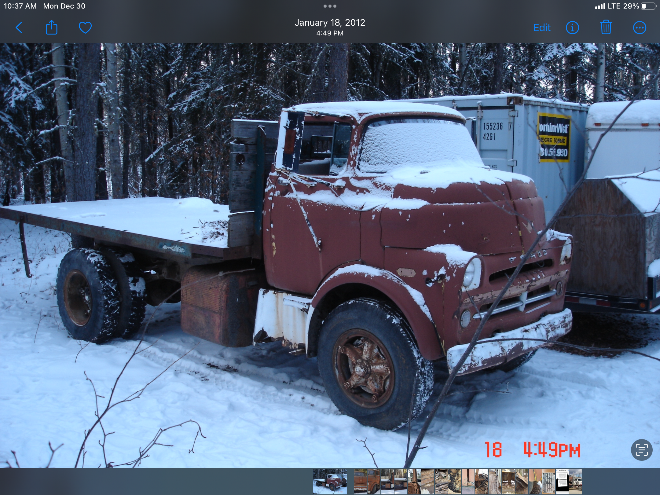

    113DEB38-31D5-4D25-8DE6-F4858CA22B19.png I think you need another 857 Fargo with 354 Hemi it’s in Ft Sask

  8. hemiracer
    Joined: May 26, 2015
    Posts: 9
    hemiracer
    I’ve owned for awhile, thought I would get at it , it’s complete in a storage yard. I race Bville with a 354 and thought I could use another. Don’t know condition of motor , never got that far.

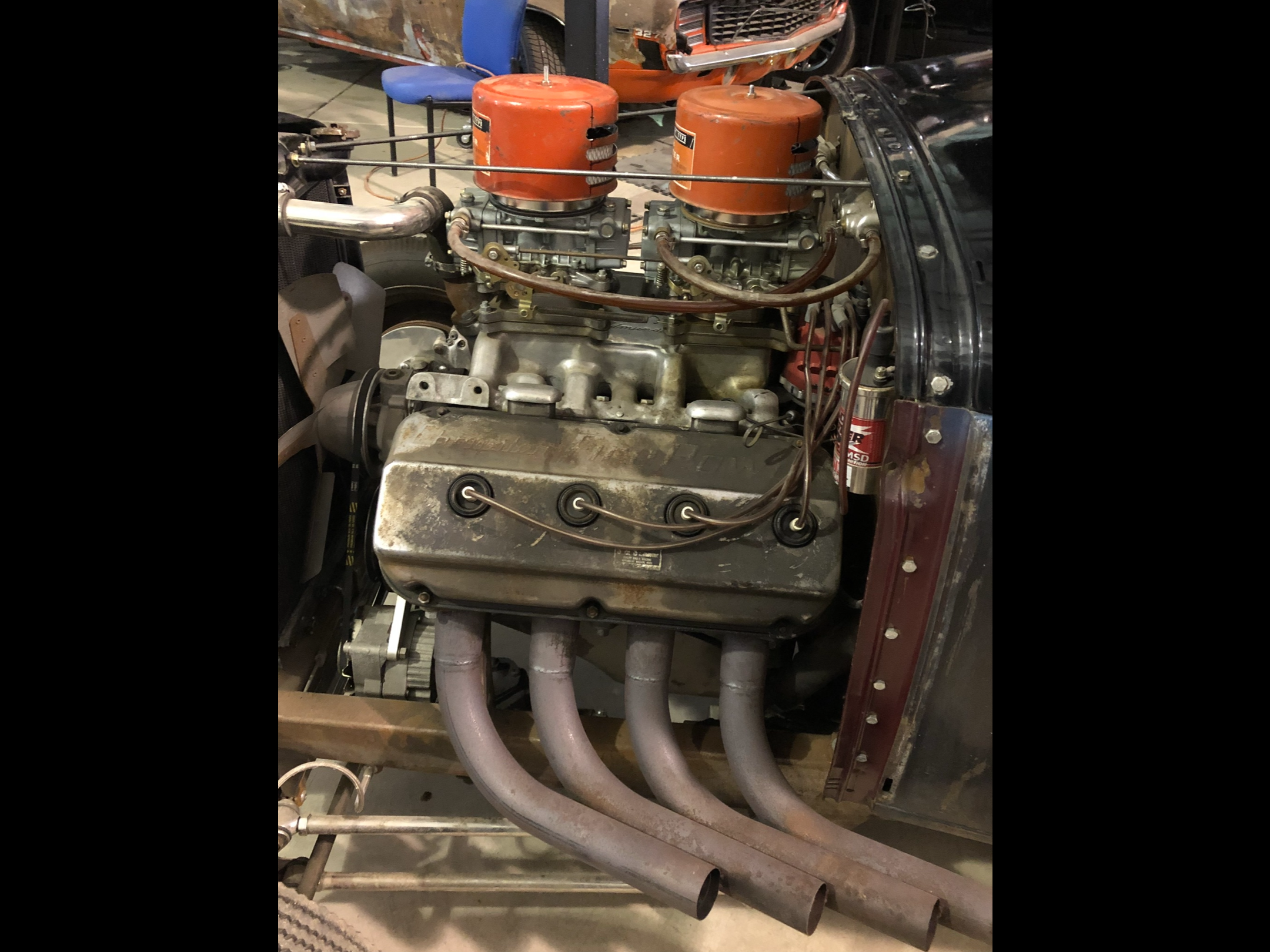

  13. silent rick
    Joined: Nov 7, 2002
    Posts: 5,685
    silent rick
    edmunds 2x2 on my red ram
    slayer, bostonhemi, AndersF and 3 others like this.

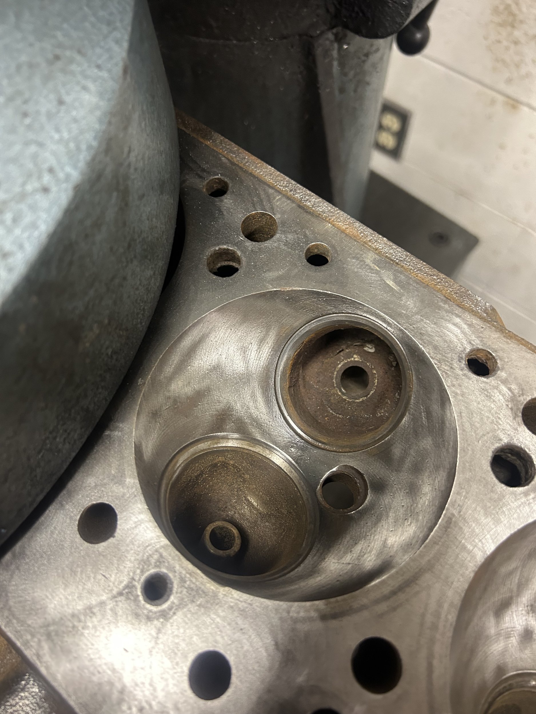

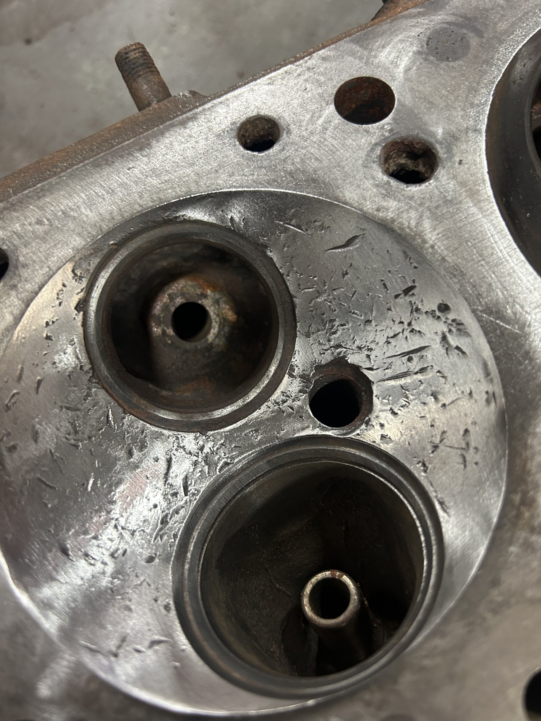

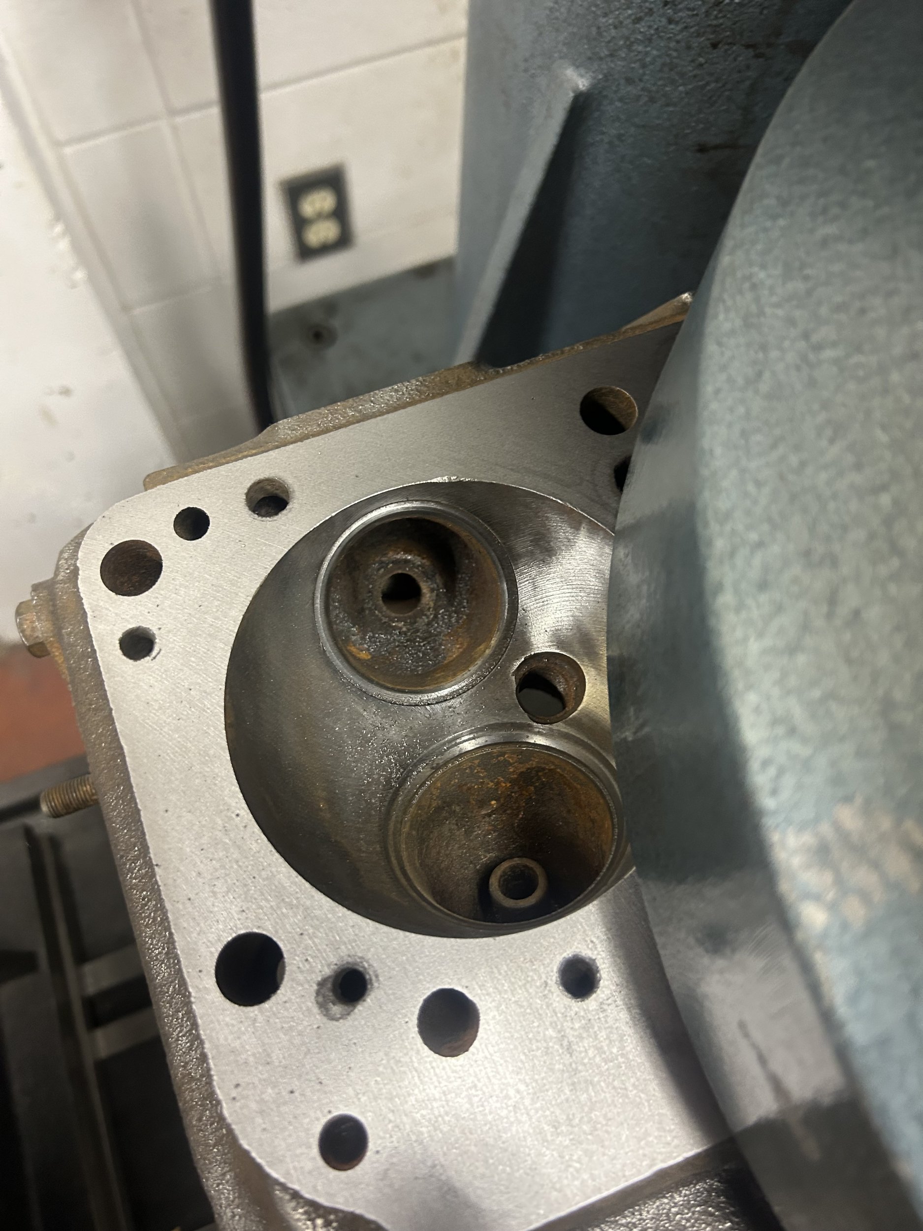

  15. 57 Fargo
    Joined: Jan 22, 2012
    Posts: 6,228
    57 Fargo
    Well these heads are determined to fight me, all was going well, until it wasn’t. IMG_5835.jpeg IMG_5837.jpeg IMG_5836.jpeg
    Got the first head set up in the surfacer, took 0.003” off and it cleaned up nicely, decided to take one more cut and at the very end of the head the table moved and a cutter caught the head and made a decent mess. I think it would probably be ok but I didn’t bother to take any pictures of it as I left in disgust with myself. Also broke two cutters so need to replace those as well. Not a good day.
    The table on the surfacer just rides on rollers, I think I moved it to far to the one side and it kicked the end up. Rookie mistake

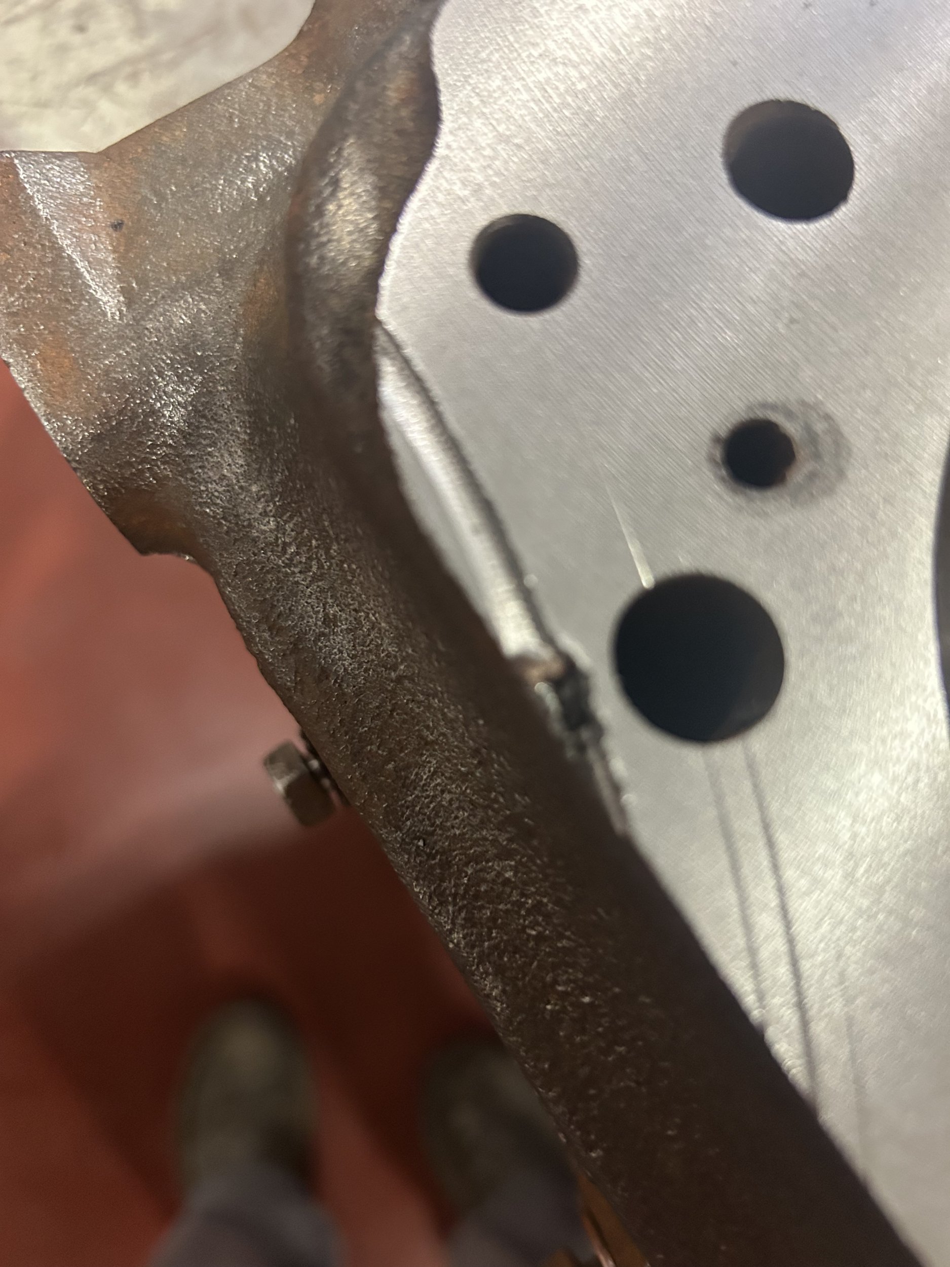

    Posts: 6,228
    57 Fargo
    IMG_5840.jpeg Yesterdays whoops. I think there is probably enough there to still seal fine…
    bchctybob and Truckdoctor Andy like this.
  23. 57 Fargo
    Posts: 6,228
    57 Fargo
    Sometimes i really wonder about my intelligence….thats a head bolt hole its fine.

  25. 57 Fargo
    Posts: 6,228
    57 Fargo
    Oh like away, I was too mad yesterday to look, the chunk missing at the end is by a head bolt hole. It will be perfectly fine, once I replace all the cutters on our surfacer I’ll skim a thou or two off to get rid of the other scratches.

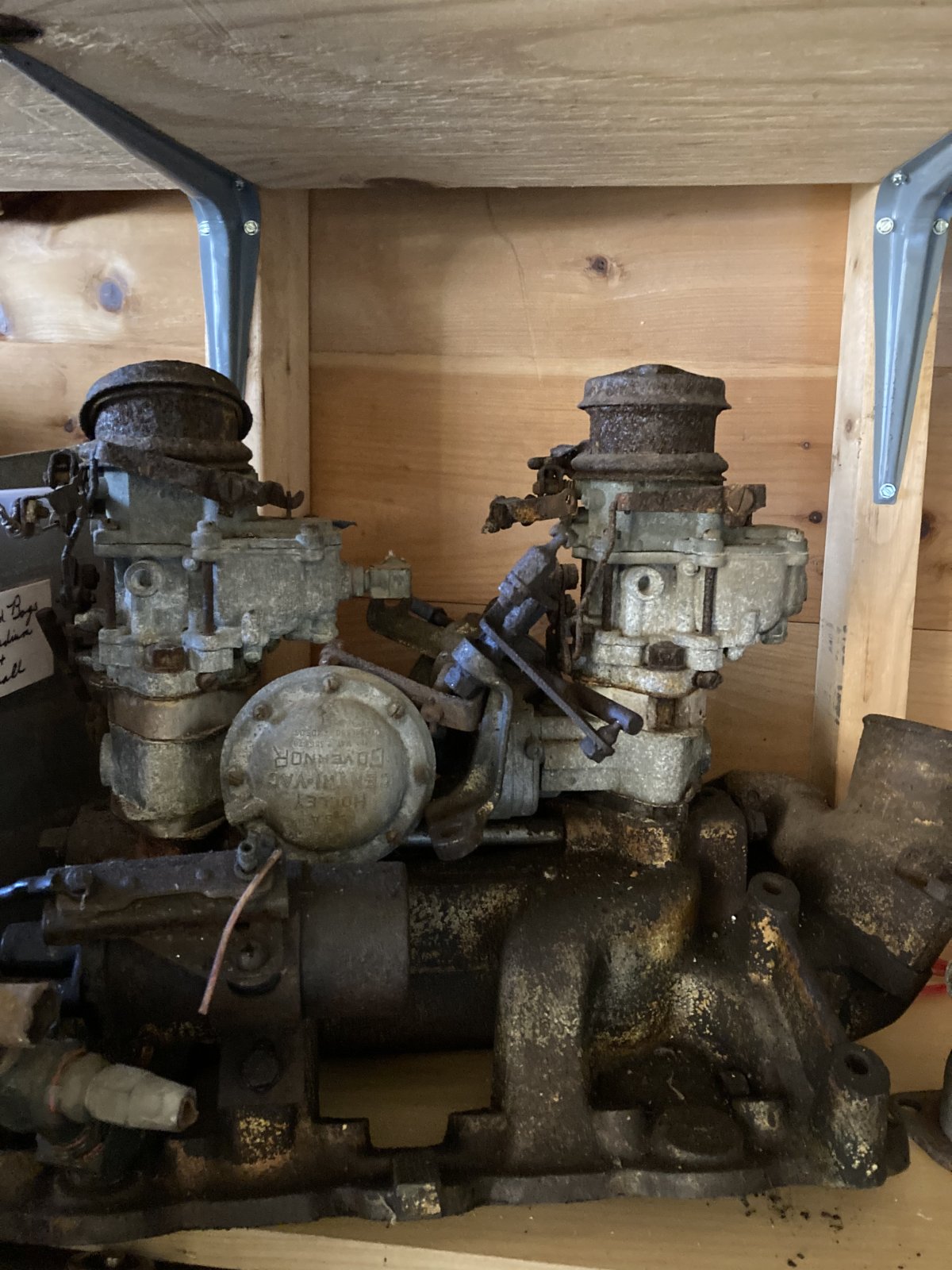

  26. Beanscoot
    Joined: May 14, 2008
    Posts: 3,681
    Beanscoot

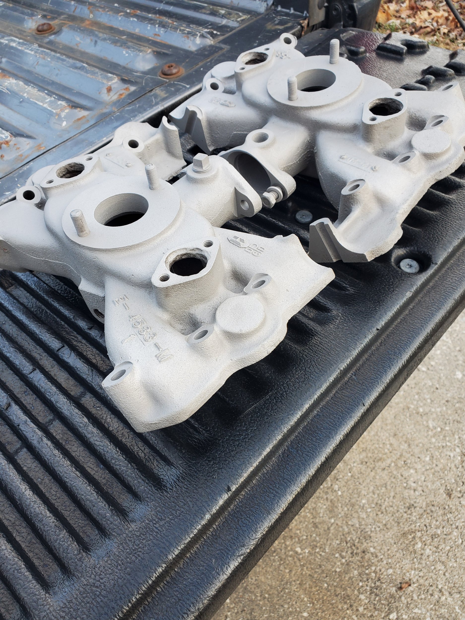

    The truck 2 x 1 intake with weird carbs would be pretty cool, cleaned up:
    It would also fit (cover) the tall water ports in the head.

    Yours?
  28. George
    Joined: Jan 1, 2005
    Posts: 7,995
    George
    Om thehemi.com a guy started putting two 2GC carbs on one of those using 1 to 2 bl adaptors, his wife got sick & never posted if he ever finished the project.

  29. gimpyshotrods
    Joined: May 20, 2009
    Posts: 24,543
    gimpyshotrods
    JB weld, not JB Quick.
    Fill up the grooves, and the shave it flat with a utility knife blade.
    It will seal just fine. No need to cut it more.
  30. 57 Fargo
    Posts: 6,228
    57 Fargo
    Oh yeah it would be fine, they look worse in the picture than they are. I bet 0.001” cleans it up. Just pisses me off.
