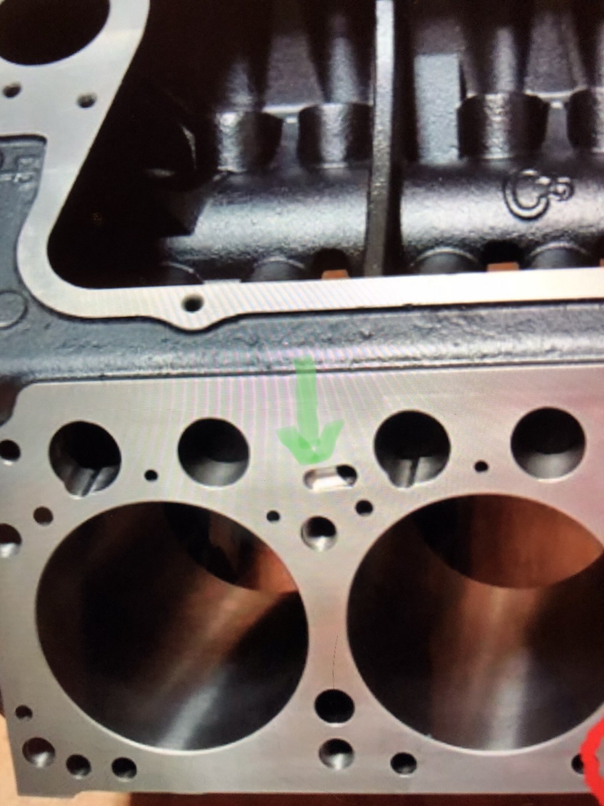

    I am going to be helping my dad replace head gaskets on his 1956 Hemi. I know the head bolts need sealer but, Do all of the holes go into water jackets? As far as I could tell by using a small pick in the block, there is only one bolt that is open to water. See the picture.....I circled in red the bolt hole I believe to need the sealer on the bolt. Please correct me if I am mistaken.
    Also, same question with the valve cover holes. They call for sealer but, the only holes that seem to go into a water jacket is the ones I circled in red. Again, Please correct me if I am wrong. I only want to do this once. Thank you.

  3. It’s usually easy to see what holes are blind or not .
    Don’t sweat it,,,,,,sealer is really only needed on water holes .
    Whatever makes you happy .
    I think some always did it for overkill,,,,just in case .
    But,,,make certain they are blind,,,,,and not just some sludge built up in there .
    That’s a fine looking block in that pic,,,,I’m ***uming it’s just a pic from the internet ?

    Yes, both are just pics found online.
  6. Country Joe ,,,,,I’ve always liked your avatar pic,,,,he was a great character actor !
    Something caught my eye on the block pic you posted,,,,,,the oil feed for the rockers is offset .
    I wonder if this was a factory defect or some early version of a oil restriction?
    Look at the slot below the green arrow,,,,,,all the blocks I have ever seen had the oil feed directly in line with the feed hole in the heads ,,,,,,,curious .
    Also,,,,it has reinforced ribs in the lifter valley ,,,,I’ve never seen this in an iron block .
    Does anyone know anything about this ?
    Tommy
    Country Joe likes this.

    That block looks like the New 392 block Gene Adams was developing a few years back. sseing that picture makes me wonder about what happened with that project.
  8. Well,,,,it’s one of the cleanest looking iron castings I have ever seen .
    You must be right,,,,,,I’ve never seen factory markings in that quan***y.
    I guess he was wanting to add some extra meat in some areas ?
    Tommy

    The three suport ribs in the lifter valley are not in any Chrysler block I've ever seen.
    Desoto291Hemi likes this.

    It also lacks the catalog stamping at the front of the valley cover pad as well as the DPCD stamping by the distributor hole.

    I sure wouldn't count on what is going on with an aftermarket block.

    The lack of stamping on the front of the block was common on industrial engines. I have a 354 industrial with nothing stamped on the front.
